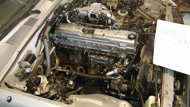

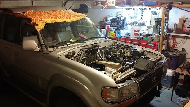

So at this point I'm waiting for parts, scraping head gasket off the block & general cleaning. There is lots to do still like pull off the oil cooler, install water pump & lower hoses. I did get help from a neighbor to get the hood off WOW! That made a big difference. I'm really looking forward to getting this back together I can see the light at the end of the tunnel now. Here some pics.

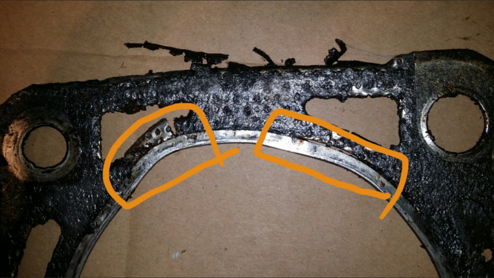

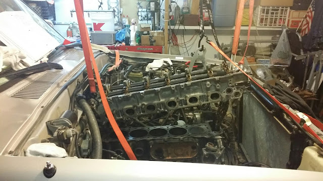

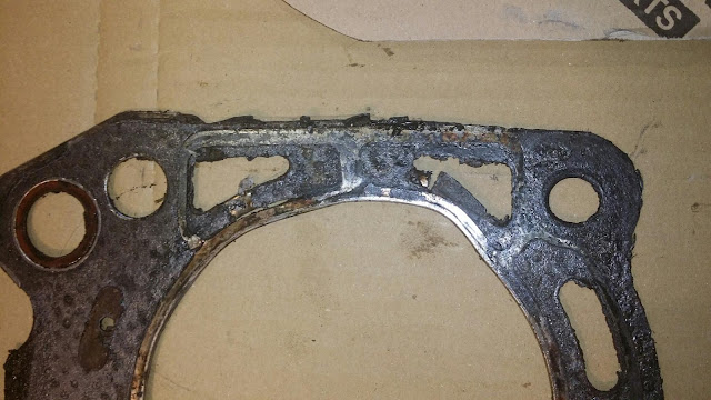

Now that I have the HG off you can see better where the failure is... actually both rear water ports faild.

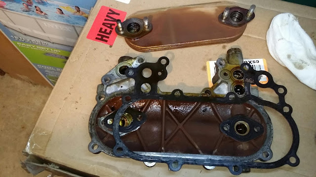

I also got the oil cooler off. Not bad for 18 years of service.

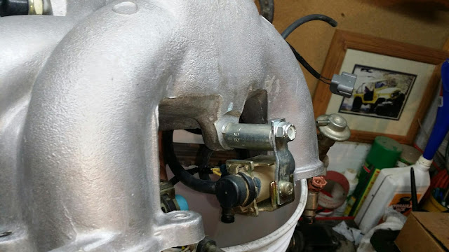

One more thing I did was relocate the VSV.

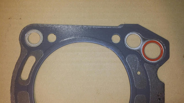

Old vs. New upgraded head gasket.
All the parts came in yesterday Wednesday the 3rd of June. The head gasket is a thing of beauty. It is upgrade & reinforced all over, more so in the rear where most failures happen. This thing will be ready for another 100,000 more miles. Here is a couple of pics...

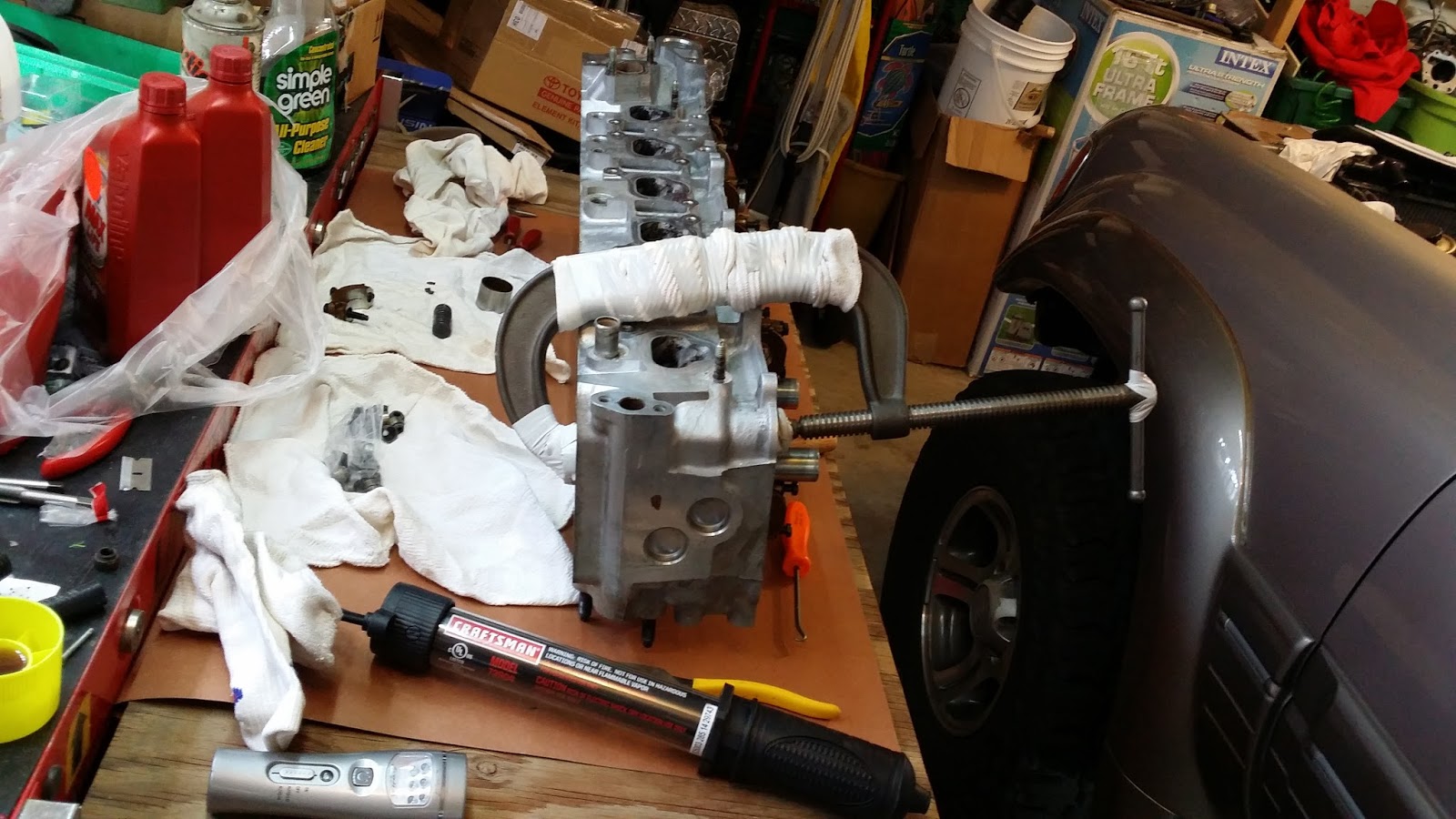

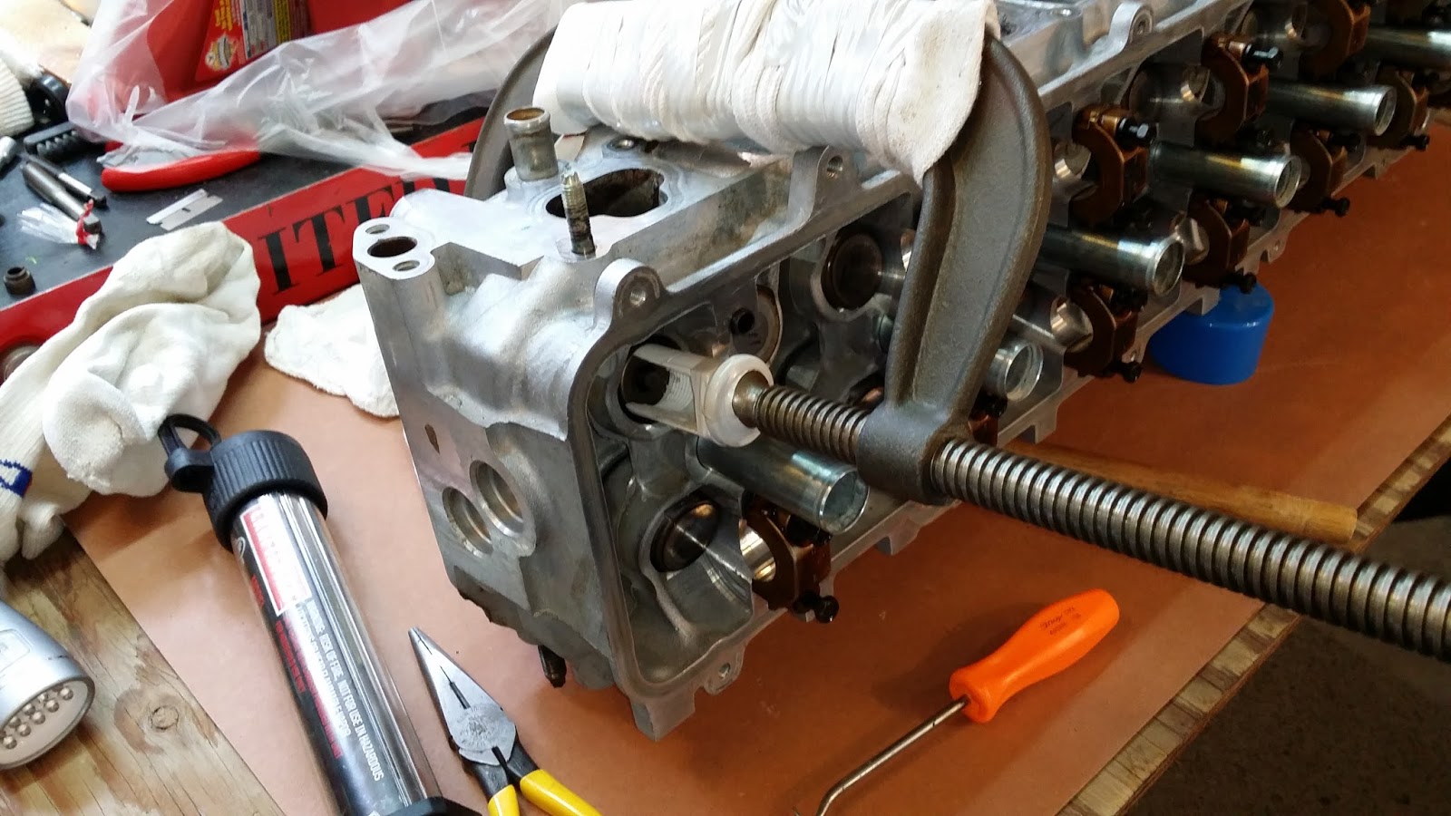

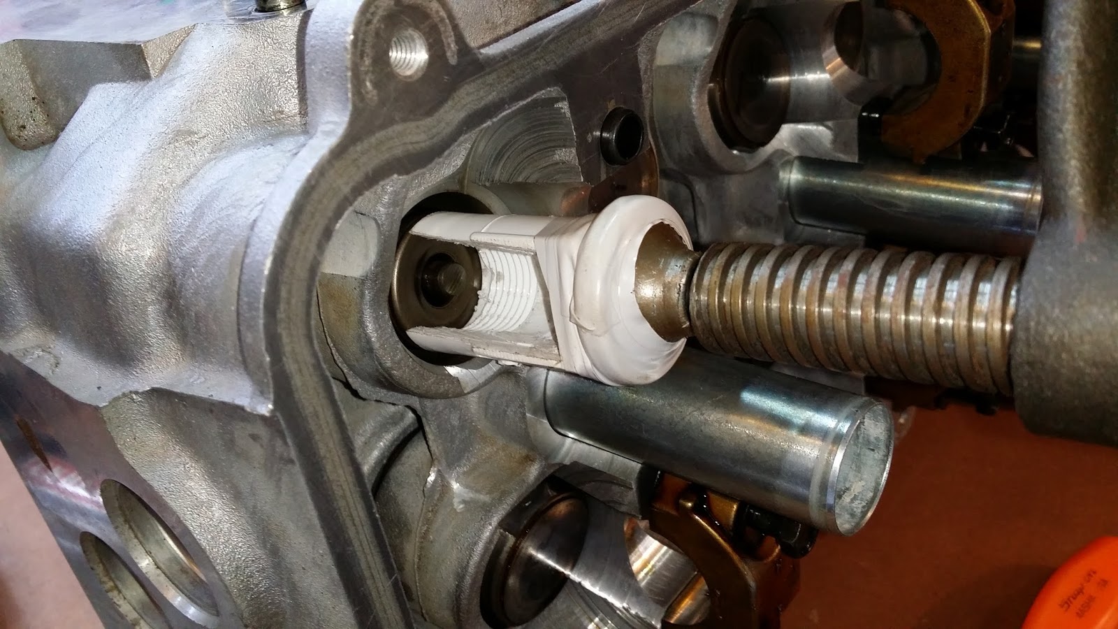

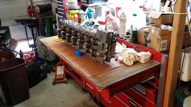

Today I have been installing new valve stem seals & doing a general inspection of guides & valves. It's a slow process. I didn't have the tool to remove the valve spring clips & no time to order one so the Lord gave me the witty idea of making it out of a pvc 1/2" coupling. Hopefully tomorrow I will be installing & torqing the head. Things will go much faster after that.

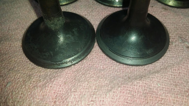

I am no super mechanic here, I just want to make this clear. I'm just doing the best I can here with what I got. To be very honest I'm quite overwhelmed with all this. This is my DD not a extra hobbie rig. I'm just blessed with a history of high school & college shop classes and I just like sharing my story with you.
In my last post I was replacing valve stem seals which went fairly well with the intake side. I spun them around a bunch of times to clean the seats up. When I started the exhaust side it was a different story. From what I learned in shop over 25 years ago I need to lap them with that gritty stuff. I did my first one & I'm happy with the outcome.
Head completed & ready for install at 2 a.m.

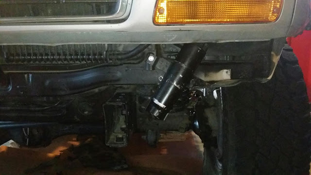

A/C dryer relocation mod.
I took a quick break from the head gasket replacment & twisted the A/C dryer over to get it out of harmes way.

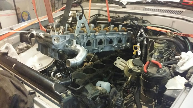

Finally, installed HG & torqued head.
Well the day finally came when the new head gasket went on & head was torqued. This was the apex event of the whole project. I definitely can now see light at the end of the tunnel now. It's all down hill from here.

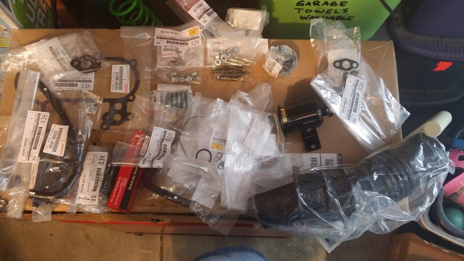

These are my extra parts that I don't know what they are? The ones on left are for heat like the exhaust gaskets. What is a TWC?
I answered about the gaskets via text, but just saw the question about the TWC. It stands for Three Way Catalyst, and is basically saying that your catalytic converter is designed to deal with 3 polluting gasses; Hydrocarbon (HC), Carbon Monoxide (CO), & Oxides of Nitrogen (NOX). The older cats only dealt with the first two and were called Oxidating Catalysts (OC on the emissions label).
