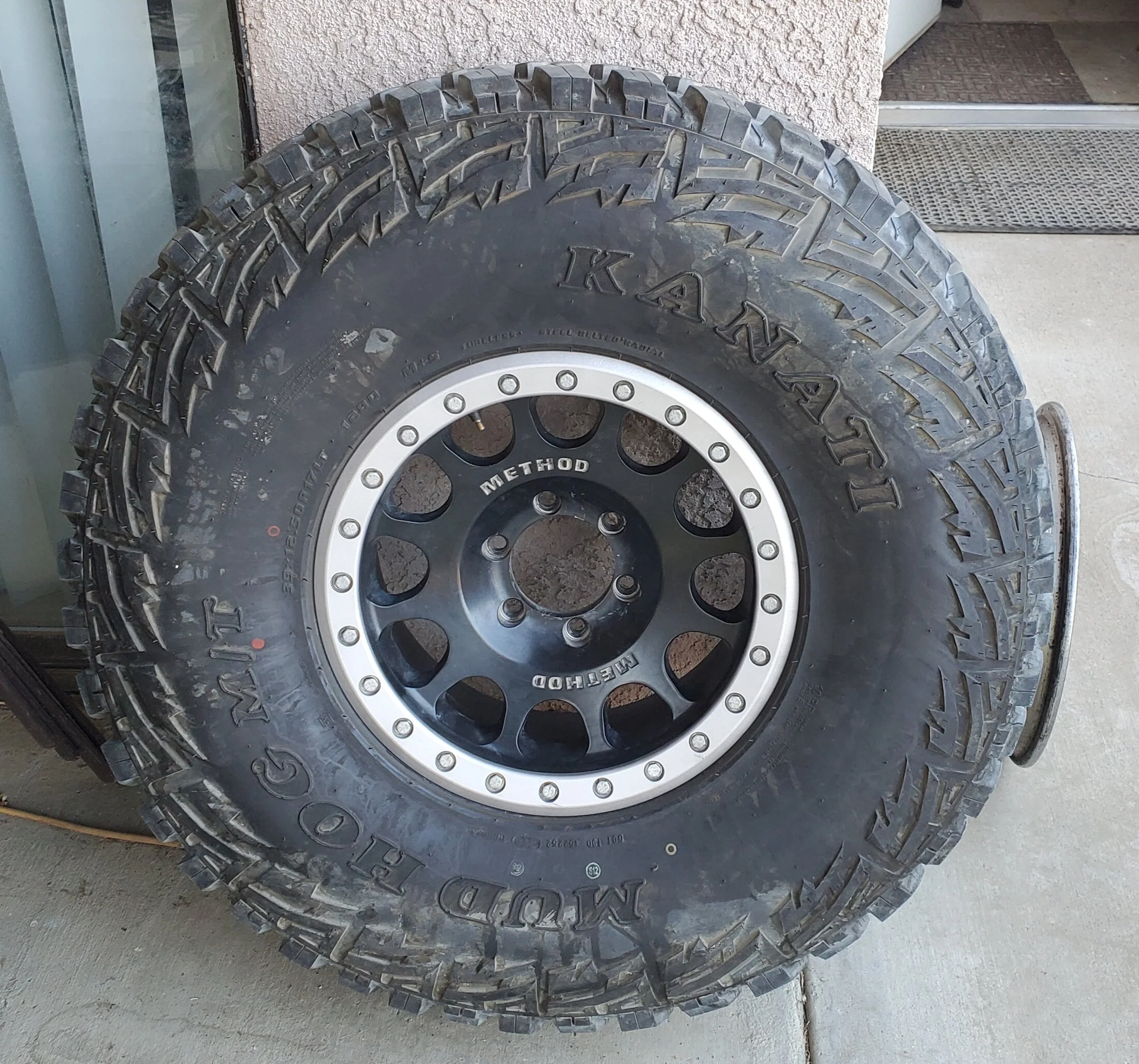

I didn't realize it till I put one on my spare they are the 17x8.5 4.75" BS version 105s.
My bad. I should have measured when I picked them up.
The tread will sit same as stock 16" wheels, that's too close to inner fenders in rear & the 39s will rub the front control arms & exhaust pipe.
So I need to decide to run these with 1.5" spacers to sit same as my 17x9 3.5" BS or sell them.
I'm seriously bummed. The whole point of the purchase was to get away from spacers.

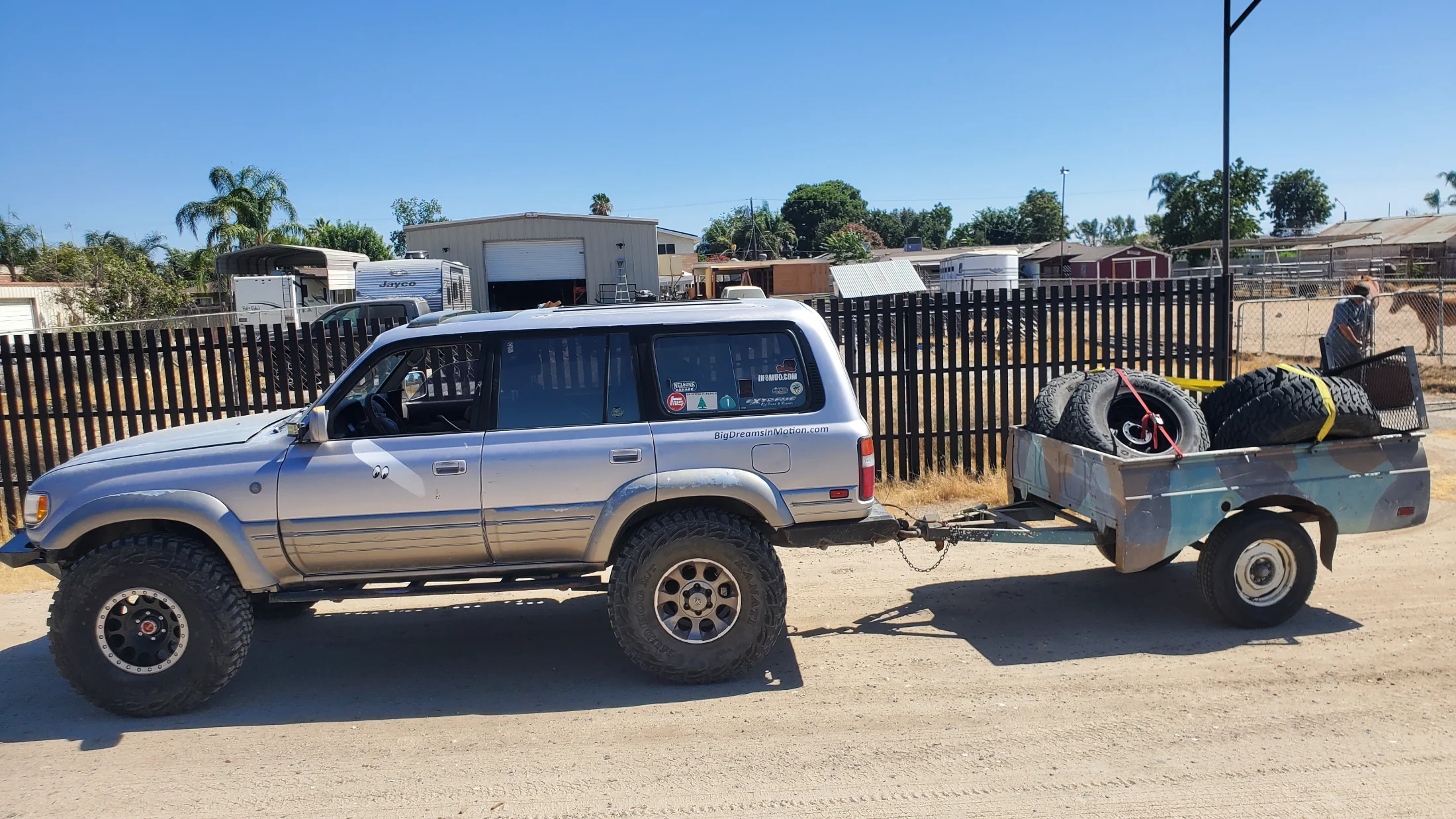

Been doing a few things..
Sold my 37s with the steel Battleborn beadlocks.
Bought a realy cool 1976 FORD Courier truckbed trailer.
Ive needed a open bed to haul things with...Im moving to a better house in August.
I'll have a better work space.
I put on one of the 4.75" BS Methods with a spacer.
There are a set of Method 105 17x9 3.5' BS on FaceBook Market place, hopeing to get those...
Damn, that front wheel/tire combo brings the fun!
