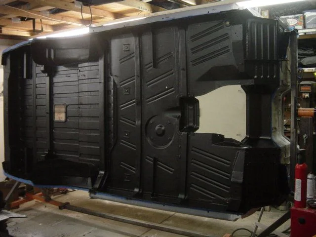

one more pic......
Great work! Looks better than new!
Do you have to top coat the Zerorust, or is it OK to leave as the finish coat?

thanks guys, I am using some cavity wax type of stuff, HD anti rust from eastwood, it is great stuff, has an oily/waxy film left, I used it in the rockers and plan to use it up on the roof line and in the back corners once I get all the panels on. I also plan to use it on the lower part of the doors and tailgate. Also in the rear channel. I actually popped holes in the rockers underneath and in teh back channel, and foudn some nice plugs from eastwood to go there. This way I can drain and reapply the cavity wax in the future with littel effort.
