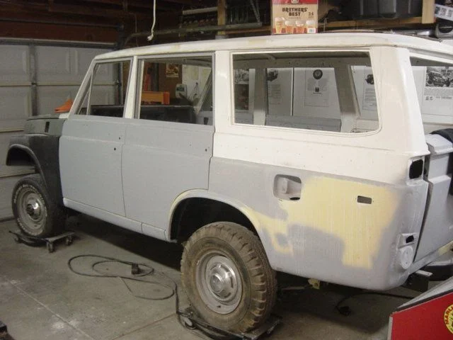

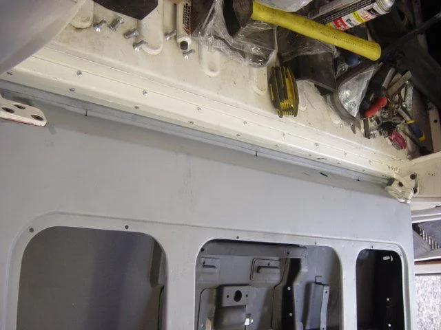

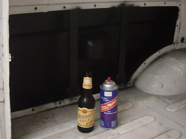

some updates

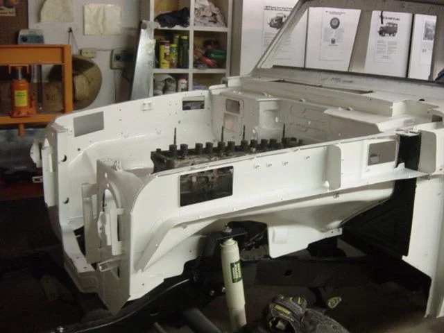

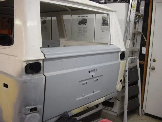

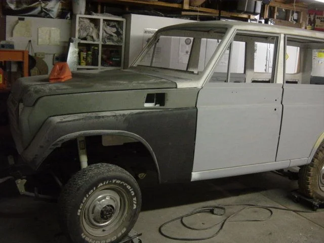

so, time for some updates, got the body back on the frame and all bolted down finally with the correct size and length bolts. Got the front clip painted with zerorust white and zrust clearcoat and bolted onto the front. Also got all the body panels primed and put into place. The hardest one was the rear tailgate. I figured out how to get the "tailgate assist" torsion bar to work and am very glad I did! It is a nice addition to have the tailgate slowly drop and assist a bit when lifting it up. Also black zerorusted the rear interior corners and spray a buttload of the wax paint back there, won't ever rust again.
After I got the 55 all buttoned up I looked to the fj40 to occupy me for awhile. I had previously (about 6 months ago) stripped the 40 down to bare bones to get it painted, then realized that I needed to get the 55 back on the frame before I could do anything about the 40. So, the last week has been spent scraping the 40 down to bare metal. I am glad I did this as there is no way a bodyshop was going to do this without charging me up the nose. I dropped the truck off at earl scheib today. $650 for everything including a bunch of brackets and small pieces and the rear doors. They are going to fix a few major body dings but other than that they are going to prime and paint it and match the interior color. It comes with a 6 year warranty so hopefully it will adhere correctly. I am not looking for a perfect paintjob as at it's heart this is a trail truck. Wish me luck, I will post up the reassembly here:
