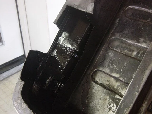

the little channels on the underside of the piggies rockers were rusted, so I cut an access hole in each, cleaned em out thoroughly, phosphoric acid, tsp, then coated with a thick lather of zerorust.
I also cut an access hole to the rocker panels in the rear where there was a bit of rust. I also cut some new drain holes all along the rockers, I plan to use some plugs later that I got from eastwood. It was a bitch to get all the dried mud and crap out of there, lots of time spent with a coat hanger and compressed air. Finally got it all out, phosphoric acid the crap out of it to kill any rust, tsp, then I used an eastwood product called heavy duty anti rust, great stuff!, it is like a paint but has a waxy film when it dries and it really gets itself into every nook and cranny, and repels the rust as it is basically an oily paint that repels water. I used a bunch of this in the rockers all over and sprayed compressed air to move it around. I am happy with the end result. I plan to spray this stuff up there every so often when the truck is done.

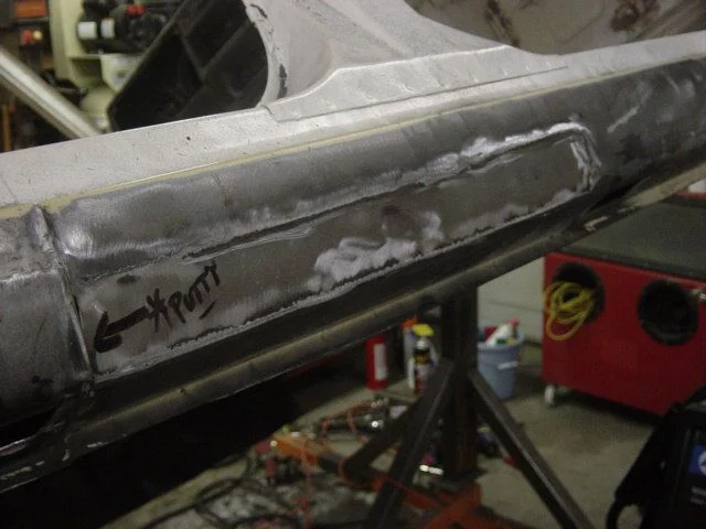

first pic, small rust spot repair
2nd - rocker rust repair, pulled the previous sloppy repair which was a piece of metal lap welded in there, I but welded the piece in there.
3rd - took the handle of my high lift to create a bit of a curve on the piece that I replaced in the above pic, friend gave me the idea, and it worked well.
