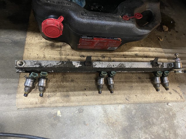

Finally started my injector replacement project. Taking my time and cleaning things as I go since well... I dont have to drive anywhere in the FJ62 for a while :/ Have a stash of essential parts for this job I banked away and a set of refreshed injectors from WitchHunter. Cant wait to see how much better this engine will run.

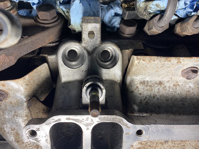

Thankfully I had a dremel polisher the exact size of the injector ports. Worked perfect!

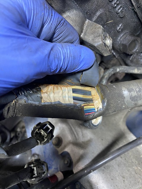

Wires at the pinch point in the wire loom looked great thankfully! I will rewrap this and wrap the whole loom in heat reflective cloth.
You should get a nice seat of the pants improvement in how it runs. Certainly should start and idle quick and smooth.
I did this job a million years ago and would like to do it again with combined desmog with air rail removal and plugs. At the time I also had my throttle body bored out which I think gave it the most improved feel.
How grungy was your cold start injector, and the intake plenum overall? Had any luck cleaning out the plenum yet?
The cold start injector was nasty! I had that refreshed by WitchHunter a few months back and used that right away since it was so easy to swap. :) I am still trying to clean out the inside of the intake manifold. Hard to get in there. I loosened up some gunk which I now need to make sure I get it all out. Can't leave loose bits in there! I think I may want to do a oil catch can based on how much gunk was in the intake.

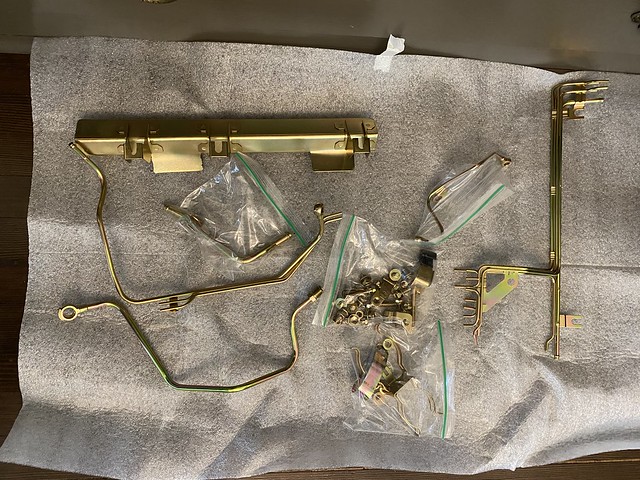

Got some parts back from the platers today! I have never had parts plated before but I am definitely a fan now! :D
I was a bozo and forgot to get a few parts plated but I will circle back and get them plated at a later date.
What method did you use to clean out the intake?
Thanks! Time to scrub more. :) Excited to see how this runs after.

just be careful with those plastic injector clips! They are always very brittle. Now I would order a set of replacements just to have ready in case you break one.
I have those on standby! I think I saw a old thread where you mentioned that. All the terminals came off ok-ish. I can tell they are brittle. The wires are very stiff. Hopefully none of the insulation cracked while I have been moving it around.
