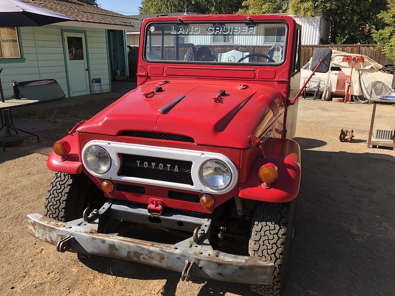

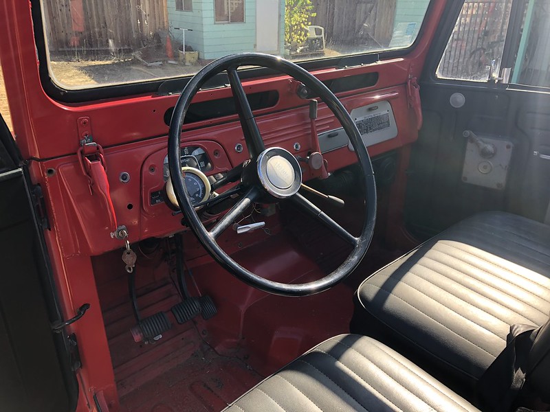

Here are some photos I received yesterday. My uncles are going to be holding it for me in CA until I can get down there in November. I wish I could fly down now and drive it back to Seattle.

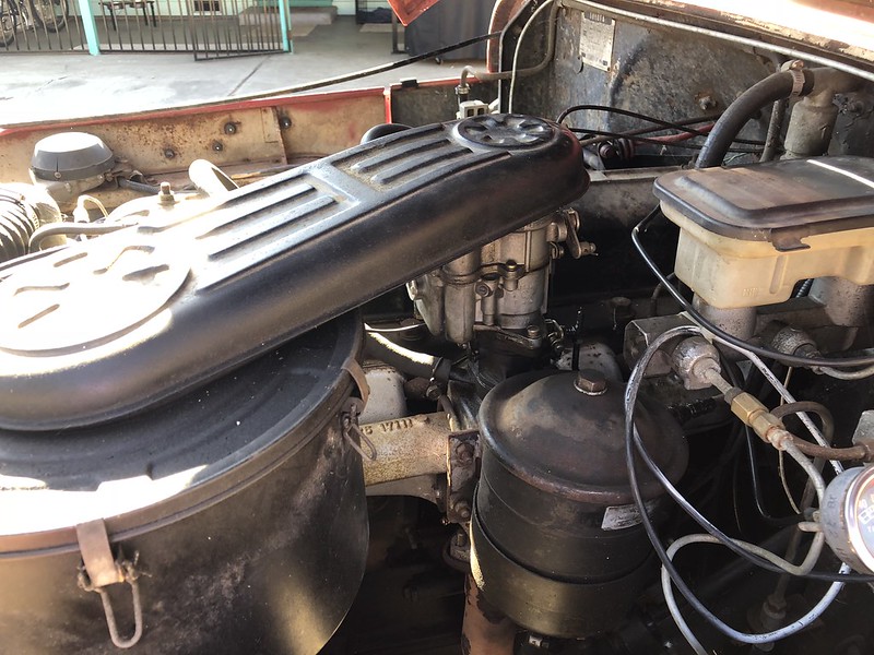

Mods I did before I sold it:
1969 front axle with FJ60 knuckles and disc brakes
Chevy S10 master cylinder with firewall adapter
Rebuilt carb by JimC
(crappy paint job)- totally my dads doing
Redid seats with SOR covers and foam
Me working on it after driving it 400 miles from Arcata, CA down to Monterey,CA. Sometime in 2005
That cruiser never let me down once. Going to be a fun reunion. So many things I want to do to it to bring it back up to snuff and preserve it for the next generation.

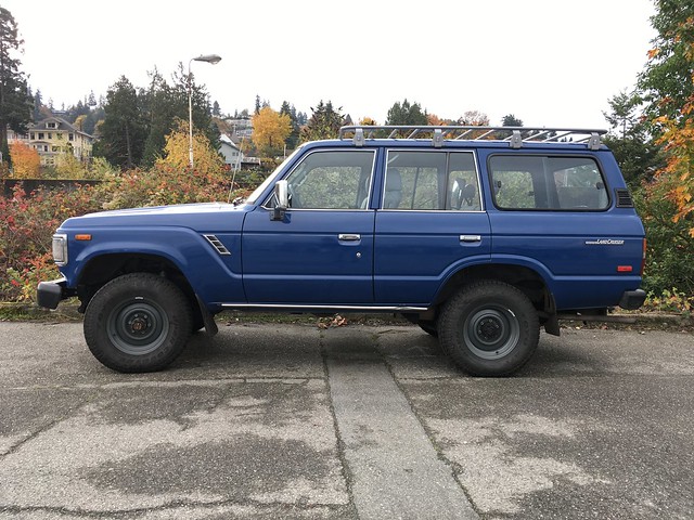

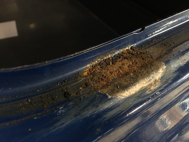

Been a while with a project update but the cruiser has been fantastic so I am not complaining. One issue I put off for too long is diving into this rust issue on my rear cargo window sill. I of course waited until maybe the last week of warm enough temps here in Seattle to tackle it. Nothing like procrastination! In this case that bit me in the ass with the rust issue.

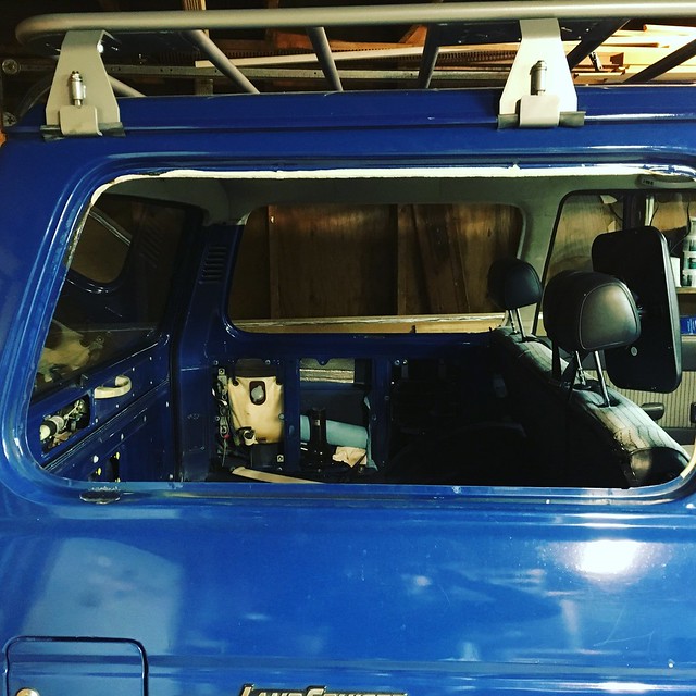

I had seen some surface rust peeking out from below the gasket on the rear cargo window. I knew that more was waiting deeper inside and I couldn't go another 10 month rainy season without putting a stop to it. So i decided to take out the cargo windows and see what was really going on:

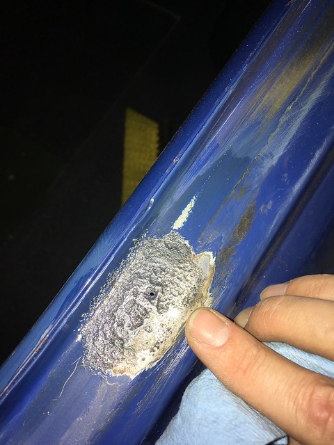

More rust than I had hoped for and after some grinding/sanding and rust converter this is what I was left with... a pin hole
Since I still hope to one day do a full and proper paint job (either me or an actual professional) I decided that the since the rust was ground out/converted I would fill the pitting and pin hole with steel epoxy putty. I laid it down, sanded it smooth and coated the surface in 2K primer:

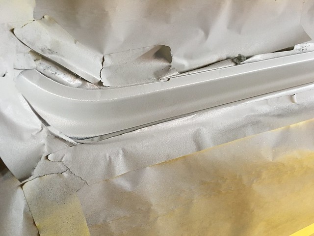

Temps were in the mid 50s today and with the help of a heater I was able to get my old garage up to 62 degrees. Tonight I laid down three coats of base and three coats of clear. Hopefully it turns out nice tomorrow when I take the paint off.

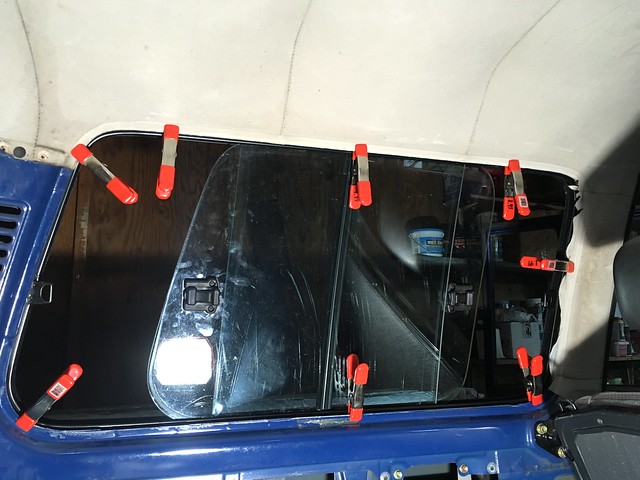

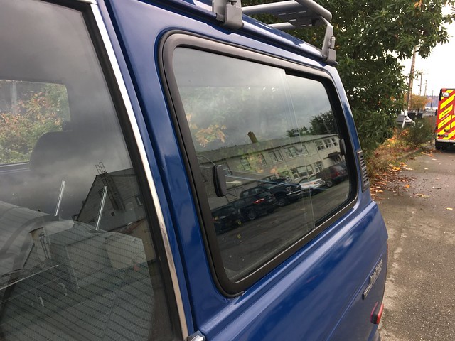

Finally complete 2 years after acquiring these windows from AUS. So happy these are all done and in! I used 3M butyl sealer ribbon and a lot of strong clips to seal them in. Then finished them off with a grey interior lockstrip/trim. The windows are a little hard to slide because all the seals are so fresh but with time they will get a little easier. Now I need to get a dog again to make full use of them. :D
The FJ62 is slowly becoming the US version I wished they offered in the first place....
Big thanks to @NookShneer for help in completing the project. As well as @beno and @cruiserdan for comparing 80 series and 70 series sliding window parts for me. :cheers:

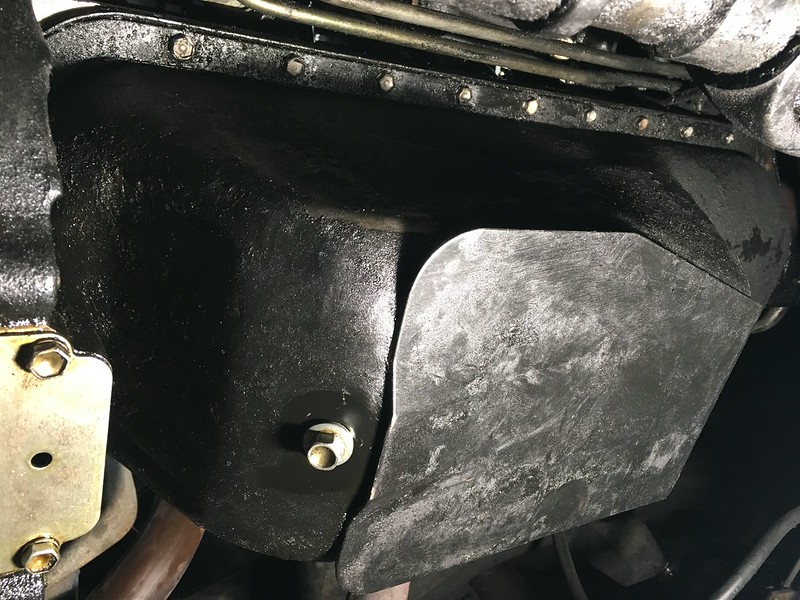

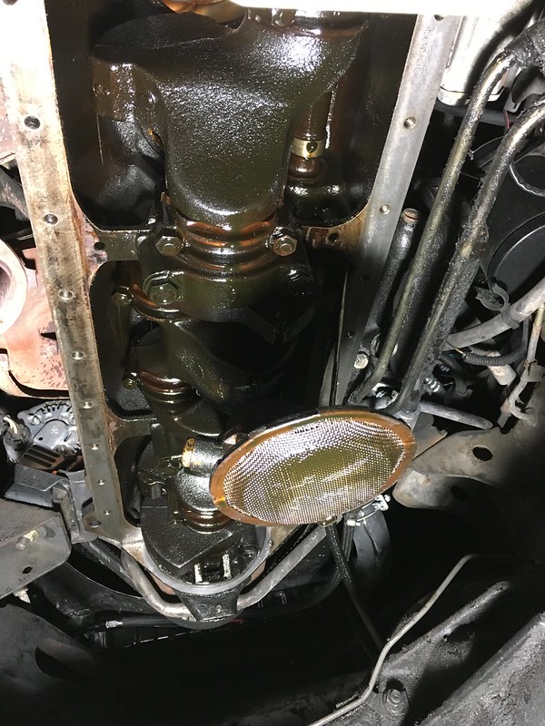

Replaced the oil pan gasket. What a serious pain in the a$$. Took me a total of 10 hours (not joking) spread over a couple days to get it off, cleaned and bolted back up. Never want to tackle that job again! Decided to throw in Rotella T6 synthetic for the fill up.

Would you happen to have part #’s for the new seals? I have a set enroute from AUS now. They will probably need to be freshened up!
