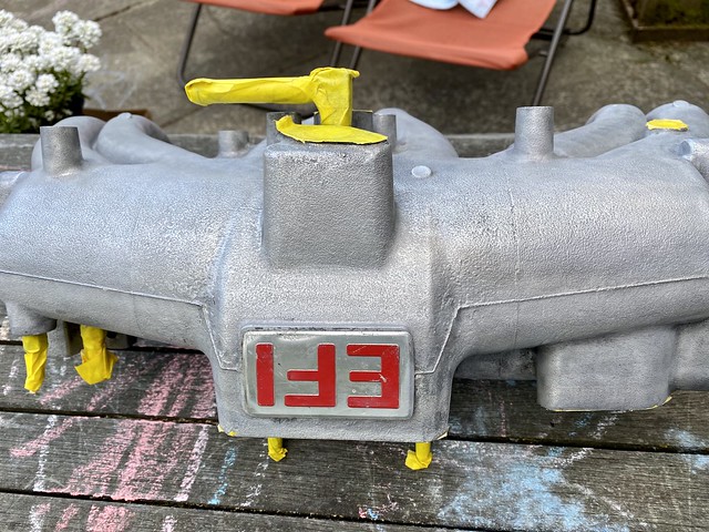

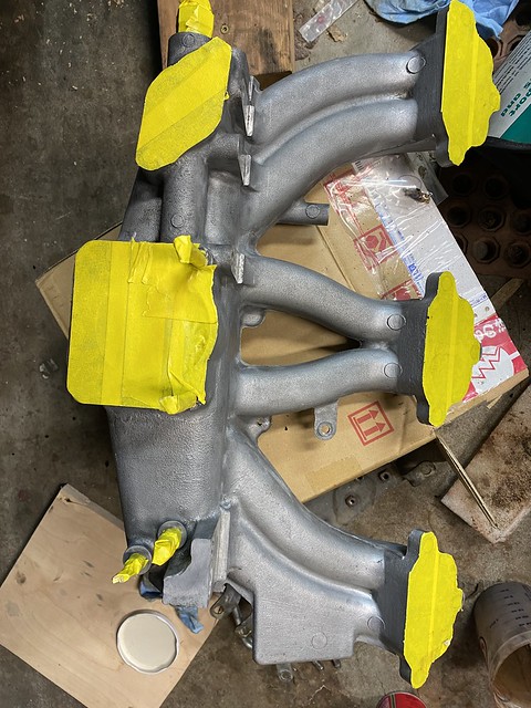

Working through parts and cleaning up. Waiting on some chemicals to come in to coat the raw aluminum intake to prevent oxidation. Going to try coating it in Alodine 1001. The stuff is mainly used in the aircraft field as a base to paint aluminum parts but based on reports from other car people that have used it, it works well as a stand alone top coat while keeping the aluminum looking raw.

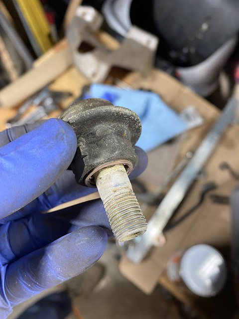

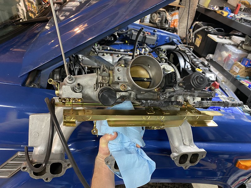

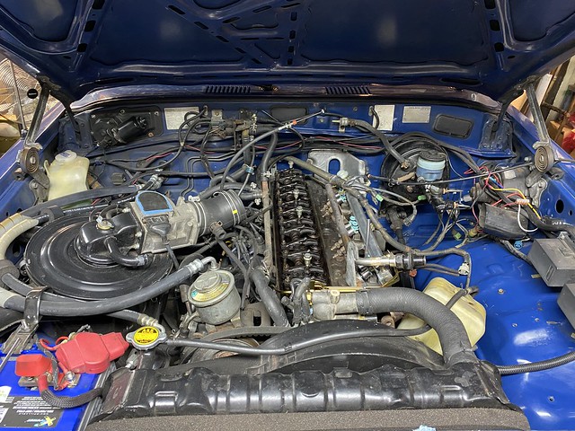

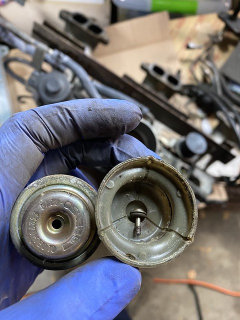

While I am biding my time am focusing on the injectors and fuel rail. I popped the cap on the pulsation damper and found this:
Also found some white crust inside the fuel system which I think is from ethanol induced moisture increases.

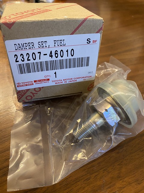

Not sure if that screw being completely off is critical but a new pulsation damper will be going back on.

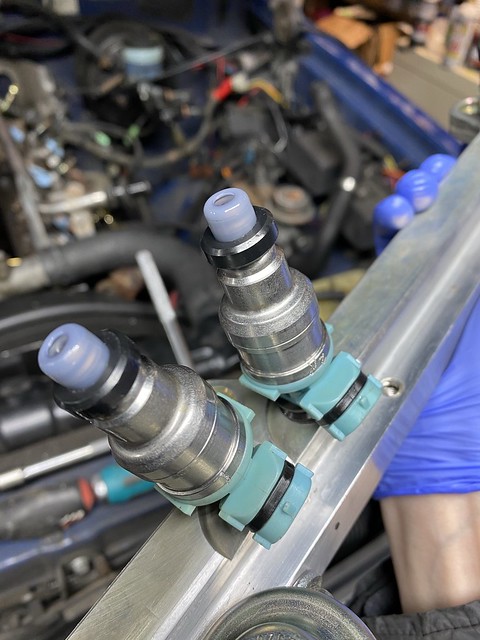

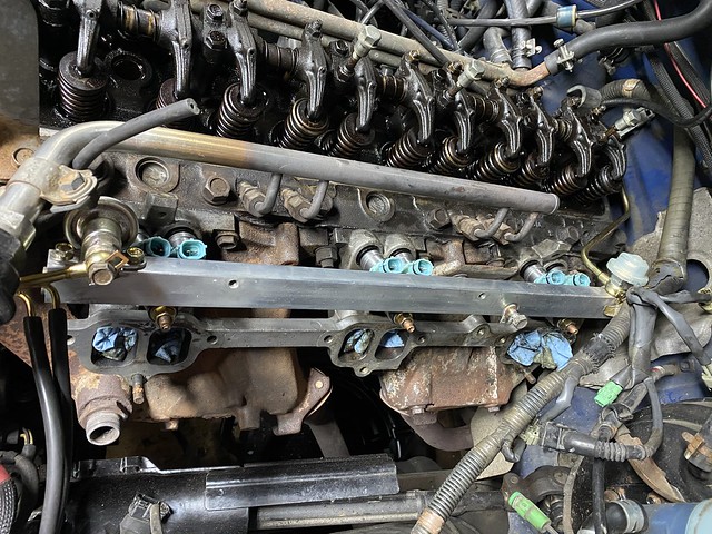

Rebuilt injectors, fuel rail and plated fuel lines installed. Replacing that rear fuel line on the 3FE was a total pain but at least its done.

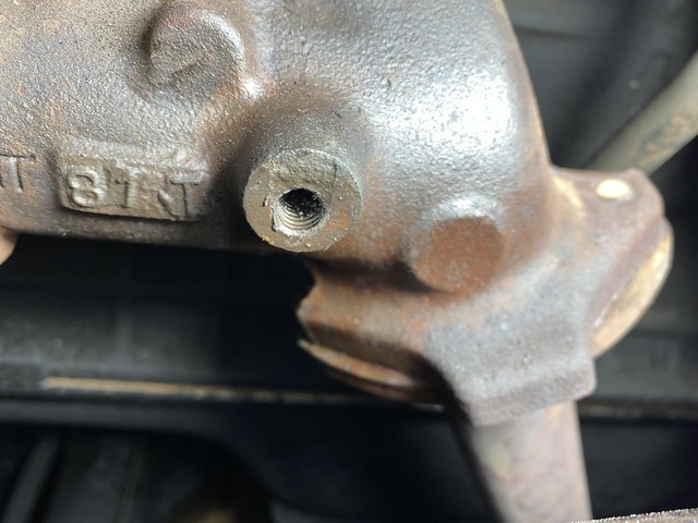

So I took off one of the exhaust shields and one of the bolts broke.... not a surprise. Especially since @Kleatus warned me not to. hahaha. So now I have to battle to get it out. But the original idea was to swap out the shields for a nicer pair that I have. That back shield is really rusty and looks terrible. So now not wanting to deal with a potentially broken bolt scenario in the back of the tight engine bay, I am going to leave it in place and paint it with a brushable high-temp paint. That way I can help control the rust and clean it all up a bit. Adapt and move forward. Alodine gets delivered on Thursday, excited to see how the intake looks after treatment. Once that is done, I will start bolting the intake back together. Trying not to let this snowball too much, as I clean stuff up, other stuff looks worse and worse. :p
Still waiting on one last part to try and get that broken bolt out of the manifold. Thanks to @NookShneer for loaning me some tools to get this job done. In the mean time I have been cleaning parts. I started on the engine bay sheet metal. Used a combo of a blue scotch-brite pad, dawn soap and a lot muscle. Kept the paint safe and cleaned up well! You can see a distinct difference between the sides of the engine bays:

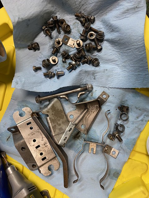

Finishing hardware cleaning with a combo of mechanical and vinegar soaks. These parts will be sent out for plating.
Waiting for alodine wash later today:

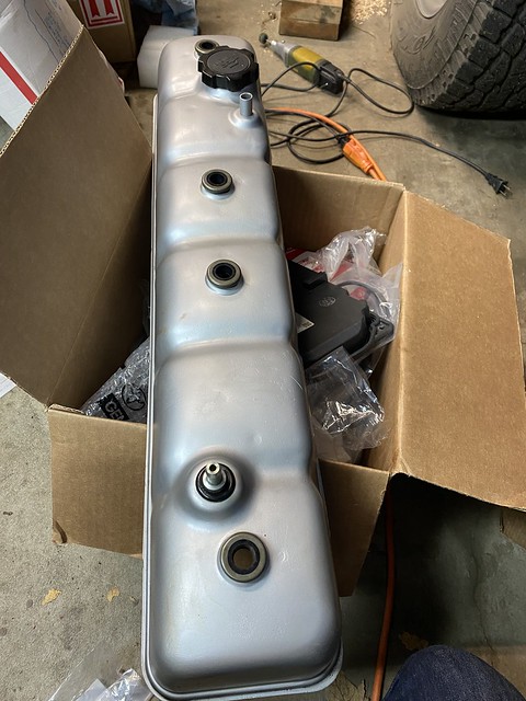

Finished valve cover with all new grommets and pcv valve waiting its turn to crown the engine block.

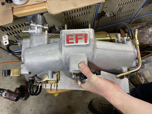

Intake post alodine treatment and shiny bits starting to get bolted on. Put on one of my NOS IAC valves. :)

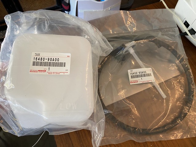

New radiator overflow bottle and cap/hose from my back stock of parts going on
Successfully drilled through the old bolt and broken tap. Tapped in new M8 1.25 threads so I can still use the OEM bolts.

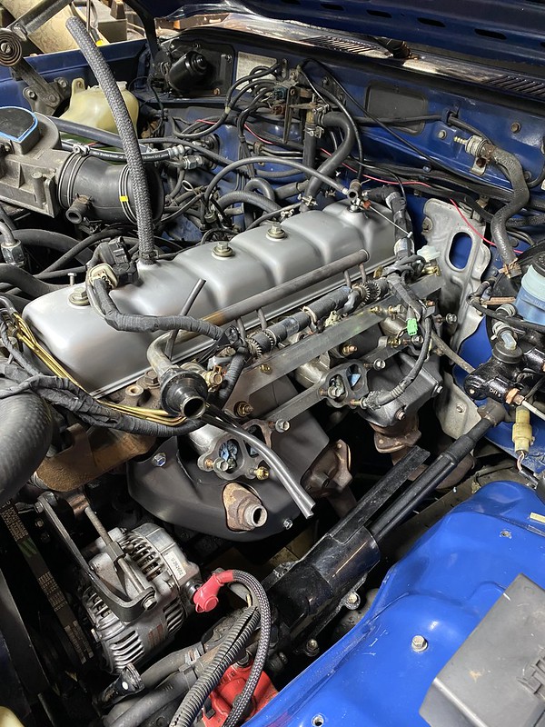

Mostly small stuff as supplies roll in, but still waiting for parts. Hopefully everything will be here by next week. Got the main chunks of harness wrapped in heat shielding and taped up. I added an extra ground wire to the EFI ground point on the intake. Painted the exhaust shields but we will see how long it lasts.

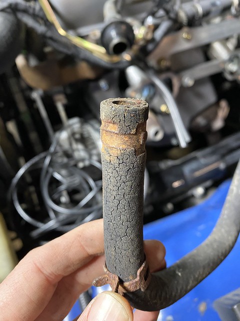

Discovered my brake booster vacuum tubing was maybe a bit past its prime :skull:
