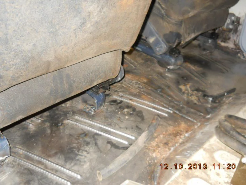

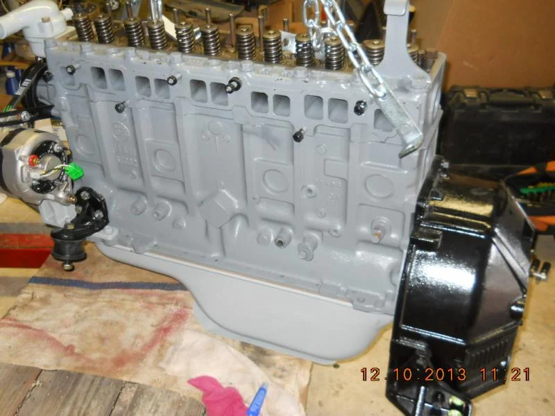

Notice the seat rails welded in. The new buckets are adjustable to under the dash to in the back seat. Long range of adjustment that should accomadate just about anyone.
