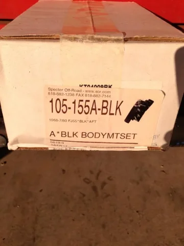

Body mounts came in and are going on pig today. Thanks a bunch! I have been mulling how to manufacture these.....

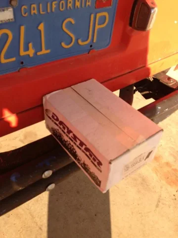

Dust cover for the brake booster came in today. $37 delivered to the door, and it fits perfect, made by Aisin.
The body mounts are all installed except for the core support. That will come early next week. For bolts I used two 7/16" x 6" (which could be 1/2" shorter), and the rest are 7/16" x 5", all grade eight with grade eight flat washers and grade 5 nylock nuts. I am not sure what the torgue is supposed to be for these mounts, but I do know that you don't want to get them too tight. The nylock is there to keep it from getting loose. Overall, we had a good day.

Did you have any trouble with the body mount holes and the bushings with the lips on them. Some of mine had to be reworked, so they mated right.

The body bushings fit nicely into the holes with no problems. The rear 4 are a real pain due to inaccessibility, but overall, the bushings can be switched out in about 2 hours.

Man, I spent all day playing with the bushings. Half of mine didn't fit in the different holes, with the lip, so I had to rework them. All good now.
