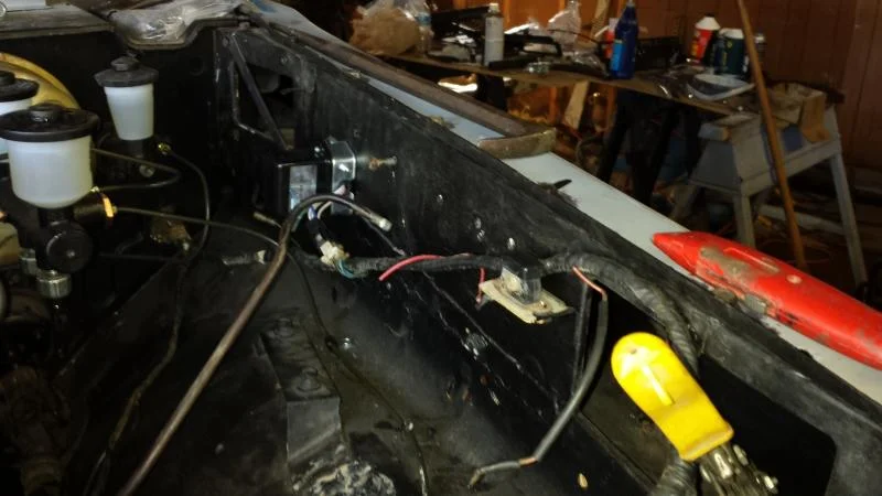

I am busy trying to get my internals all set on the tailgate. I am planning on using this as a replacement for the cardboard junction block in the tailgate. Do you see any reason not use it?
Toyota still sells the factory item...

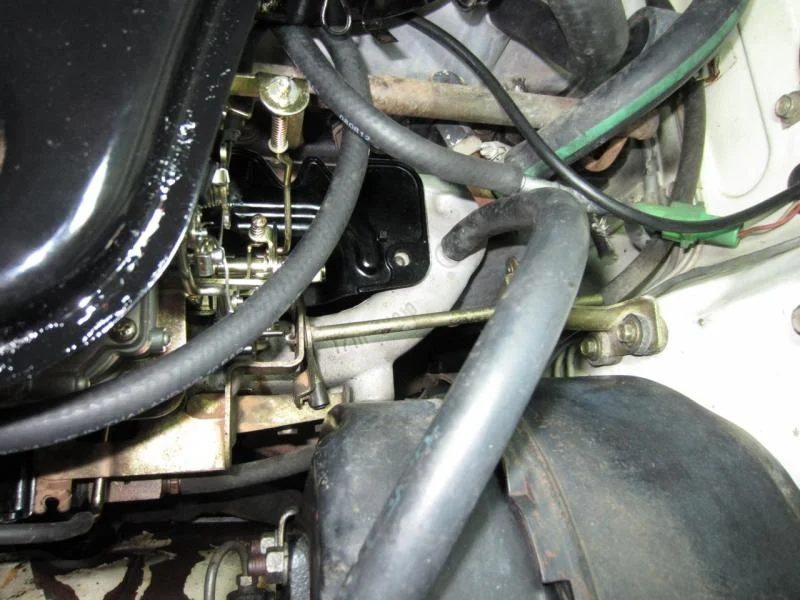

Who has a carburetor linkage all set up correctly and functioning as it should that could shoot a photo of it and post it here? I am about to mount the carb and linkage. It has been a few months since I took it off, and I wasnt familiar with it that much then. I have all of the pieces in a zip lock bag and have an idea how they go. A photo or three would be greatly appreciated.

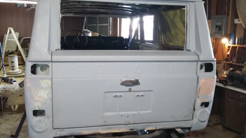

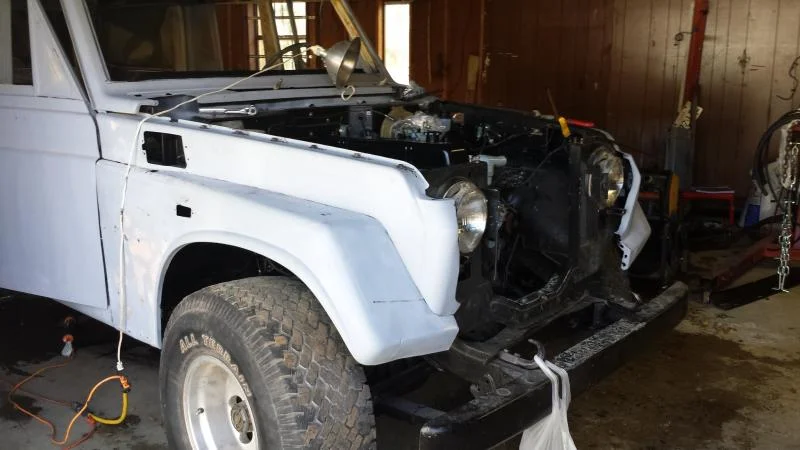

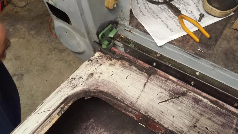

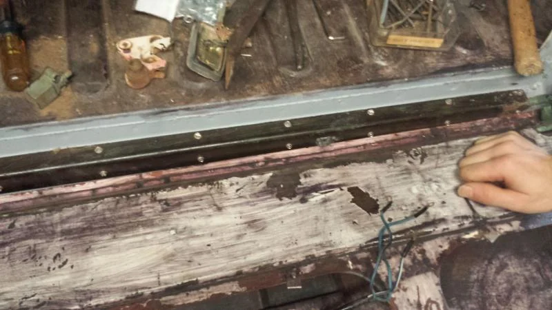

Well, we are back at putting the pig back together and getting it ready for paint. Today we got the tailgate on, and that was a real pain. No need in painting it beforehand, you will just screw it up. I almost cut the spring rod off. I went back with stainless hex head sheet metal screws on the spring cover. The phillips heads seem to rust out and become a pain. I also put new bushings in the hinges. I used Mcmaster Carr P/N 6659K12. It took three people to get the gate on there. Later today, we will put on the ignition coil and hook up some fuel lines. I hope to finish the t-case linkage today, also.

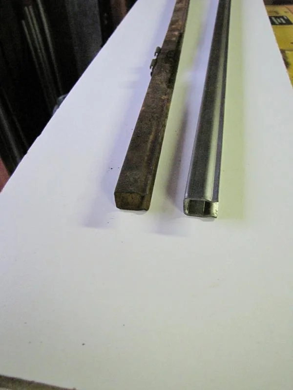

My helper ended up cutting my channel that holds the rear glass in place. Any chance someone out there have one that they do not need?

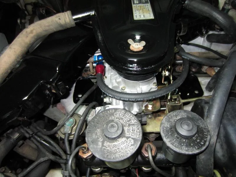

Needing some help here.
I will get you a photo this evening. I just did the same thing on mine yesterday.

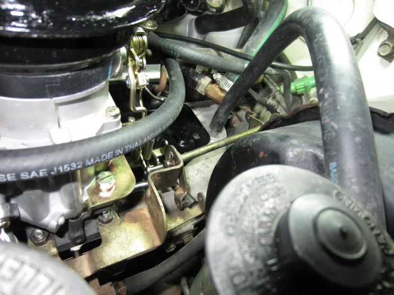

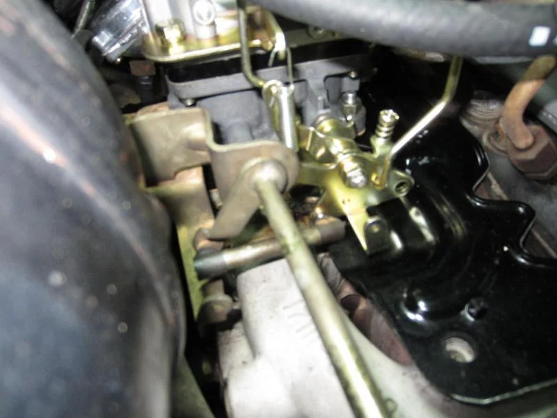

here is the factory linkage on a trollhole carb.
let me know if you need a more specific shot however think this will get you started.:lol:
Checking in with you guys. Today, we hooked up the linkage on the carb, started installing cables, fuel lines, etc. Tailgate is installed and functions as it should, excepting the rear glass, which is not installed. The seats are apart and getting re-covered, and we are steadily moving ahead with the assembly. I am checking in with Bob on the channel. I am sure that there are other parts missing in the tailgate, but I will source or improvise as needed.

I'm hoping to reuse the clips off the old channel and spot weld them on to the new one. You all should get together and have Bob do a production run. Mine was nearly in pieces when I took it out. There must be a lot of mudders who are having the same issue.

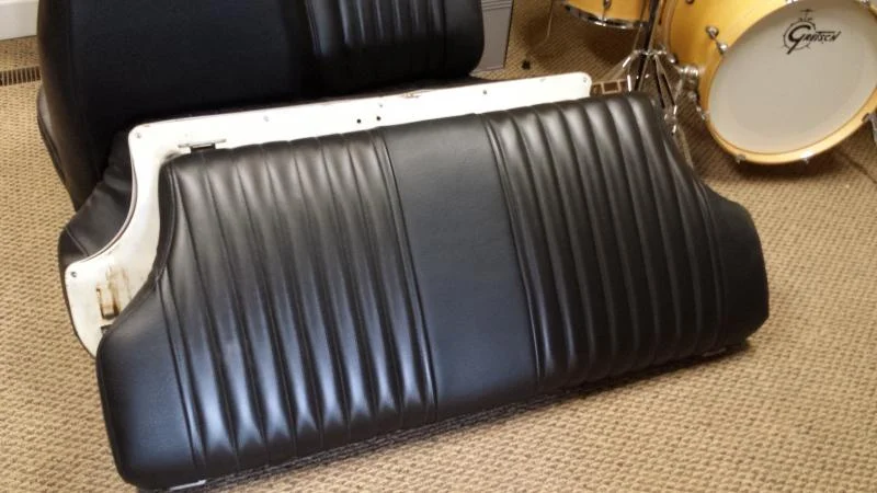

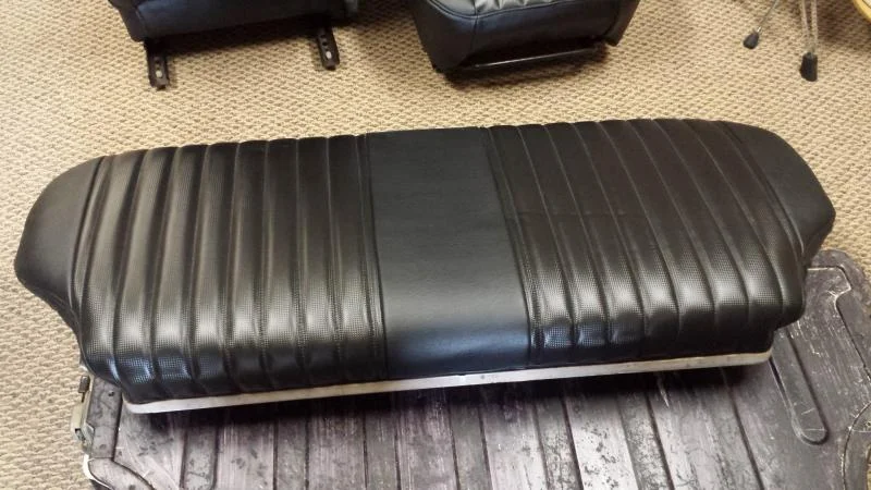

seats
I got my seats back today. They look great! My upholstery guy did a decent job putting the Toyota stitch pattern on the buckets, and they would pass for OEM. I am inching my way toward a completion. I got my blower motor in, and I think it will work awesome. I am just havingcold sweats thinking about an instrument panel like JMack's.....I dont think I will be happy with the pig unless I can duplicate it...
