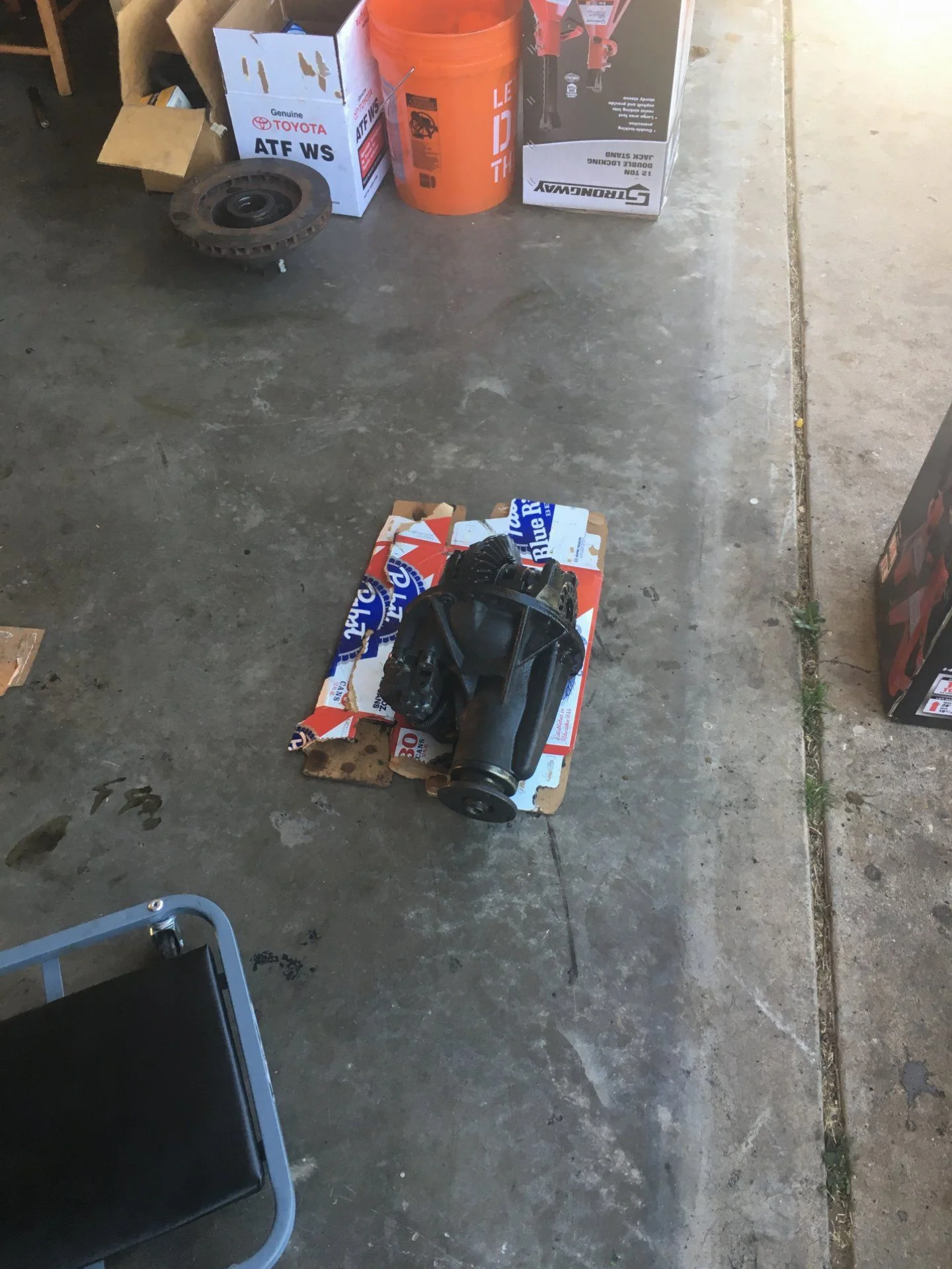

Well I managed to trip the locker and yank the 3rd member out of the front.. thanks for the advice guys!

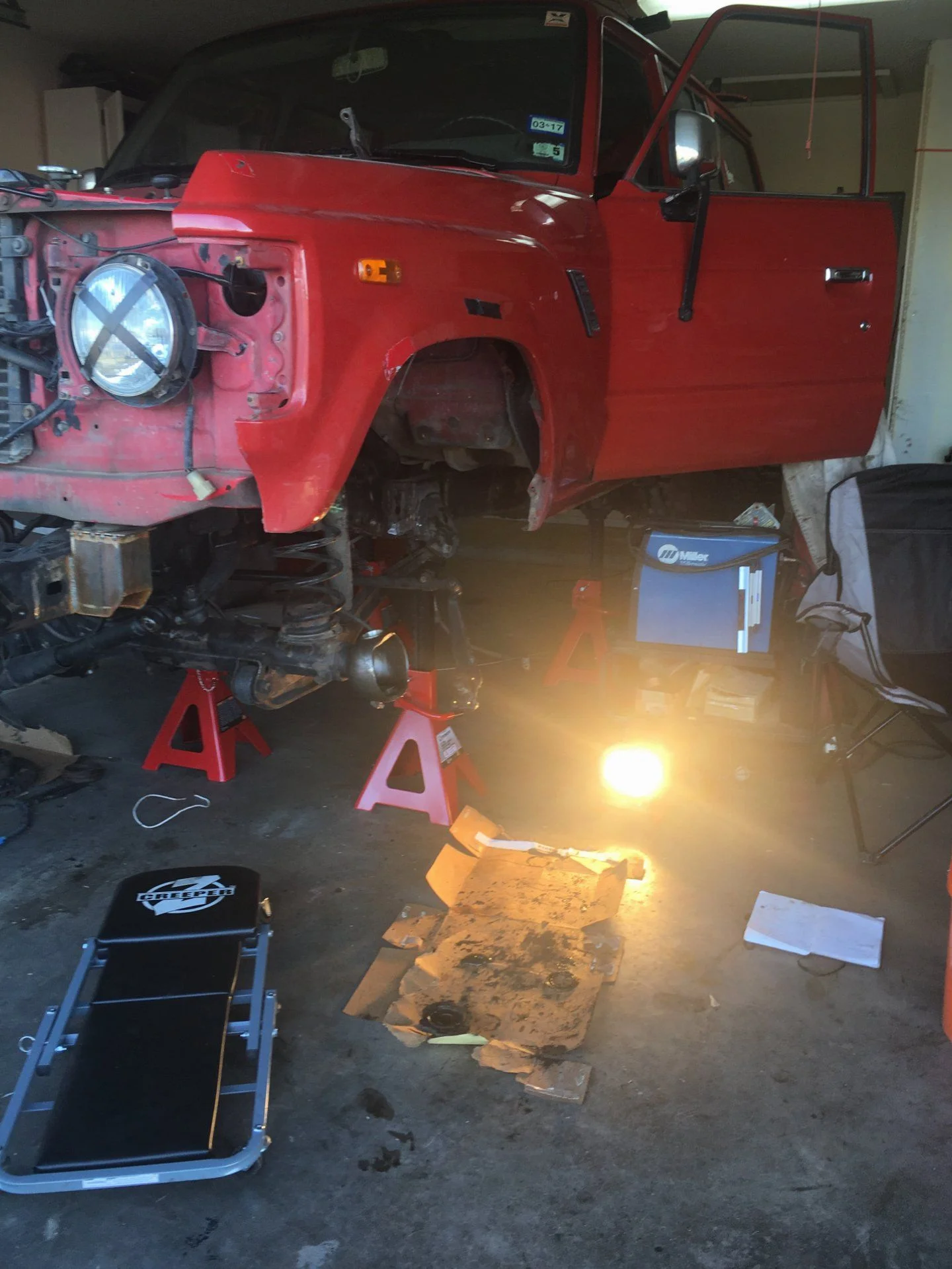

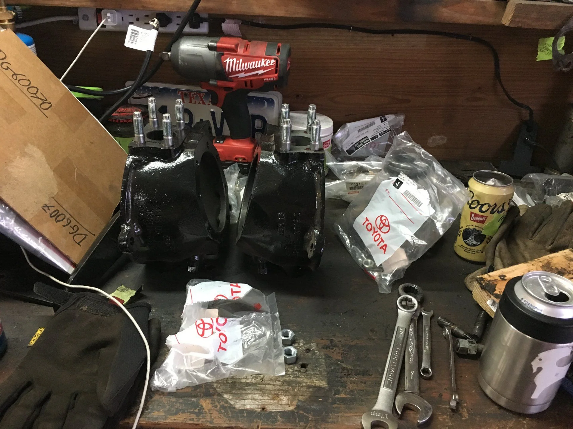

Other than that I used a roll of paper towels to clean all of the grease off of the knuckle balls and hub components. Also started tearing into the rear axle. Called it a night when I broke my 12mm bolt to pull the rear disk off. The drivers side rear was so worn down that the piston in the caliper was making contact with the rotor.. needless to say I need some new brakes on all 4 corners. Here are some pics:
Putting a little bit of lipstick on the knuckle components before I re assemble. Weapon of choice this time was rustoleum "professional" over self etching primer. I didn't put a top coat on the brake backing plates since I am going to be chopping them down to where it will just be a spacer which is how my 60 axle was setup and it looked cleaner. Plus you don't have to take off the wheel to get a good view of the brake pad thickness!
Should be rebuilding the front diff by next week, pretty exited/ nervous about attempting it for the first time... There are a few og master techs at work that know the way of the landcruiser and said they would help me out if I get stuck so I'm predicting a positive outcome!

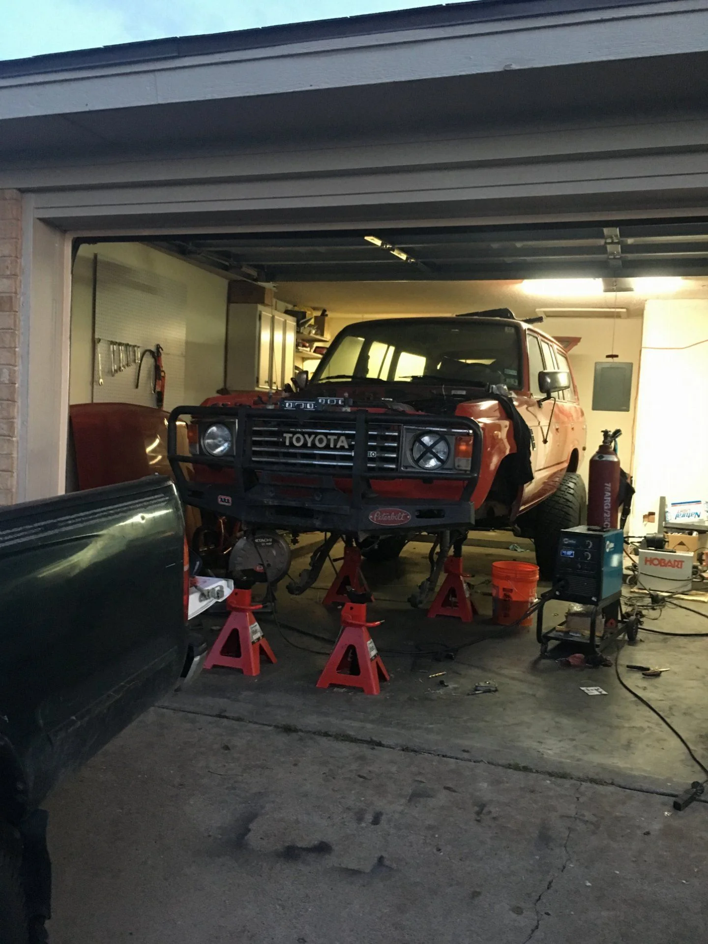

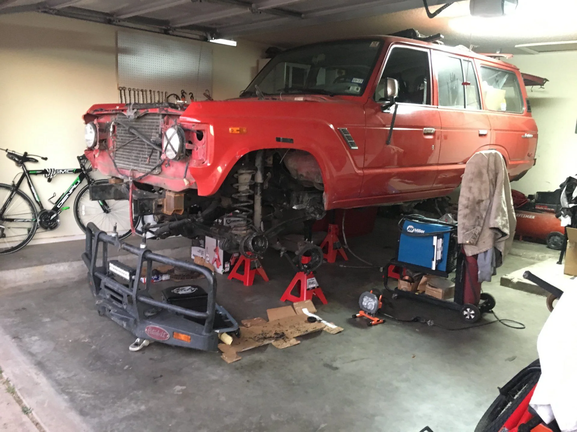

Bull bar is on, little bit of plasma cutting and welding and it fit like a glove on the 80 frame. I tried to get it as high and in as possible, it's a little better..

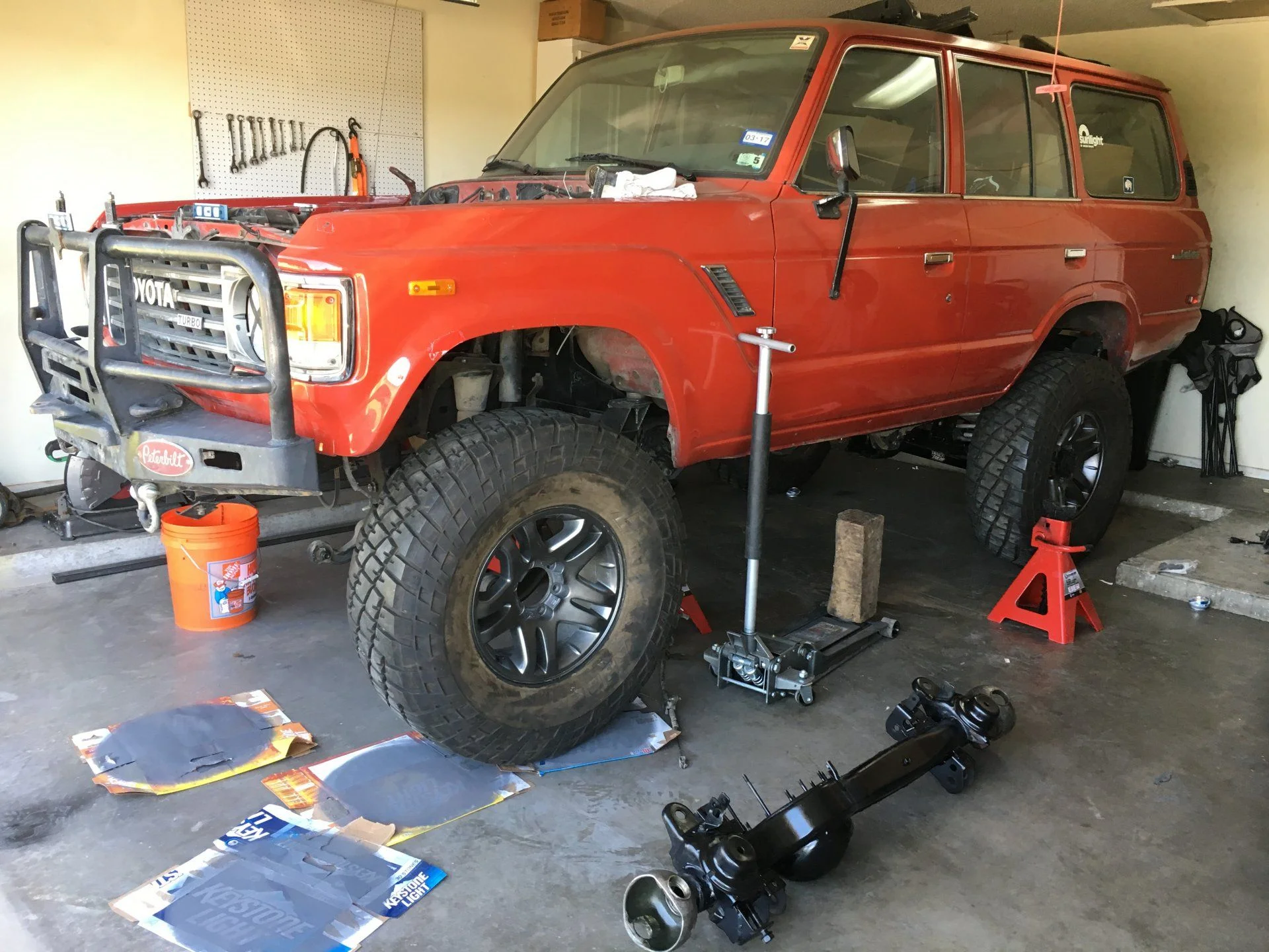

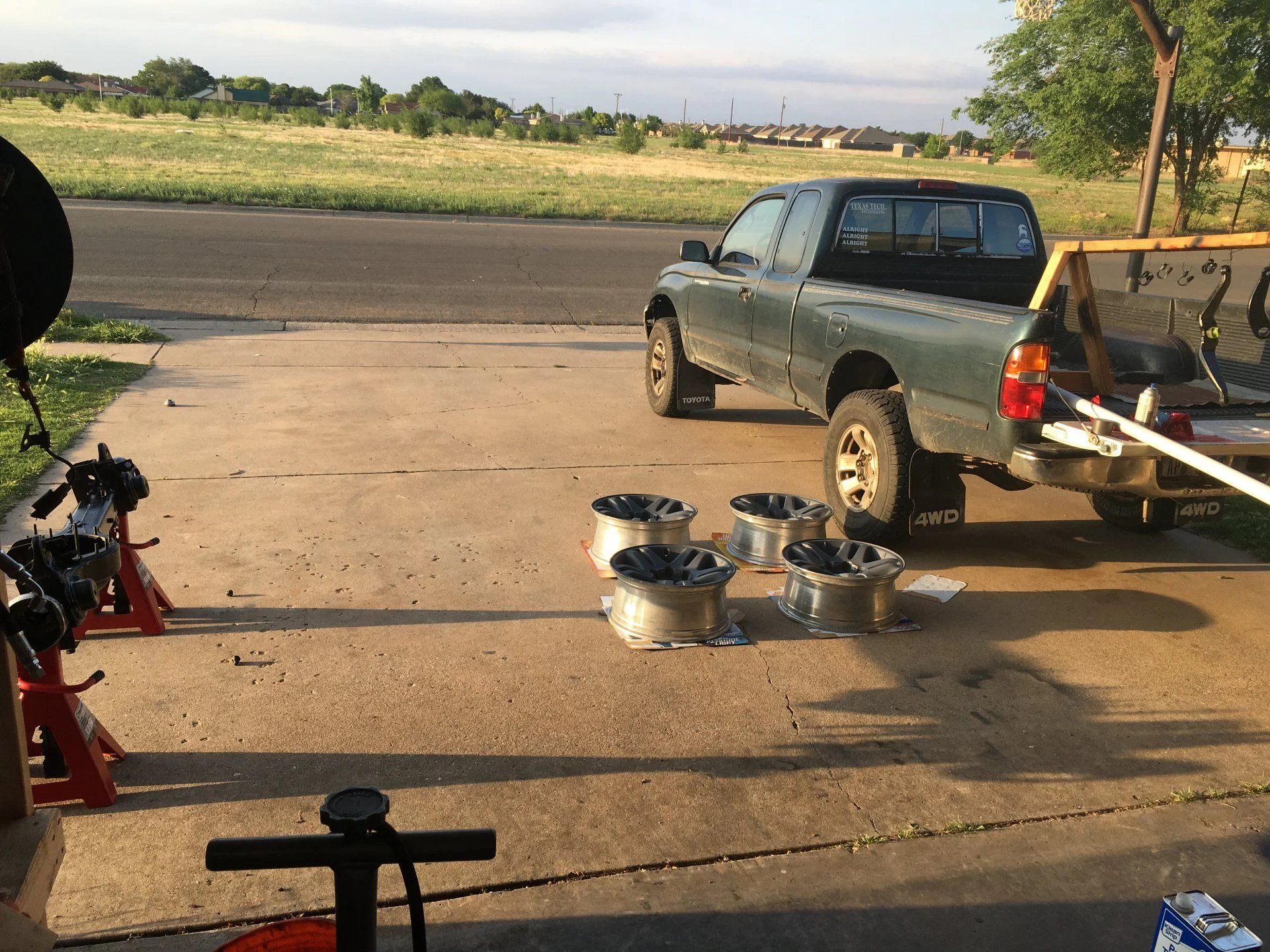

Painting the front axle and my new rims.
Other than the suspension, racor filter, front seats, sound system & bumpers this rig is going to be a Toyota Mut
What do y'all think of the sequoia rims?
