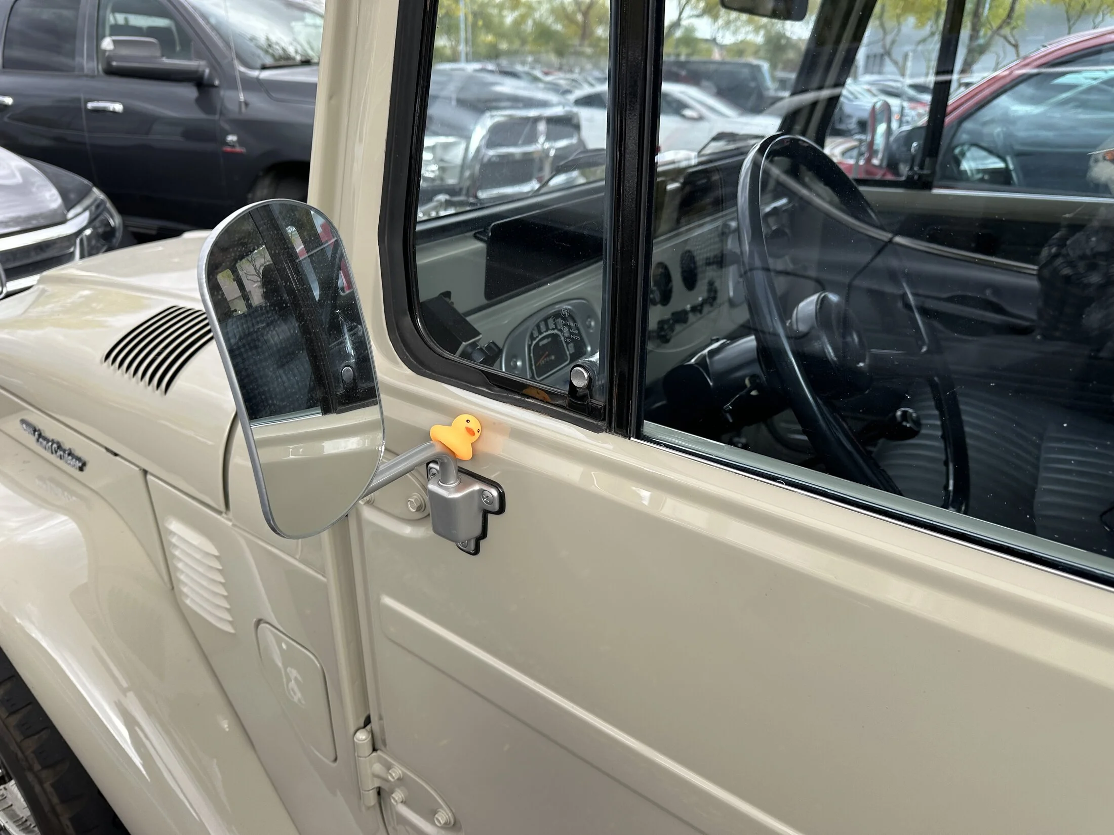

Hit up a coffee shop this afternoon to finish up some work. Got back to my 40 and found the telltale sign of a flat bill Jeep-bro…
It is NOT going on my dashboard. I didn’t realize this could spread to Toyotas.
It can’t; it won’t; don’t start. 😱
