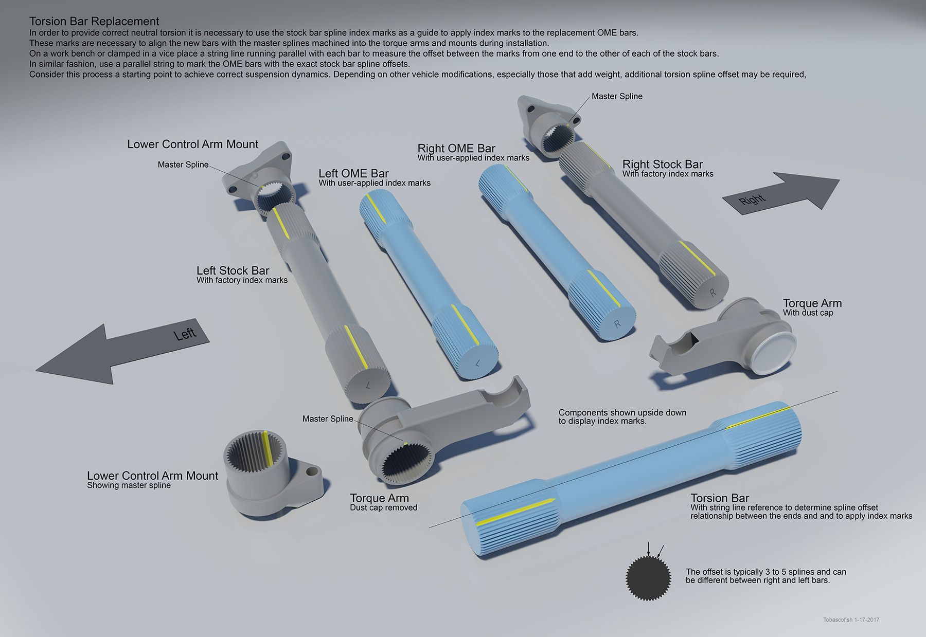

This subject confuses the heck out of me so I put this graphic together to help me visualize the concept.
Would welcome feedback and comments and, above all, confirmation that this is correct or not.
Excellent picture! I continue to read more about torsion bars and it may be that the more I read, the more confusing it seems. I'm unsure if the marks are anything other than a recommended starting point. The OME bars come with a mark on each end of the bar too, but those don't seem to line up to anything important either.
