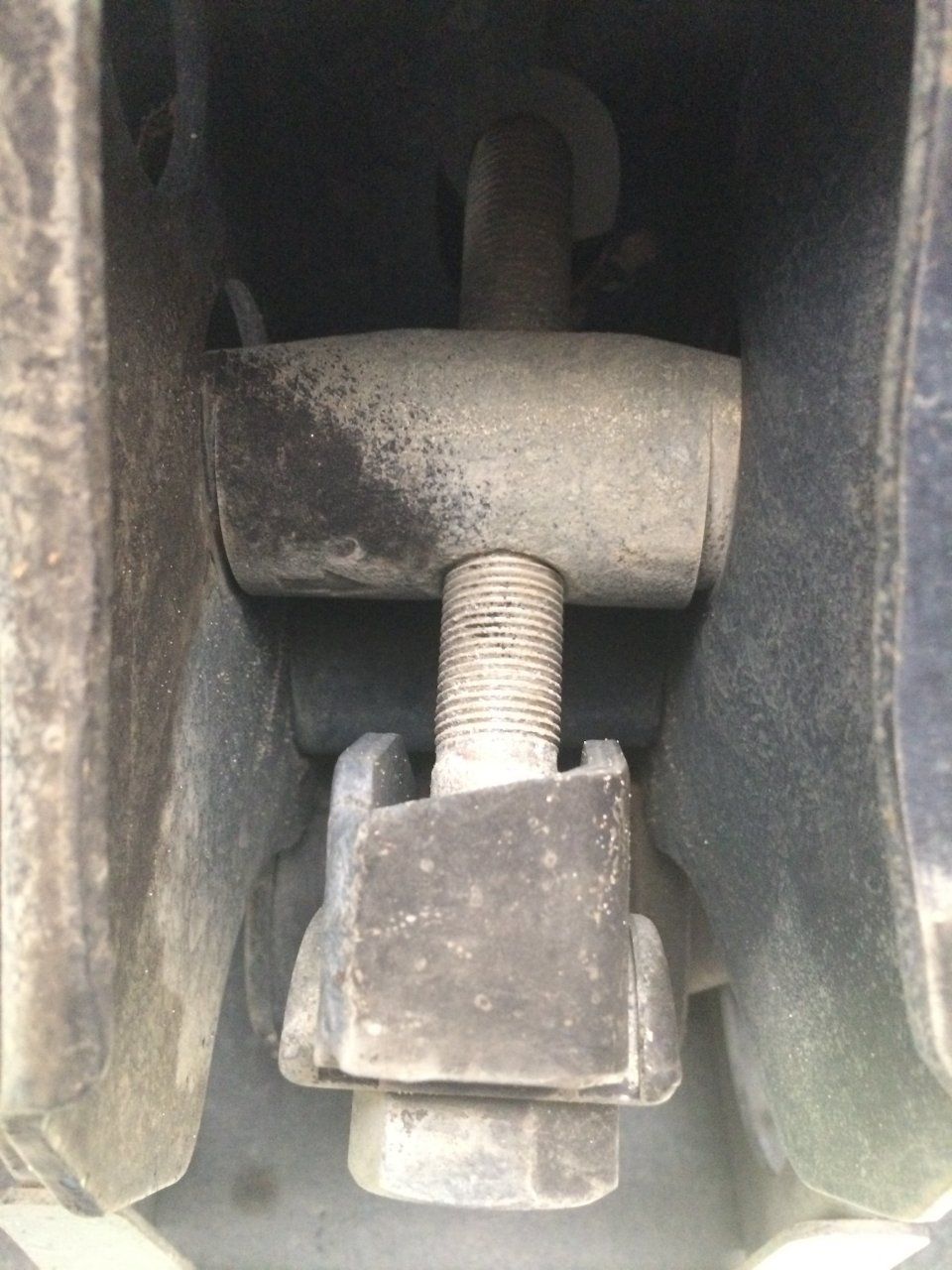

OK so bought a propane torch. Plan on heating up the Anchor swivel real good then trying impact wrench again. Penetrating oil has been on it since last night. What I need to know is what happens if the bolt breaks? Should I remove the nuts on the forward end by the front to take off some of the pressure? I don't want the impact gun to be jammed into my ribs if it breaks and the load unwinds...the bolt's only about 1 inch from all the way torqued down. some safety precautions ??
Is the bolt loose like this? If so you should have no tension on the TB and is safe to remove. The key should be hanging free like in the pic above. Got a pic?

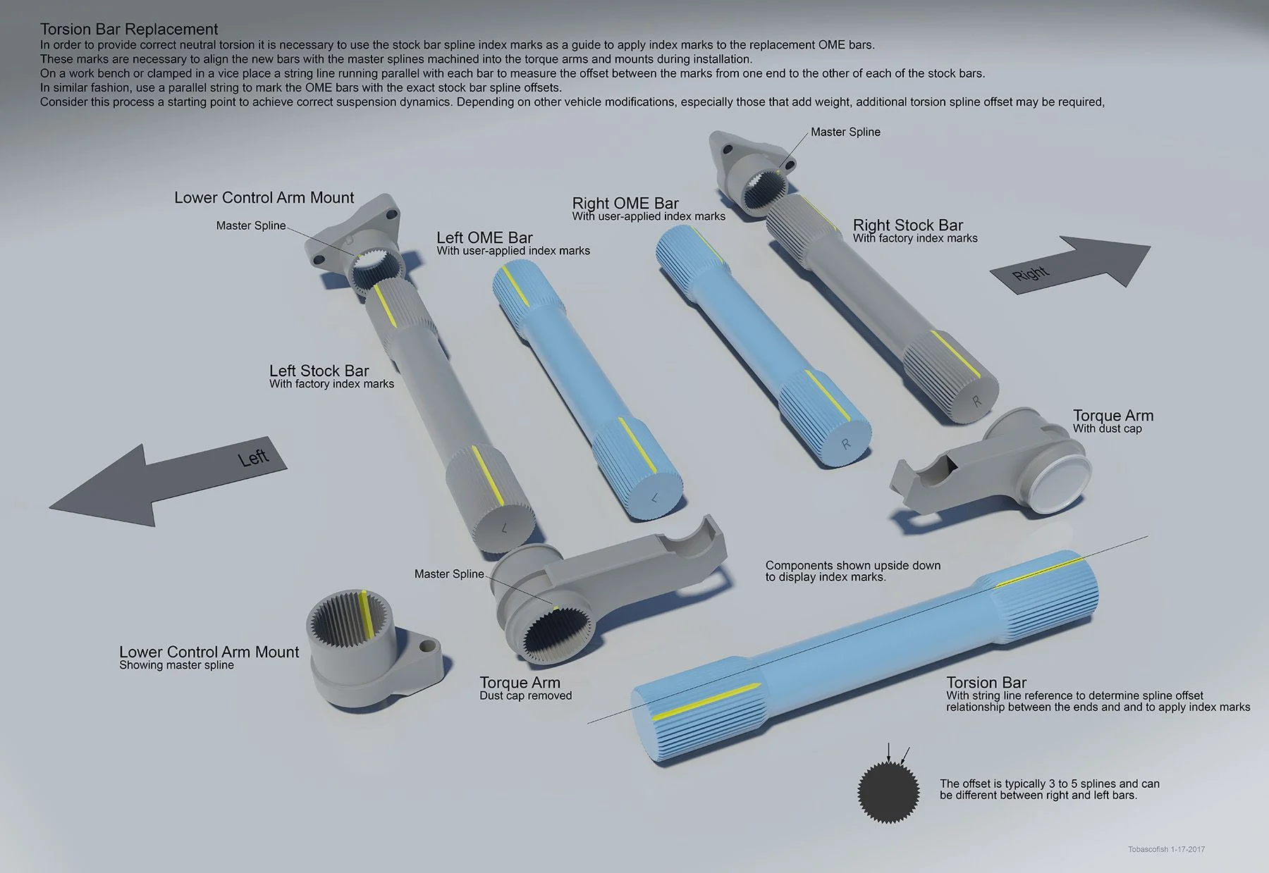

Anyways, i'm trying to understand how turning the TB a few splines counter clockwise allow me to crank the TB bolt and raise the car? It doesn't really make sense, no length is added or anything. Basically i just have to undo the TB bolts and pull it out, turn it counter clockwise a few mm and that'll allow me to have more threads on the "B" bolt for adjustment?
This subject confuses the heck out of me so I put this graphic together to help me visualize the concept.
Would welcome feedback and comments and, above all, confirmation that this is correct or not.

Yeah, just pull the bar out enough past LC mount and turn it to the left a few splines (driver side) on the passenger side you go clockwise
When you say mount, would that be the housing? Just trying to get the terminology correct, looking at Gunney's write up!

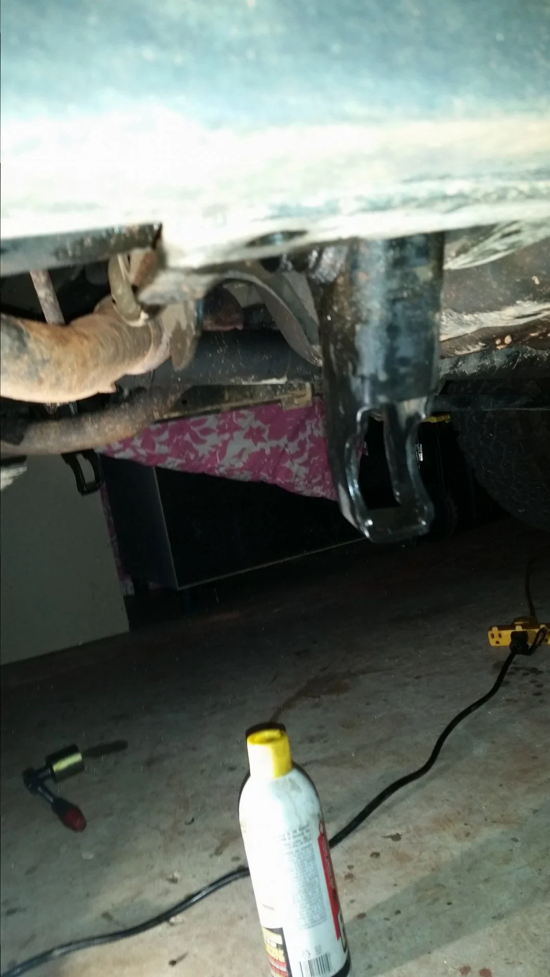

Tb's almost out, now I am trying to remove the tb from the anchor arm! Using plenty of pb any ideas on how to remove this?
