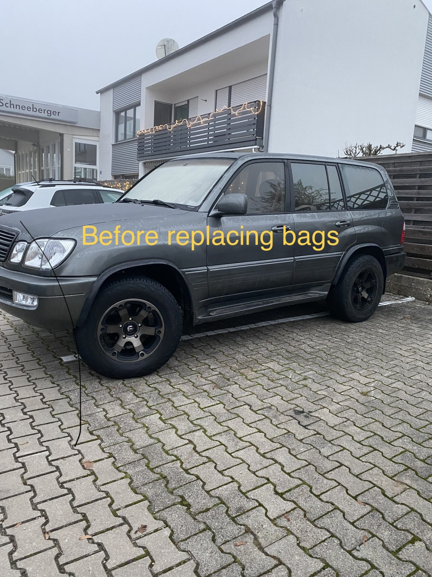

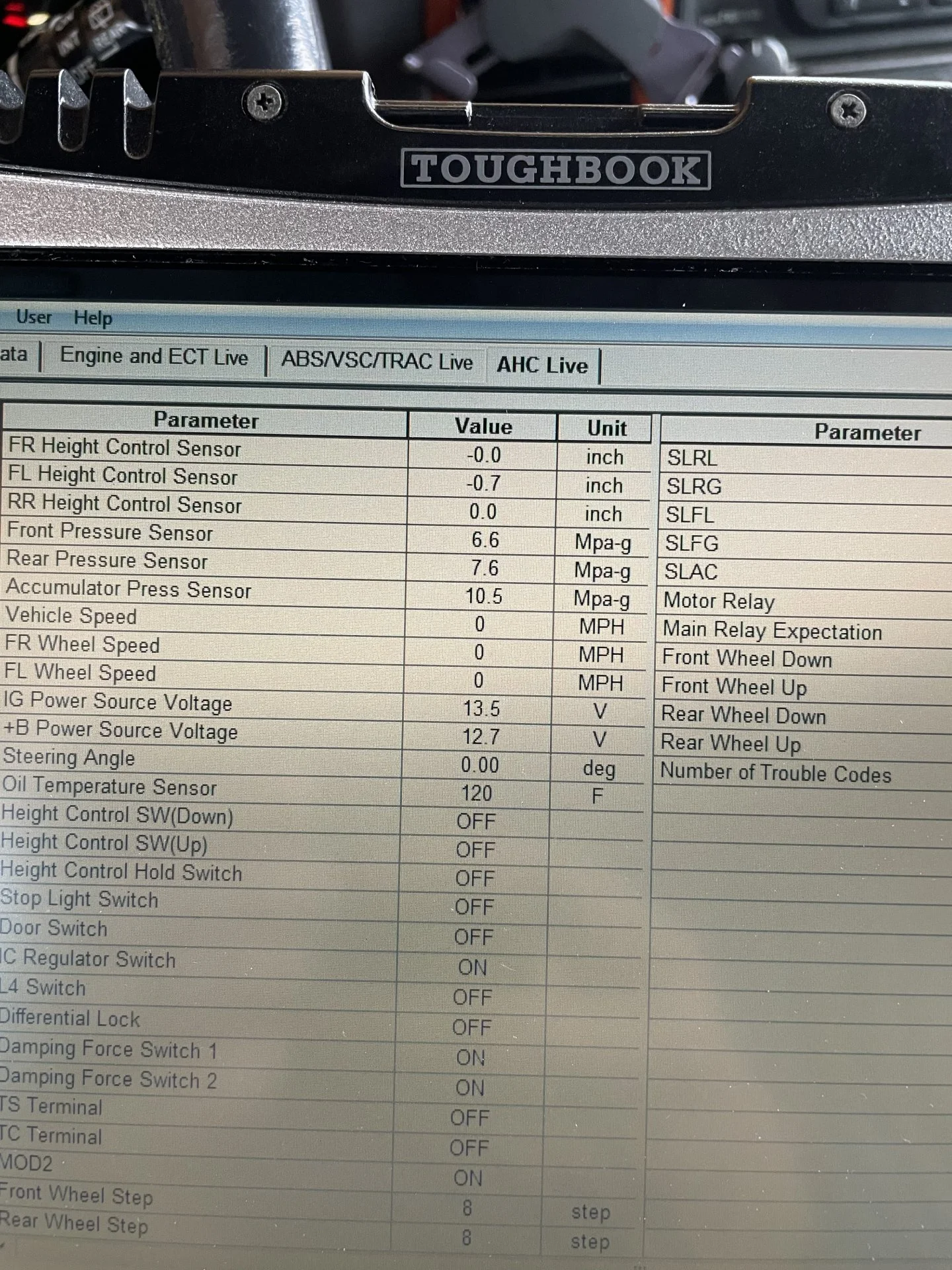

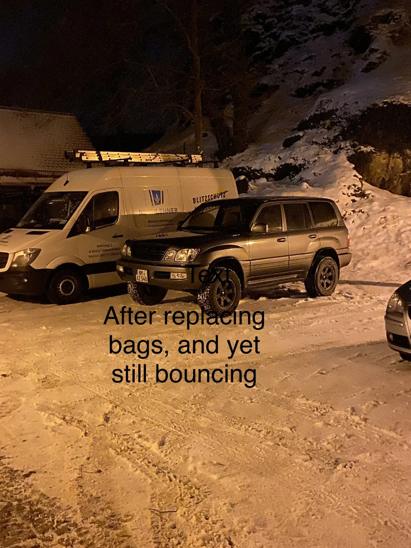

Hello from Bavaria, Germany everyone,
I need some serious help please.
I just replaced all Four (bags), with brand new ones (purchase them from a gentleman in England).
I have also replaced almost all suspension components (too many to list).
I have flush the system (AHC). Twice within the last 30 days.
Problem:
I still have a bouncy ride, what can I do?
Will adjusting the torsion bar eliminate the bouncing in the rear? If so how May I approach the fix?
Thank you,
Alex

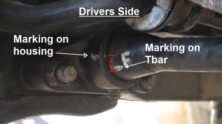

As others in this thread have noticed, rotating the drivers (left) side torsion bar counterclockwise is incorrect. Since the adjustment arms point towards the inside of the vehicle and the goal is to increase the distance between the arms and the threaded blocks above them, the arms (which are attached to the rear of the torsion bars) must go downward. That means the left side must rotate clockwise and the right side must rotate counterclockwise.
Once again, this is incorrect:
This thread is very helpful but this oversight in the first post by @Gunney should be amended.
This thread is very helpful but this oversight in the first post should be amended.

Yup. The same thing happened to me. I blindly followed the write up and was perplexed when I put it on the ground and it sat lower than before :doh: Easy enough to fix and if you take a moment to think about how the torsion bar works, it makes sense.
I think the topic is a bit confusing, as it depends on what you're talking about. @GTV is correct if you're talking about direction to offset the splines in the front mount to pre-load the bar. The bar itself rotates counter-clockwise at the adjustment arm on the DS. But that means if you want to pre-load, which means moving the end of the torque adjustment arm DOWN when it is installed (as he noted), that will actually rotate the bar clockwise where it inserts in the mount on the LCA. That said, if you're looking at the adjustment arm from the front and offsetting it there to add pre-load (which is the angle you're looking at it if you're trying to line up a spline with the master spline on the adjustment arm), when you move the end of the arm down to get the pre-load you're rotating the arm counter-clockwise :) Ultimately I found the clockwise/CCW stuff more of a pain. At the end of the day if you want preload you move the end of the adjustment arm down, regardless of passenger or driver side. Turn the bar in the direction that moves the end down more and not up more and you'll always get more pre-load, which in turn lifts the front.
Sift through this thread and you will find them. I wasn't the first to notice it.
Yes I noticed that but I didn't really understand what they were saying. You explained it very well.
I understand what you're saying but this is flawed. Equally flawed would be to say if you're looking at the vehicle from the front then the drivers side (US) is the right side. It is not. SOP is the drivers side is the left side as you sit in the vehicle and the left side torsion bar needs to rotate clockwise from the same perspective.
The photo I reposted shows the left side torsion bar reindexed in the wrong direction, plain and simple.
