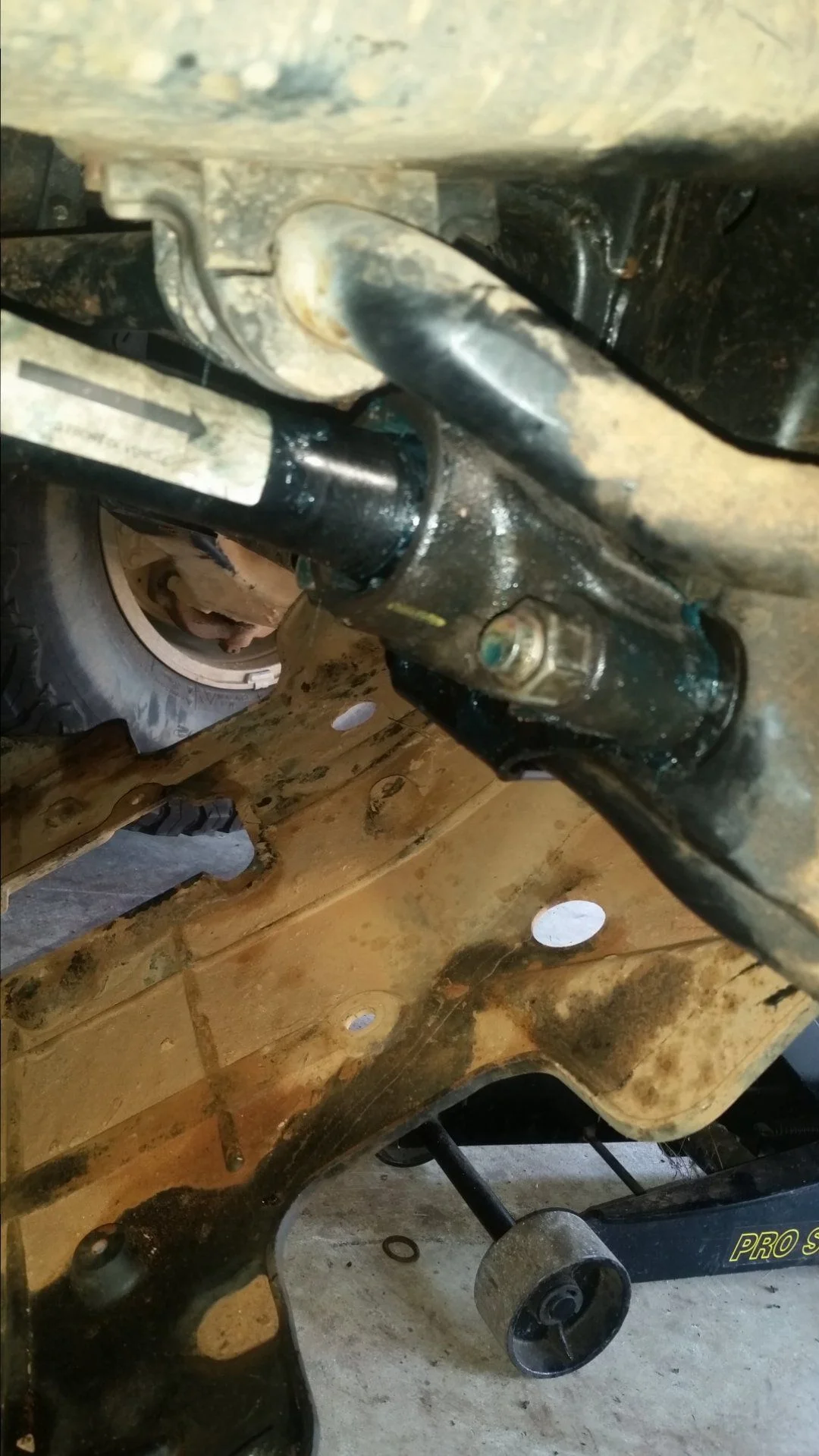

Got one off! Direct hits around the arm where the trick!

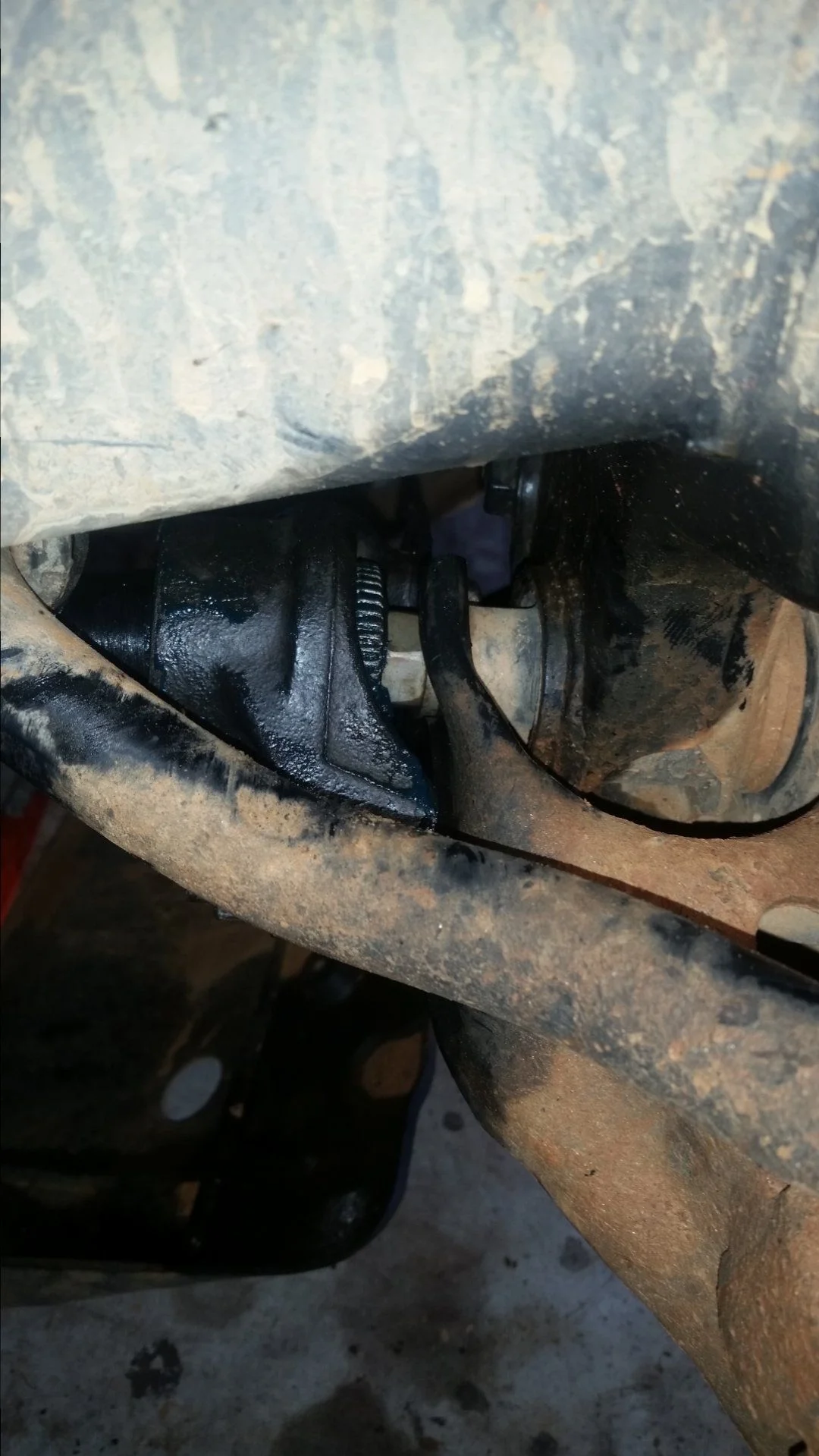

R driver L passenger on these Tough Dog tb's?
Tb's in, something doesn't look right? Ideas? The backside of the tb is hitting the a arm bolt and it doesn't seem to be coming out (toward rear) far enough to make good contact with the teeth.
Got it, just needed a little more muscle! Thanks J, beware of air pockets! Who knew, right!

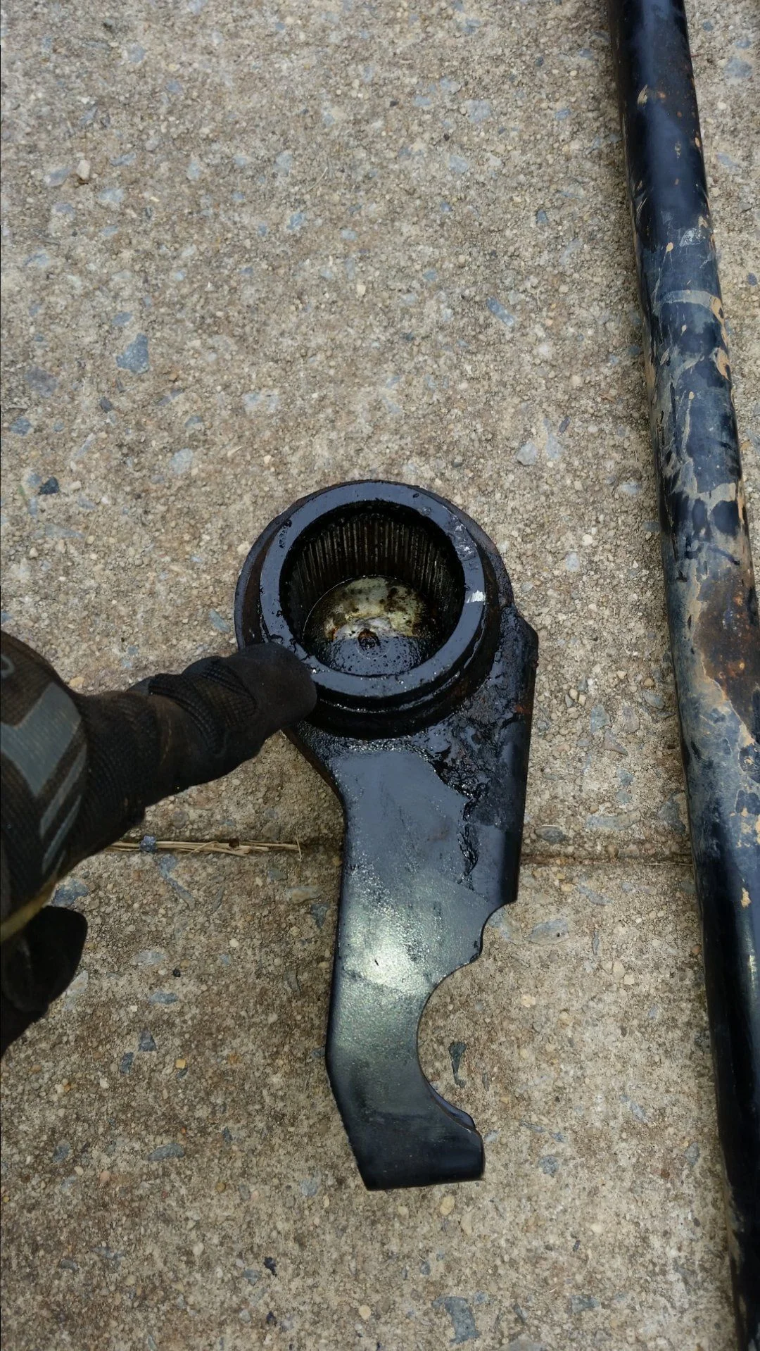

If we're installing new T-Bars and completely removing them from the front and rear housings, do we still need to do all of the indexing and marking with white pen?
AAR:
Now that I've done the job, I realize what a stupid question that was :) Also, huge kudos to this thread. Once you're under there, it'll all make sense. Fortunately, I didn't have too much problem. The 30MM moved very easily, and so did the 2 nuts on each anchor arm towards the front of the car.
I must have given them a 15min "soak" in PB Blaster before the job, but for a New England car I was really expecting much worse.
All it took after that was a little persuasion with a punch and small hammer to get the anchors off the spline, and it was just as easy to "pull" the bars out of the rear mounts.
Thanks to OP and all for these posts.
