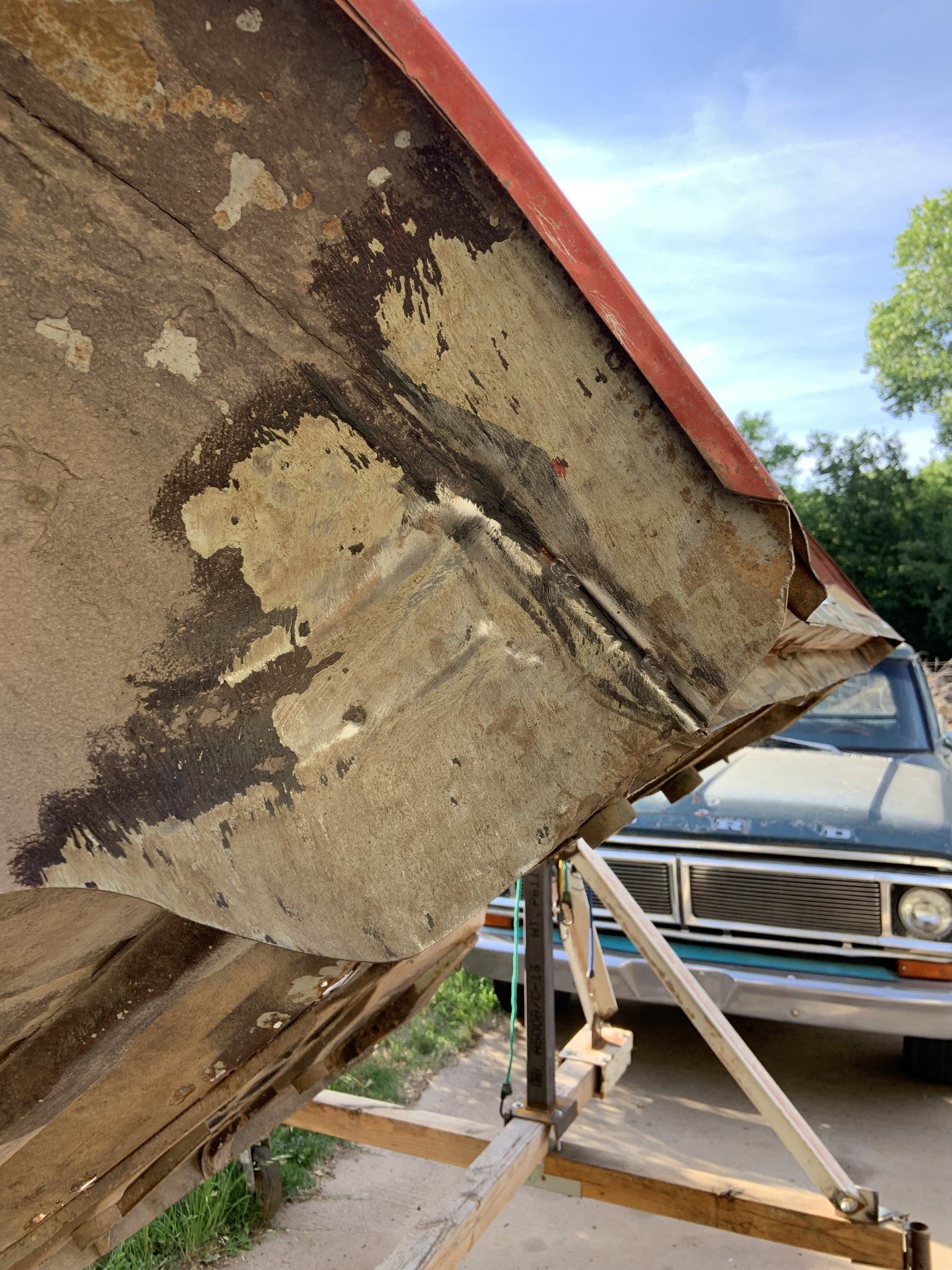

I have one of those contraptions with a rubber eraser-like wheel on it for removing decals. It works great! I think you'll like it. Having the little "fender" on it will be nice when you are stripping undercoating.
So this tool is great! My issue now is not having a big enough compressor to keep up with it. With enough air I could have all the undercoating stripped in a easy day. The rate I’m going now, it’ll be a few days, hopefully not burning up my compressor in the process.
The after shot is first thanks to Mud’s random picture posting feature. This was after two short trips down to 50psi.

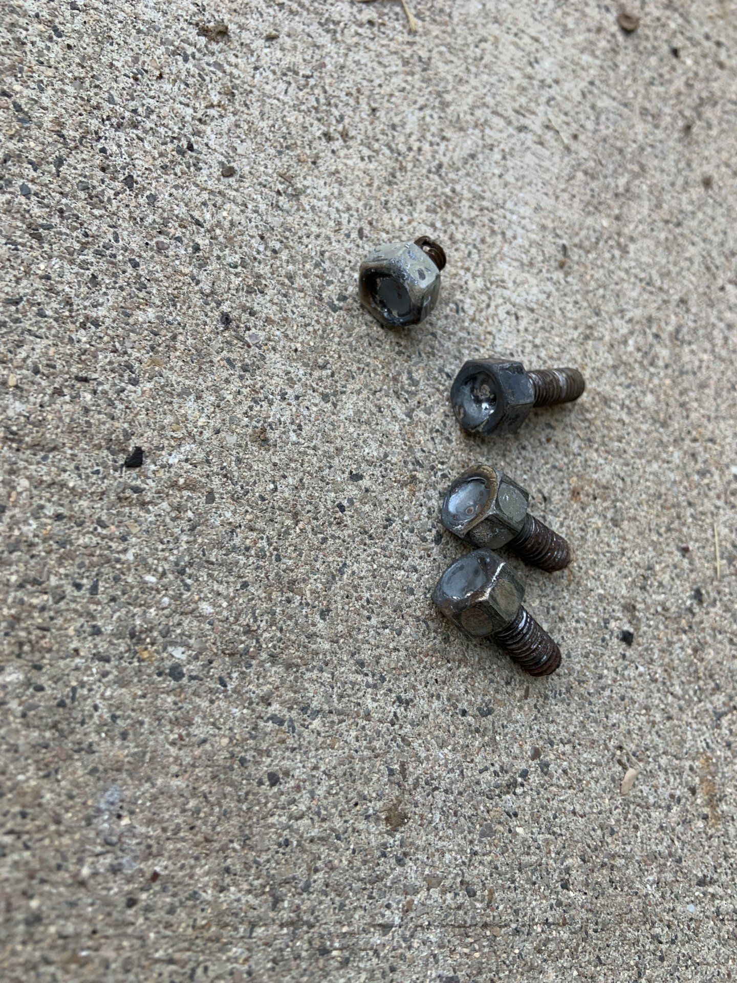

A lot of mine are missing as well, but I figure it's good to have places to stick a hose in to flush out the sand, mud, etc. The plugs are different sizes, if I remember correct.

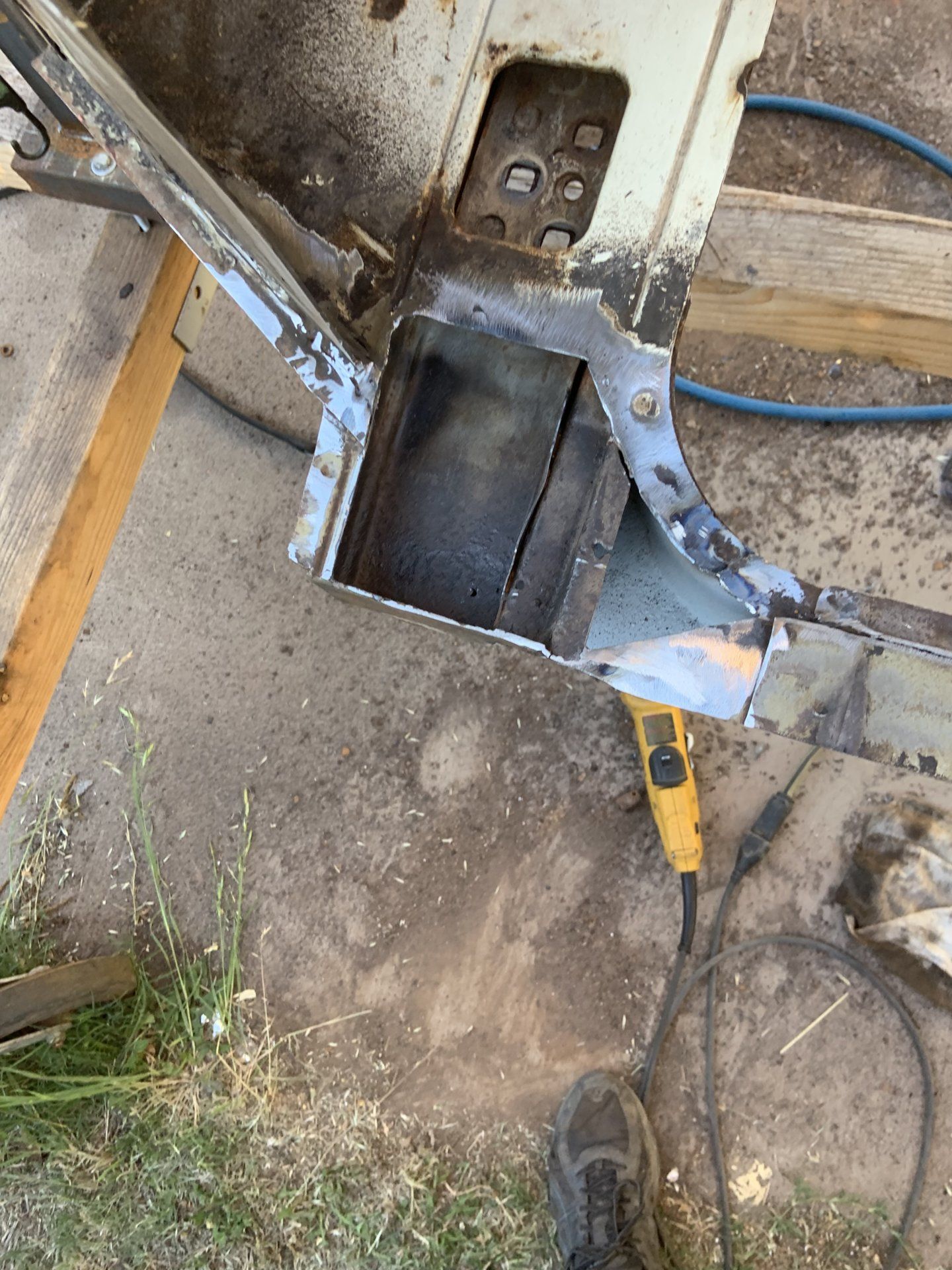

Tore into the passenger side floorboard. Removed it and the tub mount together.

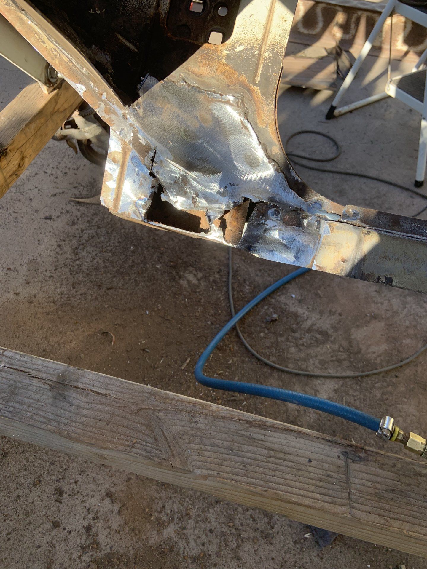

Found some rust waiting in the bottom of the lower portion of the A-Pillar where I’d done a RUSH-job patch years ago. Cut the patch out and cleaned out most of the scale and debris. Need to come up with a way to clean that area out somehow that doesn’t involve the debris going into the new caps or tub mounts. Amazing how much dirt collected in there. May just have to throw a cup of engine oil in there after every oil change.

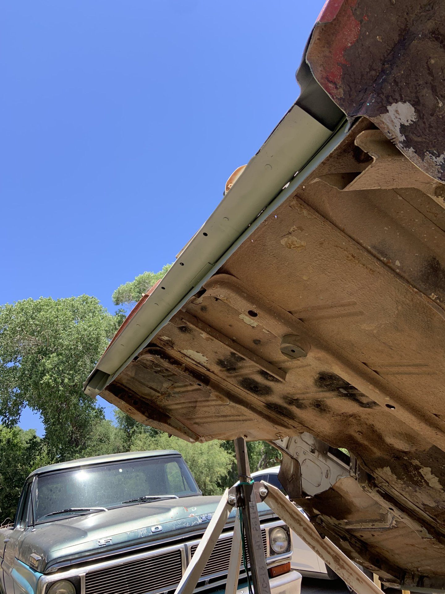

Have I mentioned that I love having this rotisserie? Yeah, I love it. So sweet to be able to rotate it back and forth to where I want it.
