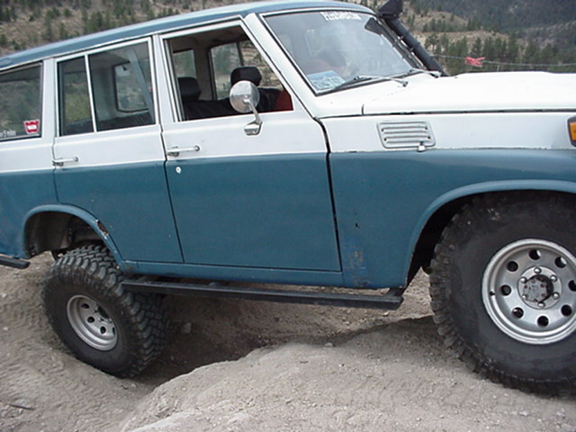

I had to dig into the Time Machine to find old photos of my 🐖 and my slider setup. It was welded to the frame and stout. Photo quality courtesy of a potato.
I will agree they could have been a bit wider for steps though.
One of my favorite rigs from back in the day 😍
