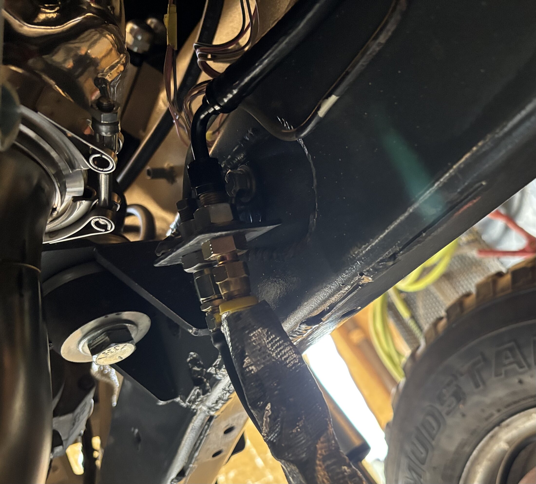

Made some new frame side brake line mounts with extra space to add 4AN bulkheads for the vent lines coming off the axles.

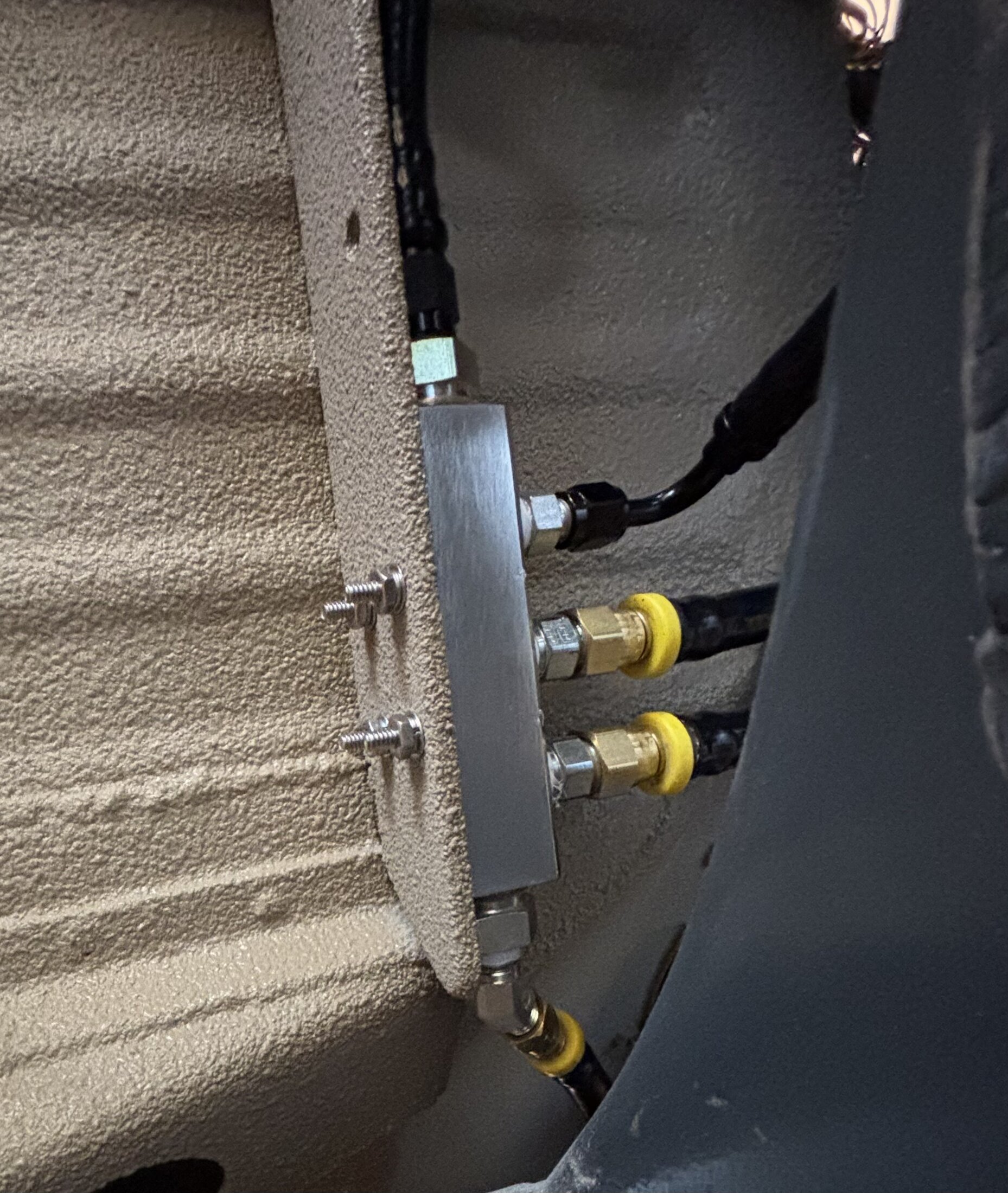

Mounted the little aluminum manifold on the inside of that little sheetmetal strip on the bottom side of the passenger floorboard.
Ran a hose up to a little mount for the breather behind the batteries.
