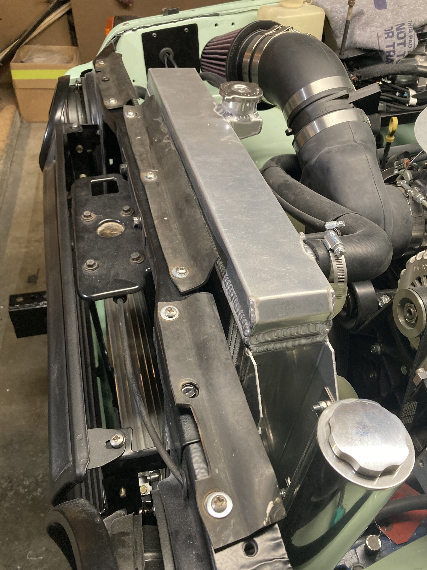

Rush, I wondered why you went with a rad. with the inlet over there, any reason?
That’s the Mosley radiator. Thought it was supposed to be one of the best ones.🤷🏻‍♂️
Ron beat me to it. I think you need a different radiator; one that's set up for your LS and not for a 2F.
@xtiaan2000 is using the same radiator.
I think the bigger points with it, is its design is based on an FJ55 radiator with all the same mounting and factory shroud mounting, and
they intended for it to be used with an electric fan setup.
Some of the other radiators people have used for this application are more of a universal fit which require mounting brackets to be made and don’t have integrated shroud mounting points. I’m not sure if anyone is running a custom Ron Davis radiator or something like that. I don’t have part numbers or links to any other radiator.
Good points. Sounds like you might be swapping a known problem for many unknown problems if you swap.
