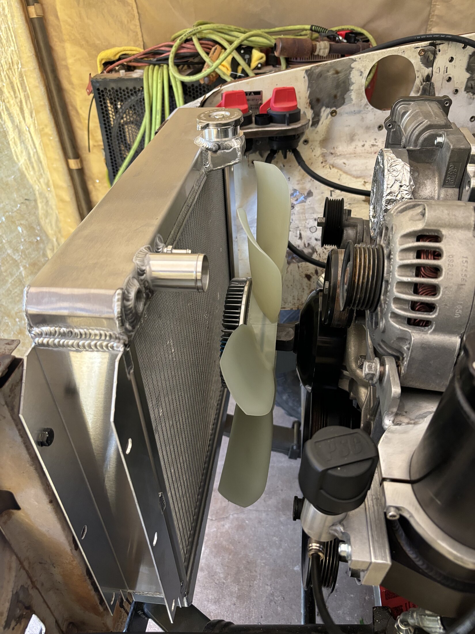

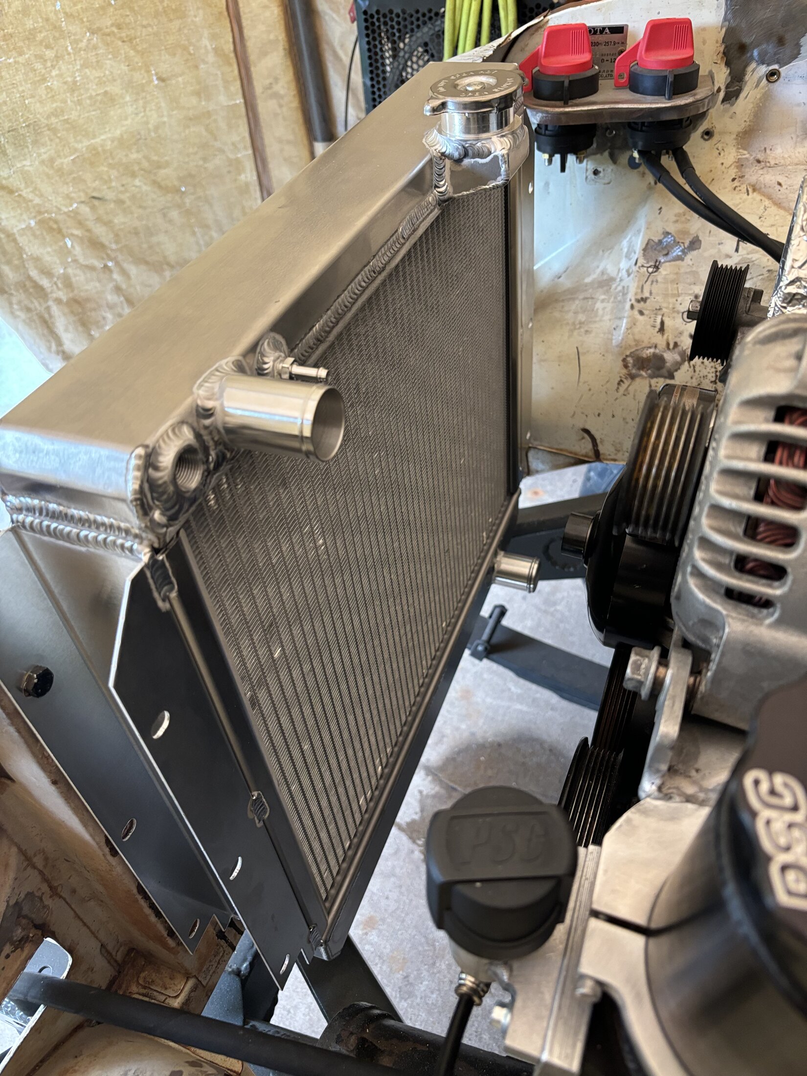

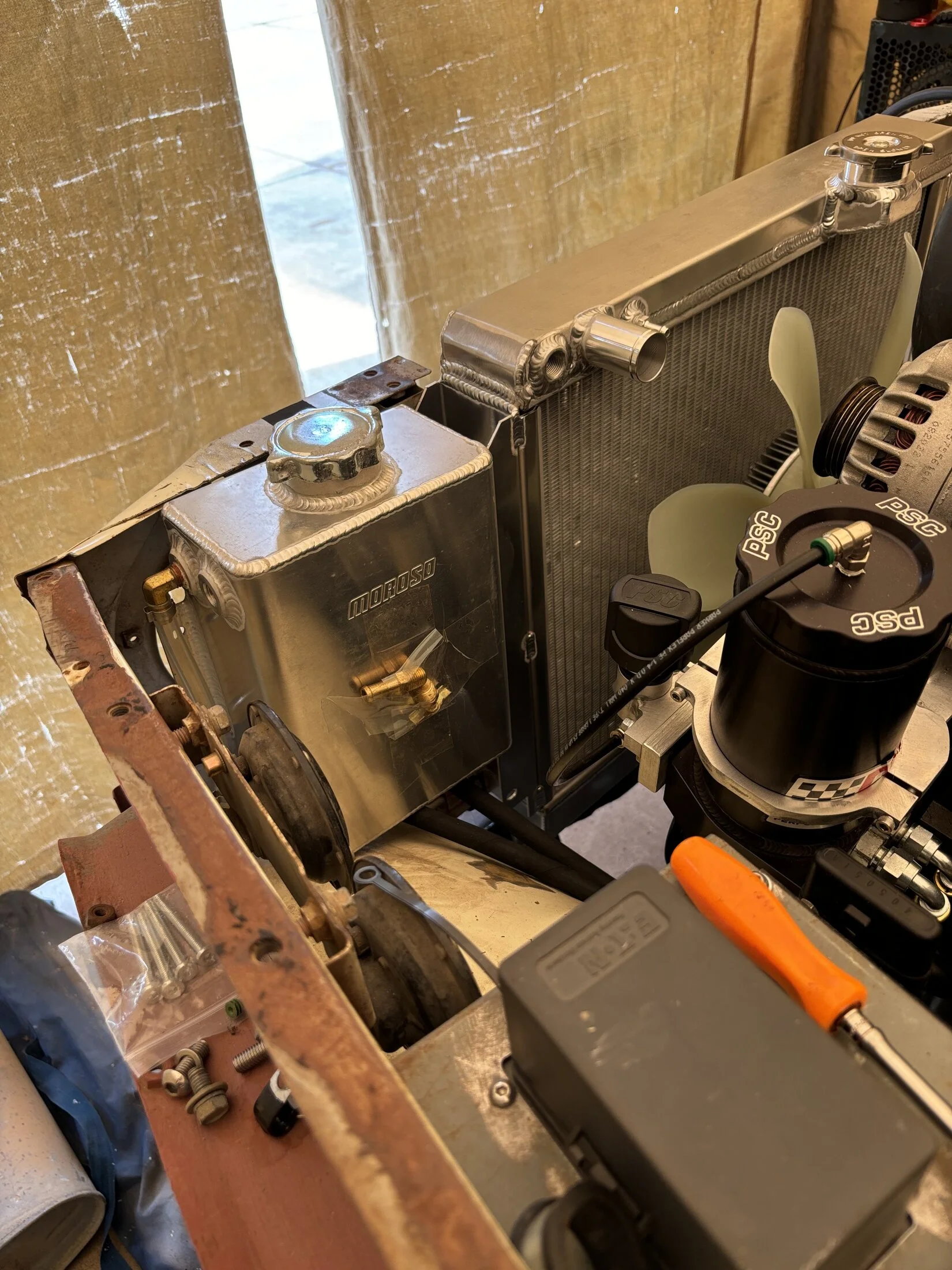

FSR got the correct radiator to me yesterday!🥳
Mocked it up in place along with the new fan and fan clutch. Looks😎

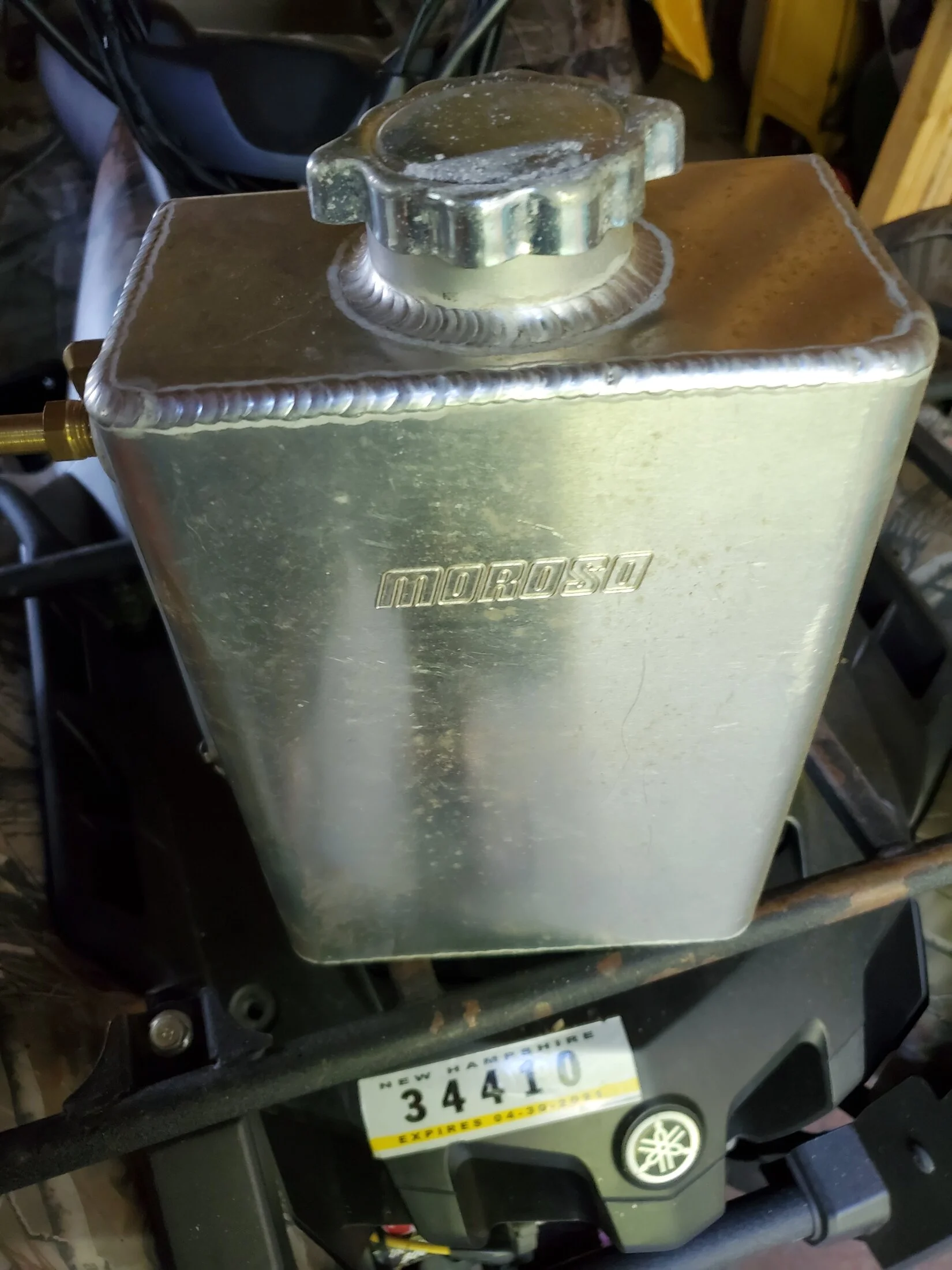

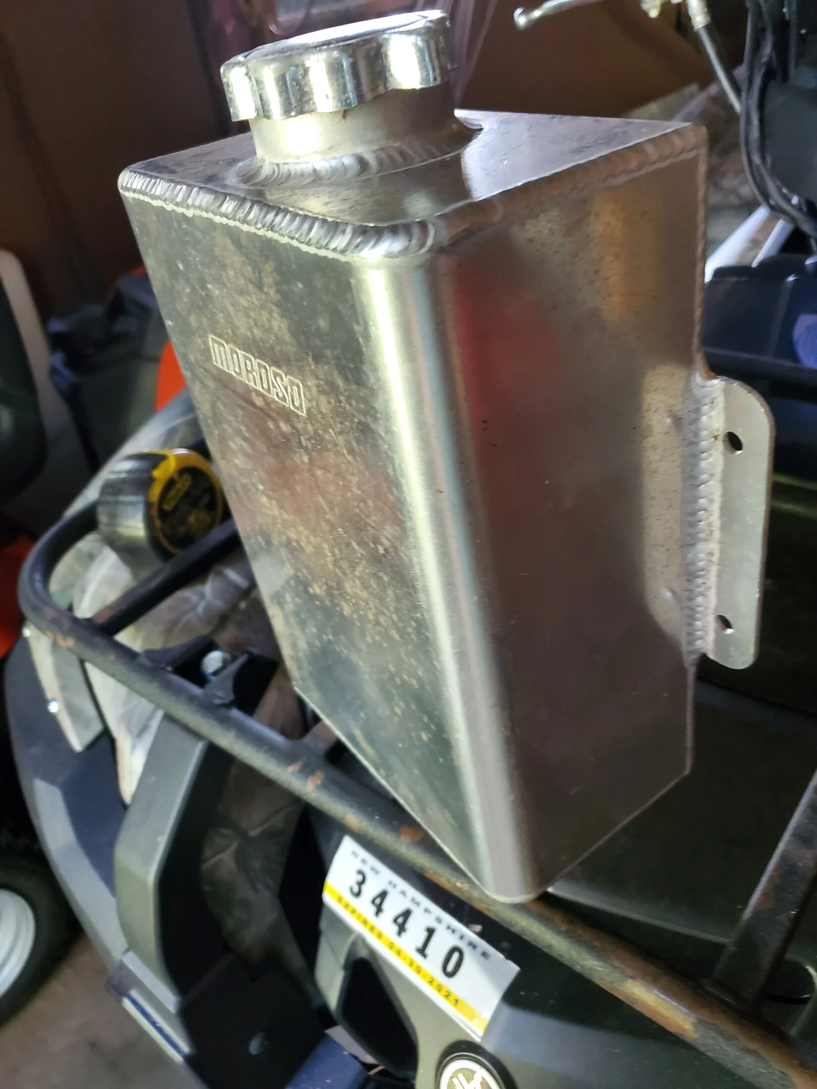

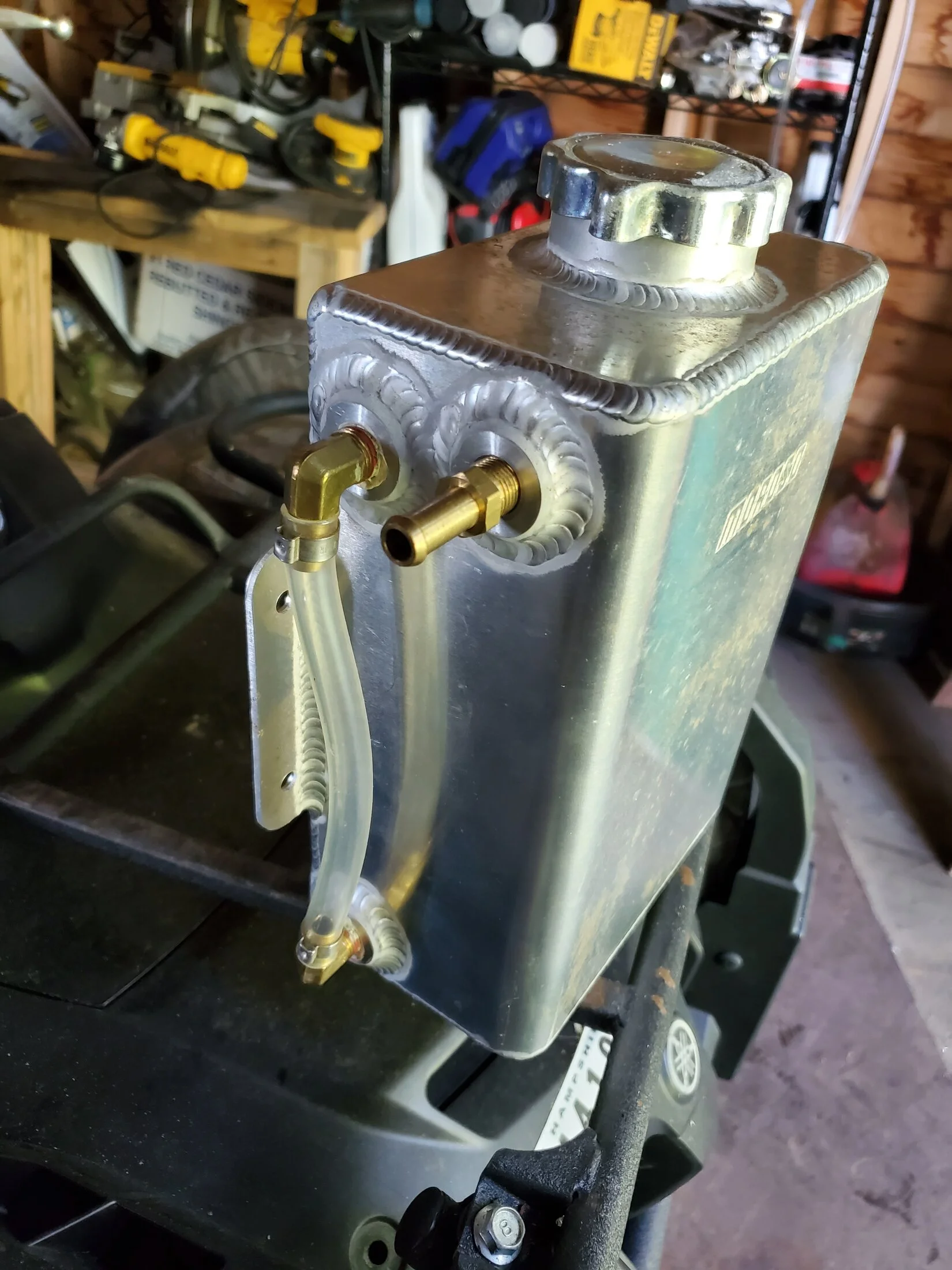

Need to get an expansion tank and some radiator hoses next.
Hoping to get some pics of some other things posted this weekend.

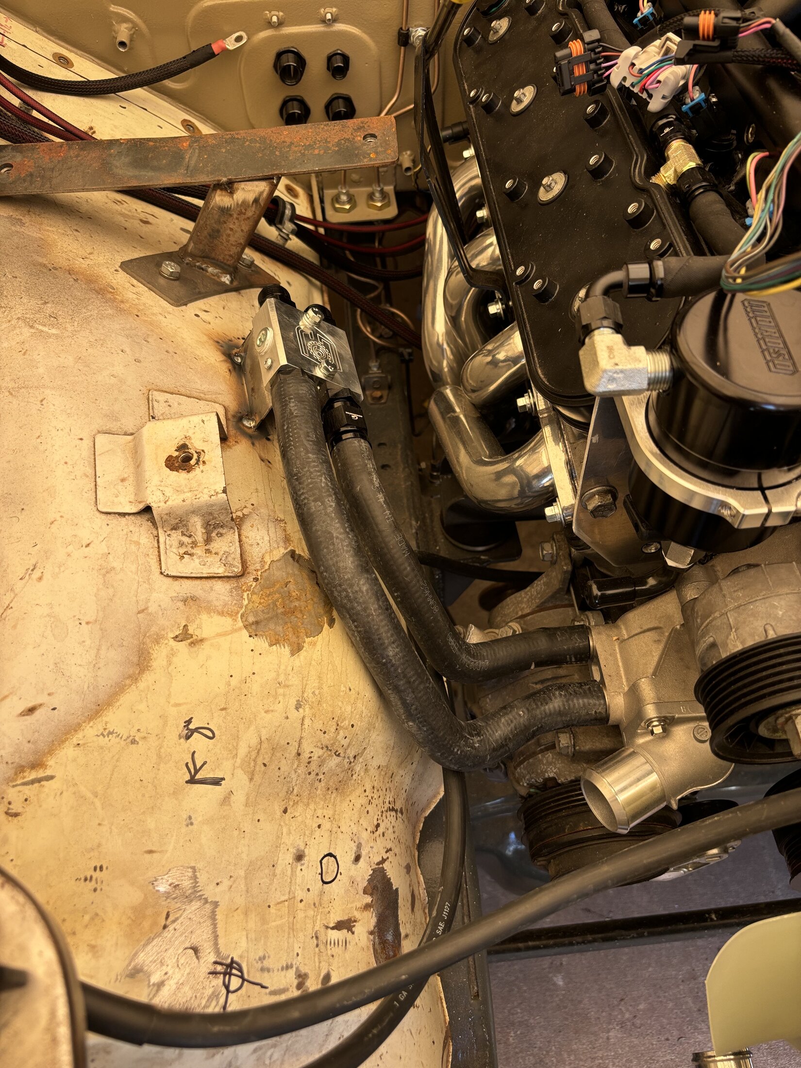

The other thing to post about is this little heater hose cross flow block.
Something I found out recently that may be of benefit to others who may be considering an LS swap in the future is that you aren’t supposed to simply block off the flow of coolant through the heater hoses. It always needs to be circulating or else it causes cavitation in the water pump. Well I’m not ready to hook up a heater, and depending on how the heater core and AC evaporator are oriented, sometimes it’s beneficial to shut off the flow of coolant into the cab during the summer. Anyways, instead of rigging up a bunch of valves and wonky plumbing, I found this block from a company called LOJ that allows you to block off the flow through the outlets and the coolant can flow back through the return to the pump.
Still have a couple fittings to get, but you get the idea. The outlets will be capped off in the meantime until an AC/heat unit gets installed.
