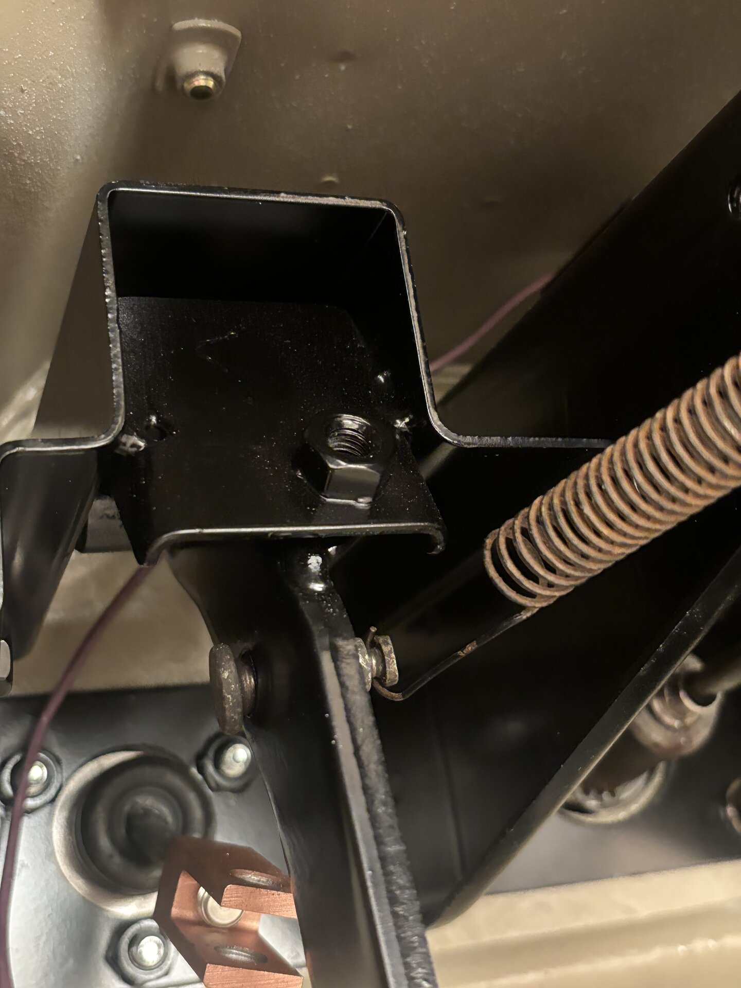

Is anyone running a neutral safety switch on the clutch pedal?
Mine never had one, but the pedal bucket has provisions for one, so I’m considering wiring one in. Also can’t find a specific switch for that so am thinking it might be the same as the brake light switch?
*Not finding a clutch switch in any wiring diagram either 🤔
I looked at the European, Japanese, and General Country parts diagrams for a 1979 model and didn't find any clutch switch. Provision notwithstanding, I don't think there ever was one. Quick google search says it was early 1990s before a clutch safety switch was mandatory.
Not sure I’d like that, has been times I’ve bumped a vehicle in gear on the starter…similar to Bob’s friend, limits your options for sure. 🤷🏼‍♂️

Mystery solved I think. It’s for a bolt to adjust the clutch travel on the upside.
Here are the part numbers for the bolt and the cushion that goes on the pedal.
31301BCUSHION, NO.1(FOR CLUTCH PEDAL)
90541-060081
31301CBUSH(FOR CLUTCH PEDAL)
90386-130072
31301FBOLT(FOR CLUTCH PEDAL STOPPER)
91131-508251
31321PAD, CLUTCH PEDAL
