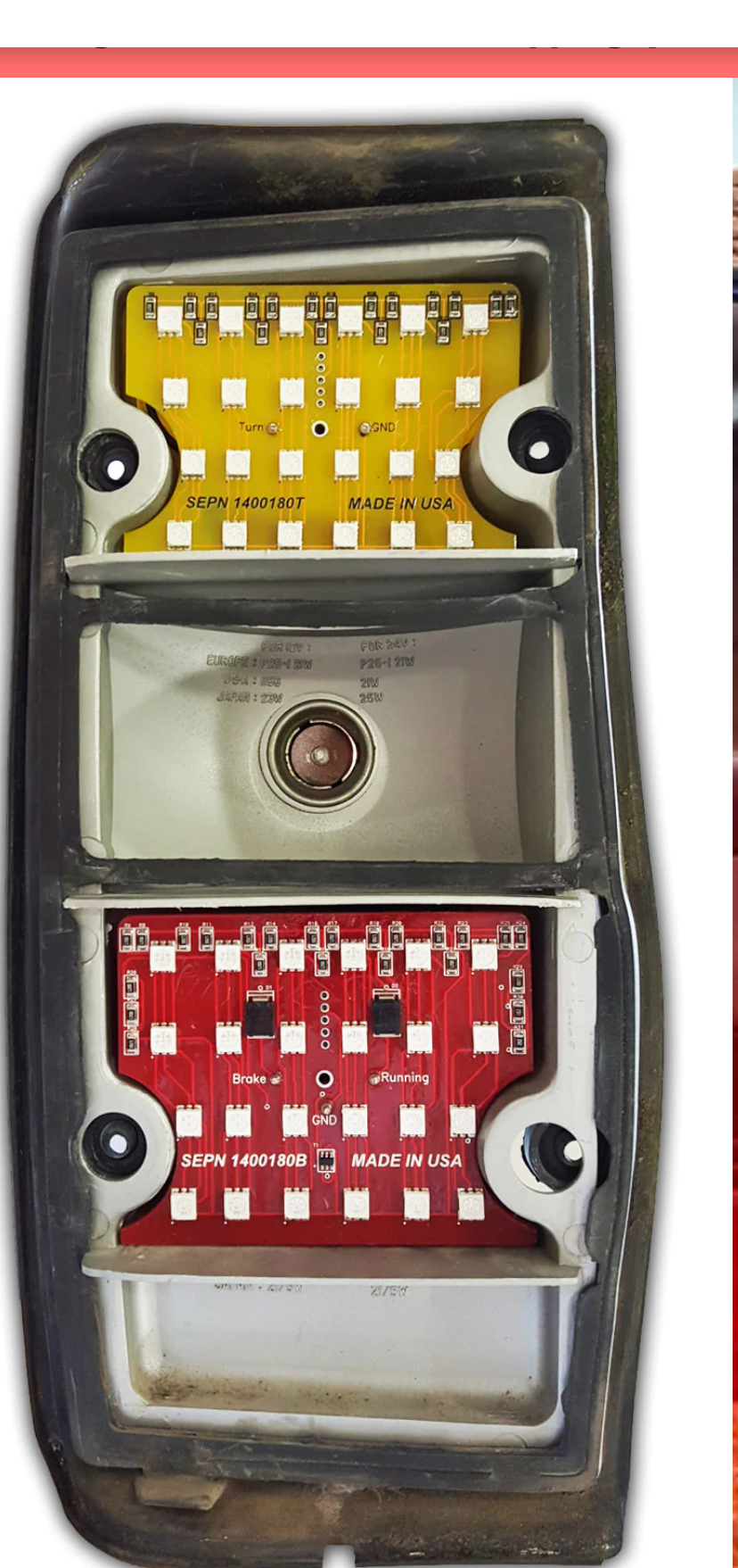

I think a couple here on Mud use the Digi-Tails tail light panels. I've been planning to go with these when I pull apart my assemblies to clean them, put brighter reverse light LEDs in and put LEDs in the front turn signals.
I have the Digi-tail light panels for my rear lights. They worked great and no problem with blinker relay. They are very bright!

Check these out….. I think they are same as digi panel

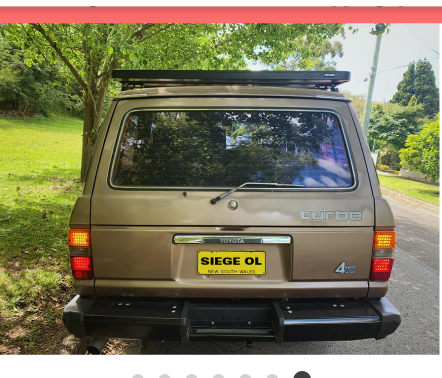

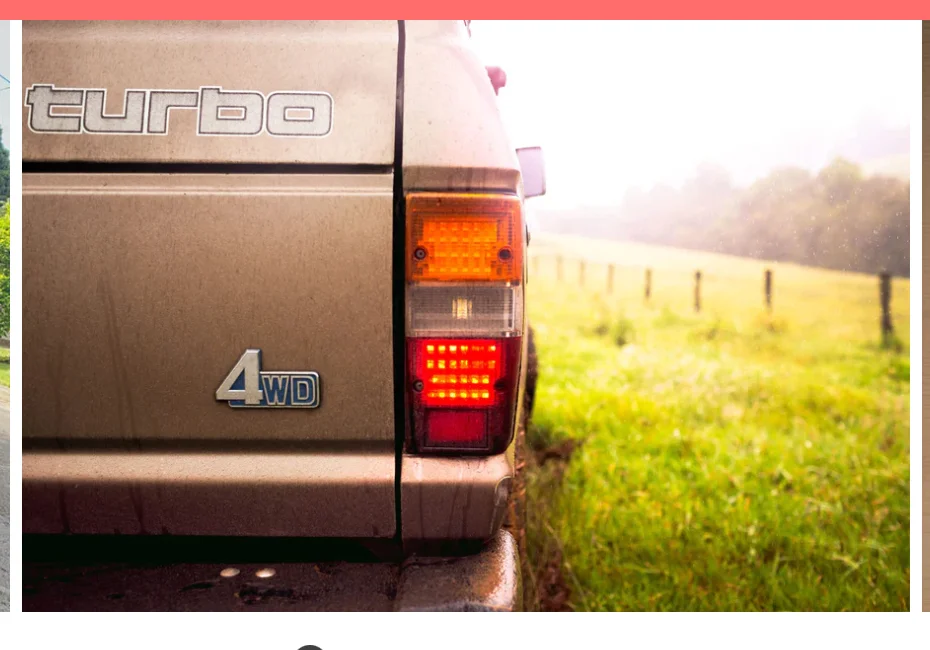

PRE-ORDER: LED taillight bulbs kit for 60 Series Landcruiser - By DigiTails - https://siegeoverland.com/collections/lights-lighting/products/led-tail-lights-60-series-inserts
I wonder why these are listed for $204 while the 12V ones direct from Digi-Tails are still listed for $149.

Do I need this OEM Flasher if I use the Digitails LED lights? Or in your professional opinion are the SuperBrights the way to go. Thanks for the help!
I am not sure if the digitails have something built in to accommodate a stock flasher or not. Does their documentation mention the need for an aftermarket LED flasher module?
Personally I don't like the look of a grid of tiny LEDs, hence I went with LEDs in the shape of regular bulbs. No issues with the SuperBrightLEDs products thus far and I've been using them in a few vehicles over the course of the last five years. I don't know if the Digitails have any kind of noticeable failure rate, but I haven't heard of them. That would be something to look into. Otherwise it's a matter of taste!

I did not need a flasher for the digi tails. I did need a flasher when I changed my forward blinkers to LED bulbs. The digi tails are bright!! you will be seen with those tail lights.
