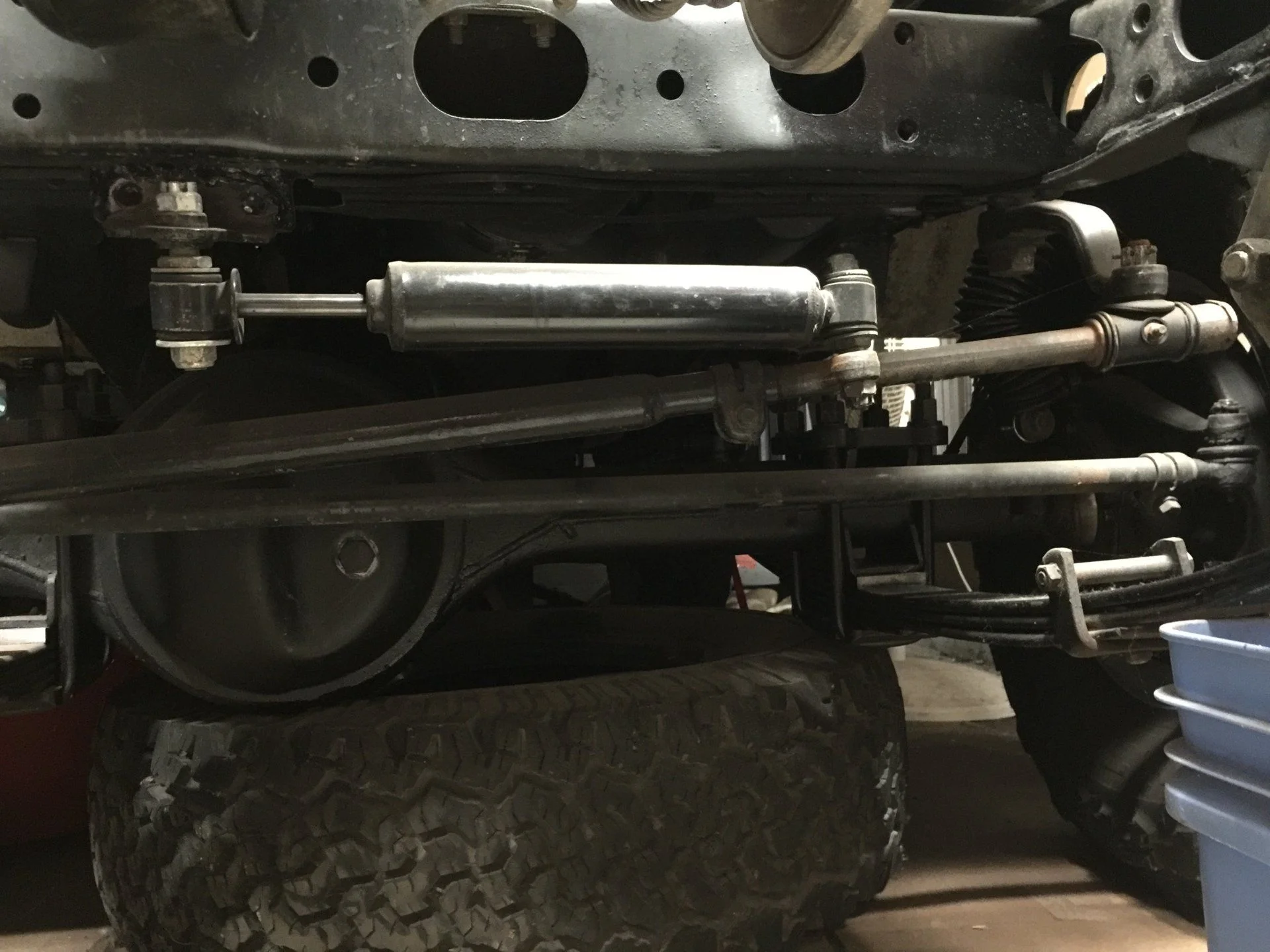

I did have a very minor but aggravating shimmy felt while taking certain curves at speed. I ended up using a Monroe shock that was the correct length (compressed and extended) but had to get creative where it mounted to the frame. The factory FJ40 damper connected to the center arm so the damper was designed to attach from behind the mounting flange on the frame. Thus, the mounting flange hole was bored with a conical taper to accept the mounting pin.
When I tried to mount the damper to the new FJ60 relay rod end, the geometry put the damper in too much of a bind under compression (full passenger steering input). So, my solution was to attach the damper to the frame from the front of the flange. The only way to do that was to re-bore the taper to the mounting bracket from the front of the frame hanger. I picked up a taper boring tool on eBay and used a corresponding taper shim on the opposing side to remove the old taper. It worked like a charm.

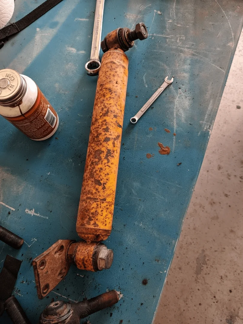

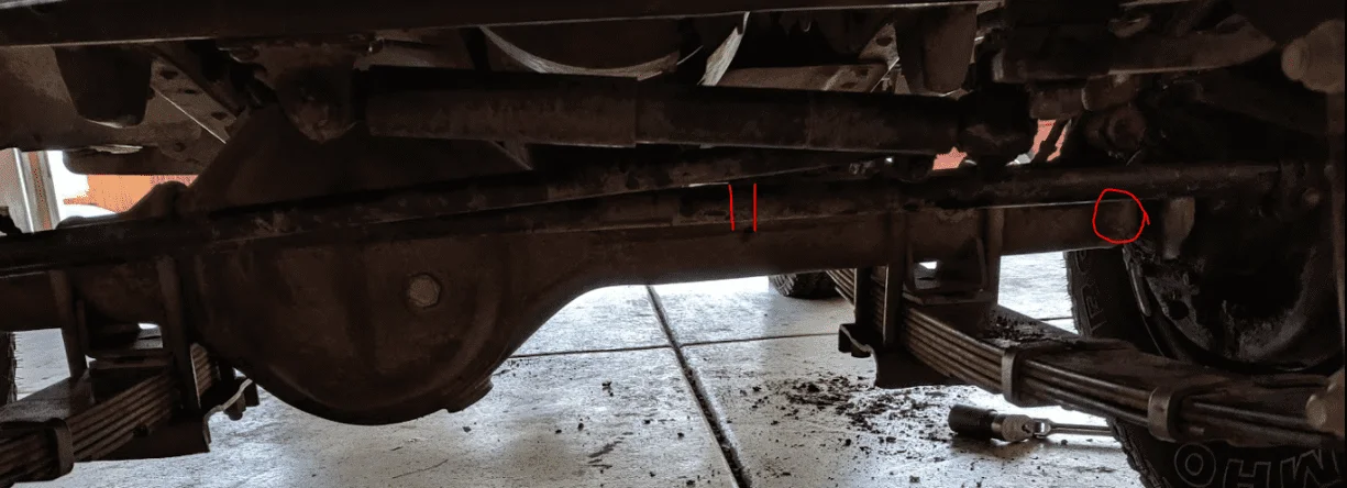

Not sure if this is relevant, but I pulled off an old damper set up that wasn't stock (possibly man a fre) but it bolted one end into the little bump stop ring on the axle and the other end had a plate that bolted to one of the tie rods. Here's the best pics I could find to give an idea. Not sure if it gives you the same amount of dampening but you could try something like that if all else fails. Wouldn't require welding anything differently.
I never thought it really needed it but removing it, I think I noticed a little difference so I may put it back with new shock eventually.

I installed Monroe SC2915 steering damper and took the mounting hardware from Monroe SC2946 damper’s box. Fits nicely.
