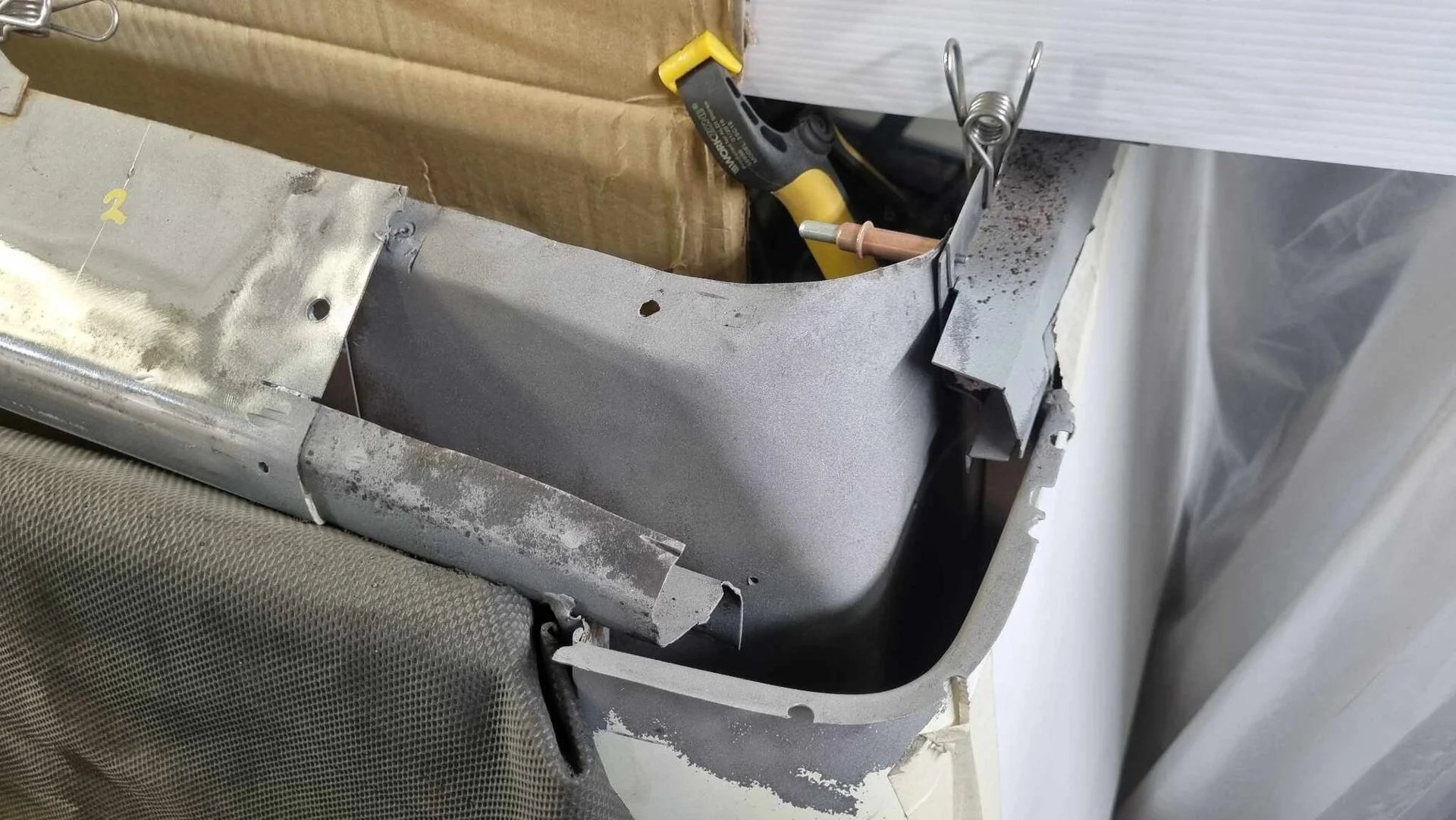

Moved onto the rear section of the roof.

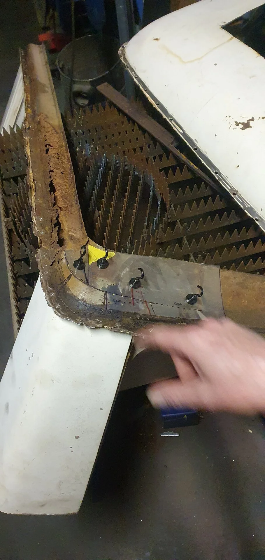

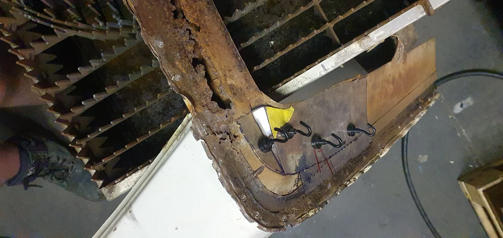

Cut out the rust. Now to make some replacement parts.
The roof isn't square, infact the roof is wider in the middle then the ends. Just another tricky replacement part needed.

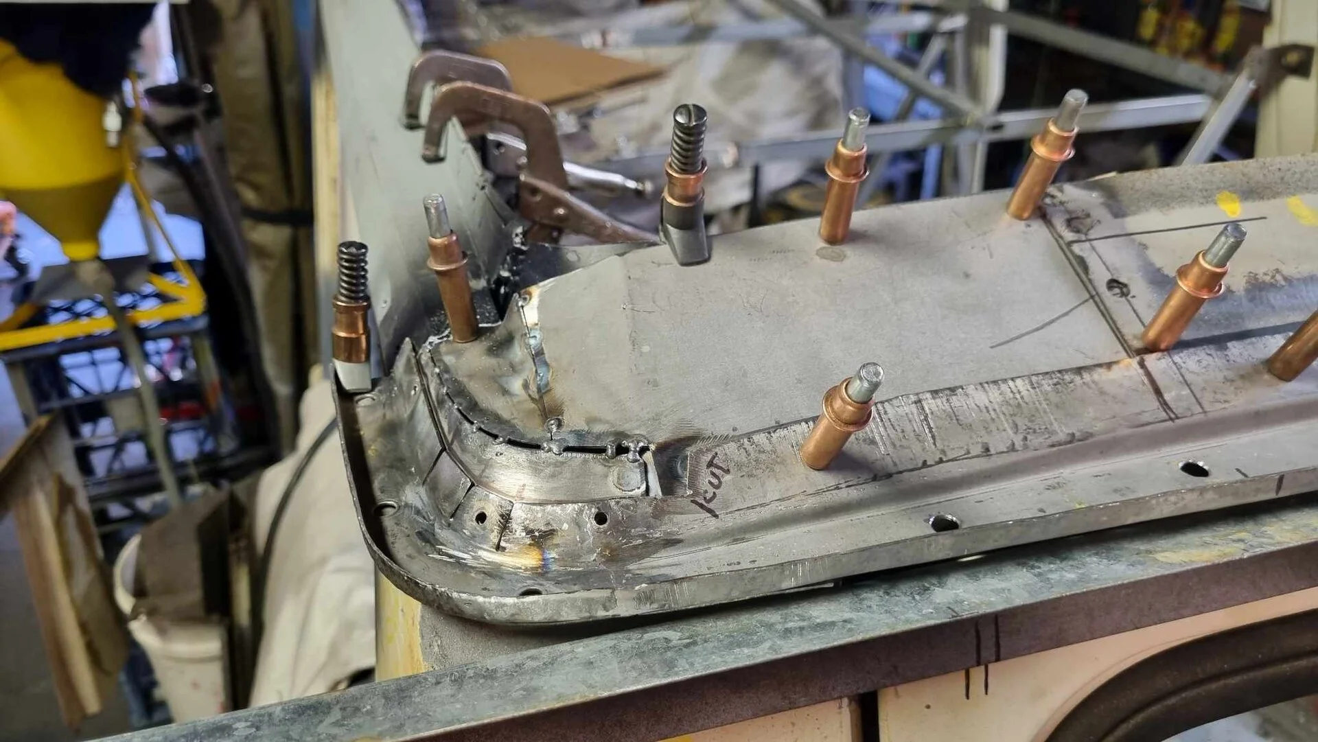

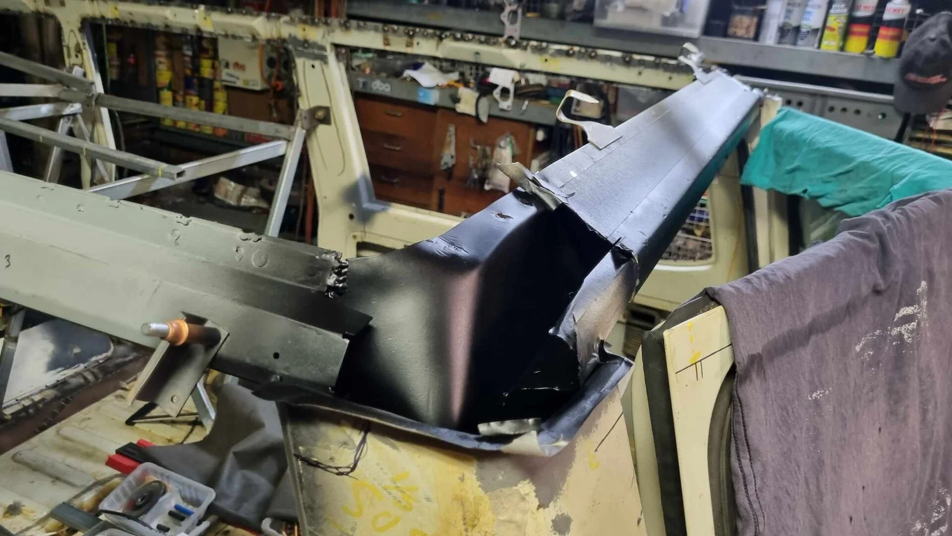

Rear section started. Made a jig with some spare 50x50 box and ground down the raduis curve from the centre profile out to the edges.
Drilled and bolted down to prevent movement.
Tacced and shaped to suit.
Both L/R sections now done, hopefully can make this an easy process. Might be added to our 55 Roof kit.

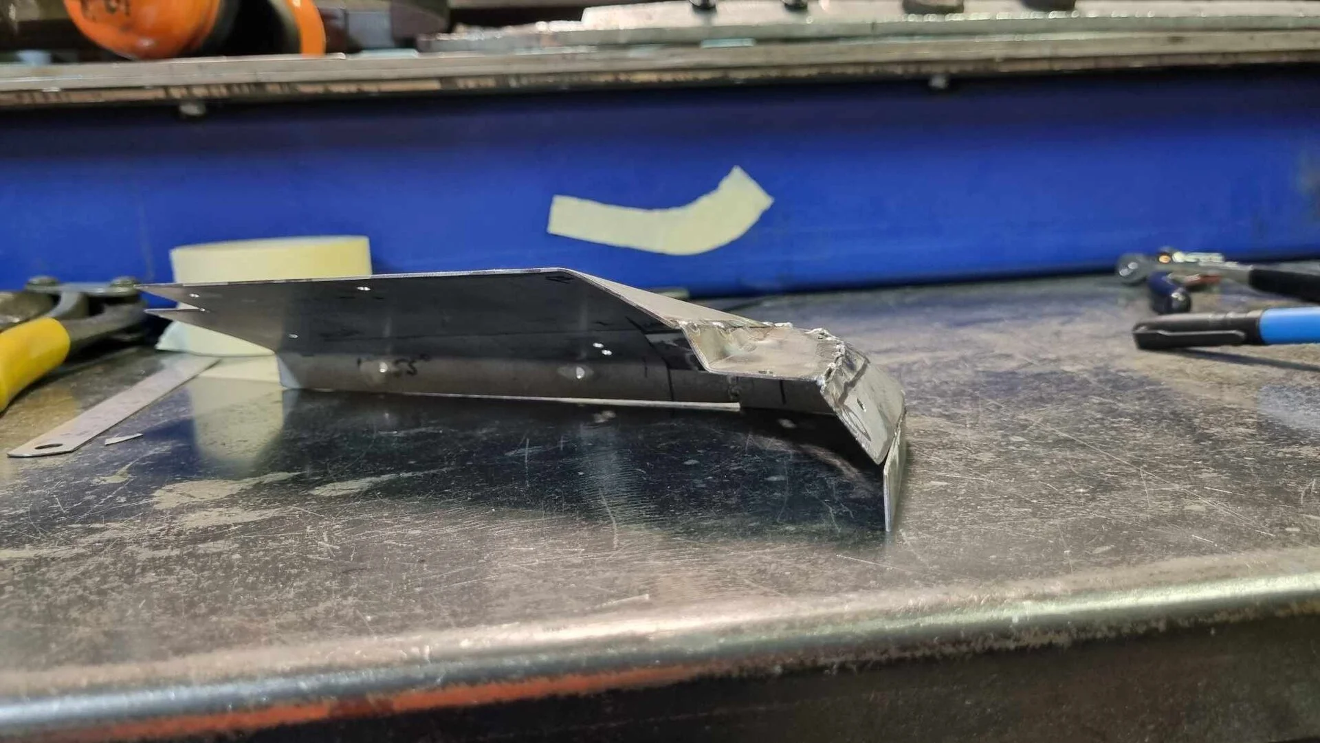

Rear D Pillar inner channel covers.

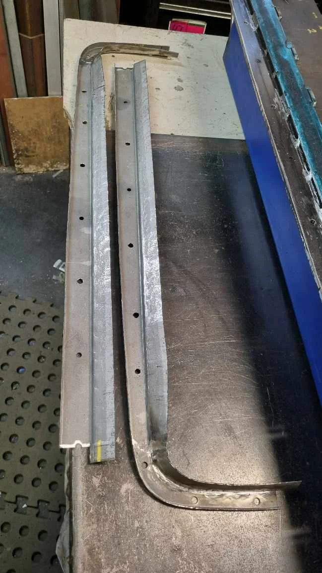

Months of hard work, planning and development are now something physical.
My first FJ55 Roof Channel/Gutter kit has been stamped out for a customer. For me it's super meaningful that I can help another person with their goals.
A few hours behind the tools now to shape and joggle before being sent out.
