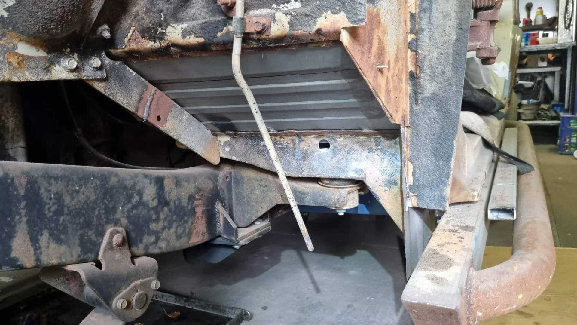

Degreased the chassis and prepped for the Body Mounts to by cut off.

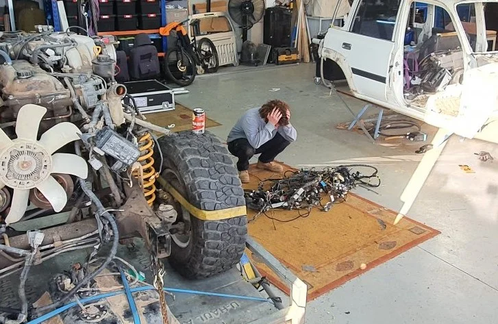

Guy in middle picture dont look to thrilled about that wiring harness 🤔😏🙂
I was thinking the same ting @bobm ! At this point he is thinking about all his past mistakes in life, wondering how it got to this point...

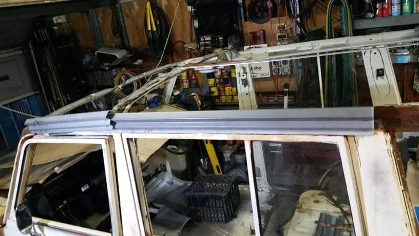

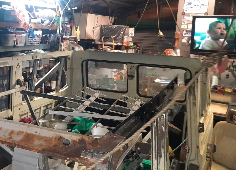

Get to start tearing down ready for the roof and gutters to be welded in.
Are there any links for those who have profiled the roof edges?
Amazing. Even the kid on the web conference is amazed...
I don't recall any threads about rain gutters, but I am looking forward to seeing how yours turn out! You are making new from CAD, yes?

Used (CAD) Cardboard Aided Design.

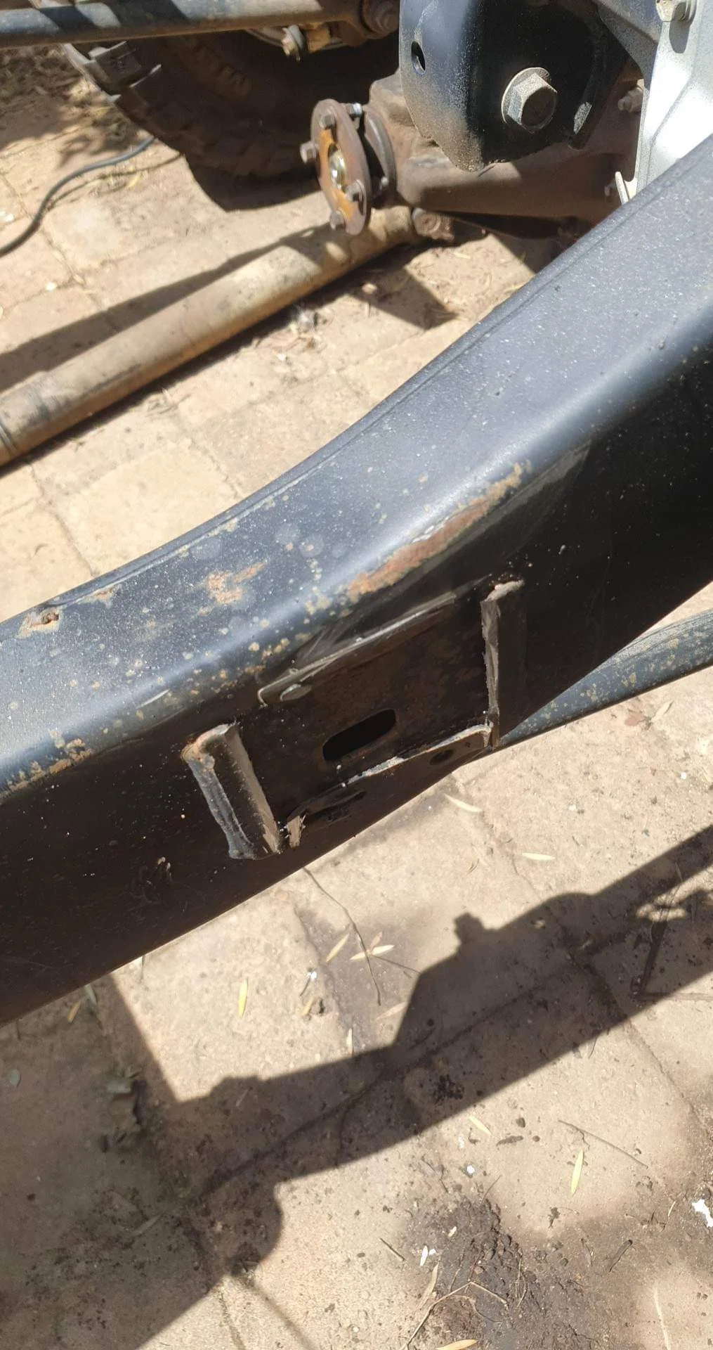

Finally got some time to cut the Body mounts off.
