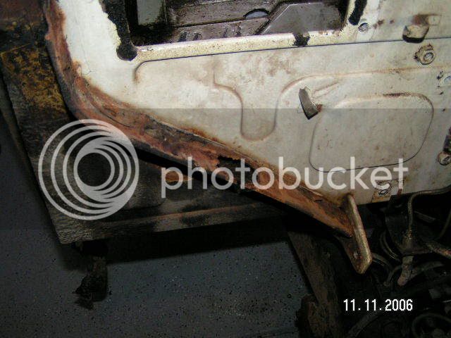

More 55 body work
Some more updates from the body shop.
lower rear quarter from the back
front kick panel drivers side
new rockers panel inners
more of the rocker panel inners
Front clip mount patch
new rocker panel outer

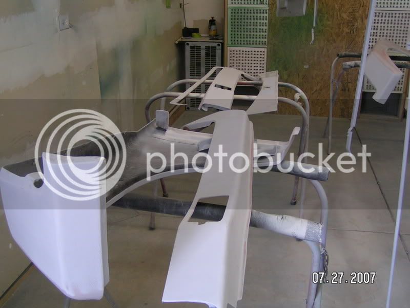

Got some parts from SOR. Some good, some not so good.
The fiberglass fenders should work great. I will get a photo of them next time I visit the body shop.
The glove box door is okay. Somewhat cheap construction, no steel reinforcement inside the panel, could be a weak point. The black rubber finish feels and looks right.
The instrument panel, however, looks okay, but is poorly constructed, poorly finished. The mounting tabs simply screw into the foam, very weak. It does not have the rubber finish of the glove box cover, but is all hard injected foam that is painted black. The paint coverage is inadequate. There are no steel reinforcement on the mounts, and the directions tell you NOT to use some of the mounting hardware supplied :confused: It looks like if you do, you will punch holes through to the front of the panel....
As a mustang guy, I have bought and used several reproduction parts of similar construction and design, but they are of OEM quality or better. I guess thats a benefit of competition in the market. Needless to say, I am disappointed in this part.
I also got the dash pad cover. It fit well, and looks good.

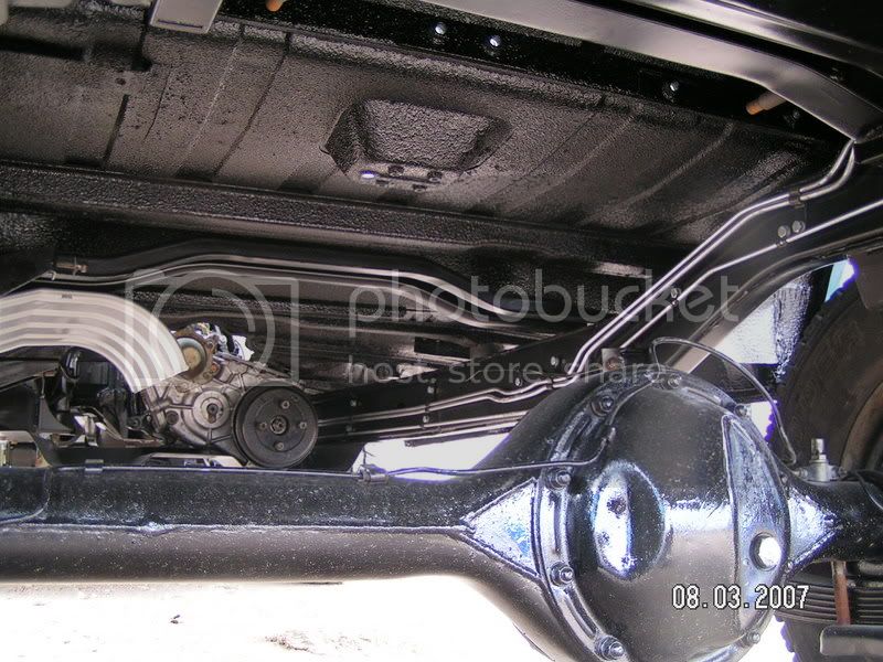

Lots of work today, little to show. Filled all the gearboxes. Greased all the chassis parts. Tightened all bolts. Realized I still have the front springs on backwards. The chassis goes to the body shop to meet the shell in 4 days.
Did put the muffler shield back on
And this one right side of the engine.
And the lower front shield

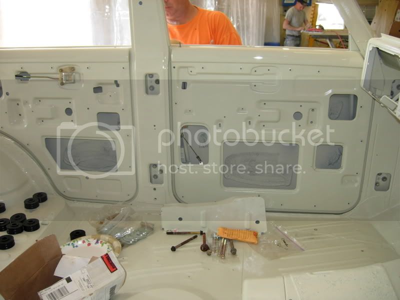

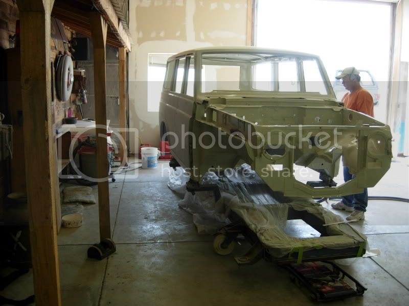

I talked to the body guy today. He said he finished all the rust repair, he counted 71 patches that he had to make. I will take pics when I haul the chassis up.
