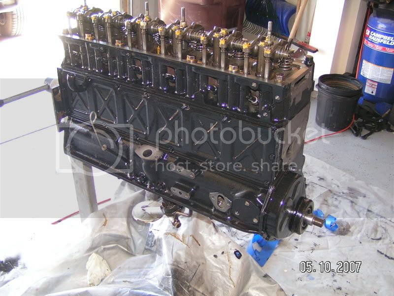

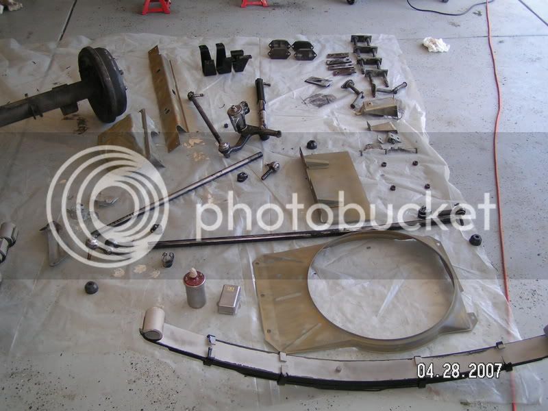

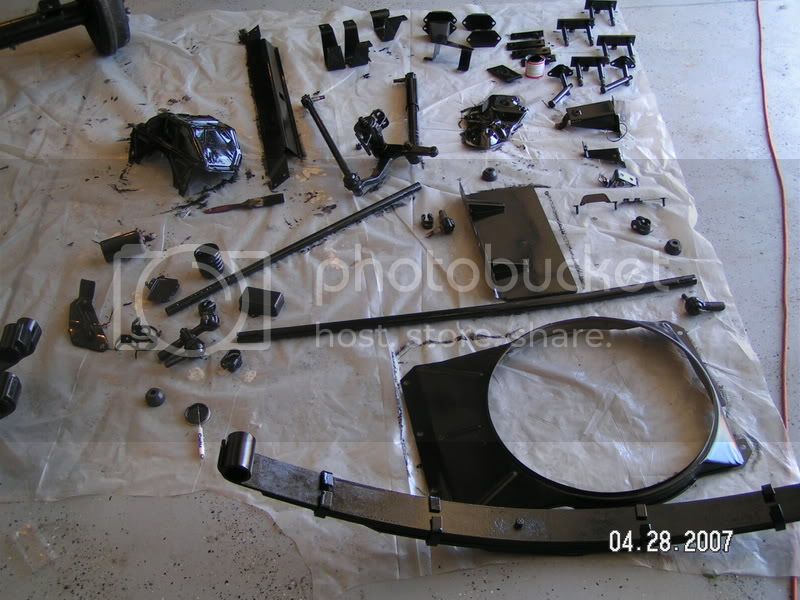

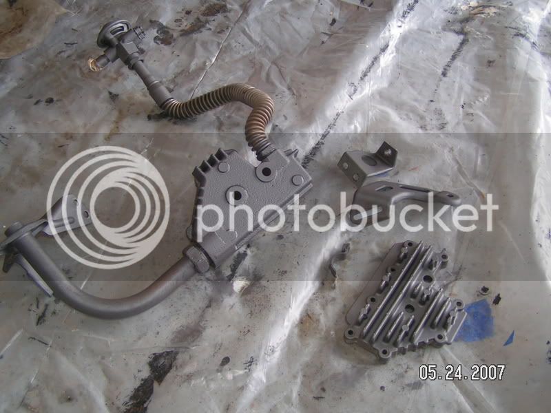

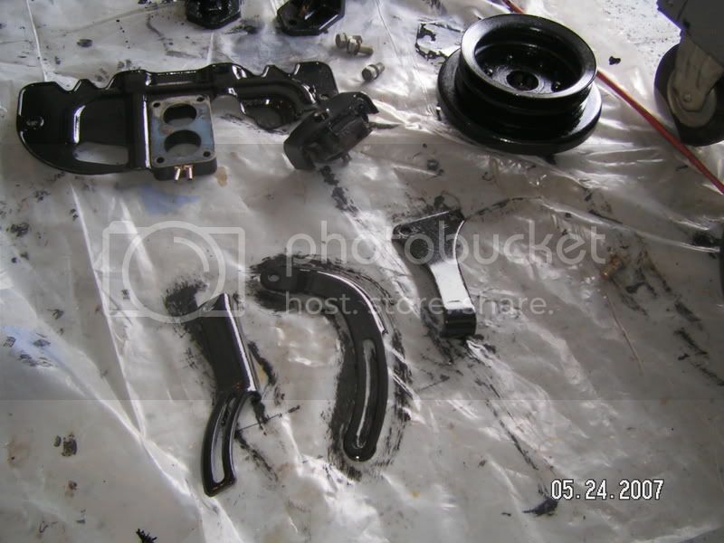

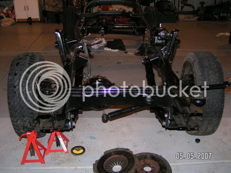

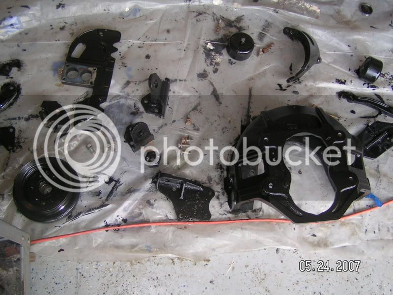

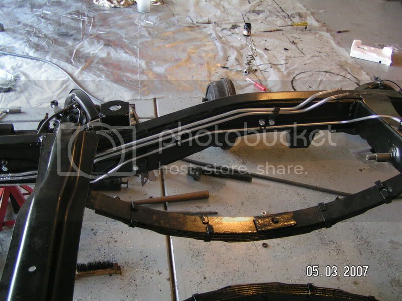

Some before and after pics of various chassis and frame parts. Anyone got a line on hardware, like various bolts to attach skids, brake line, fuel line, etc...

as for lines and plumbing you might try Torino Motor Racing <TMR>in california for aircraft quality fittings similar to airquip but have a much larger metric selection;
Lou
Crap! Did you paint all that stuff w/ a brush?
As for fasteners, CD Fasteners in the Fort might be a good place to start.

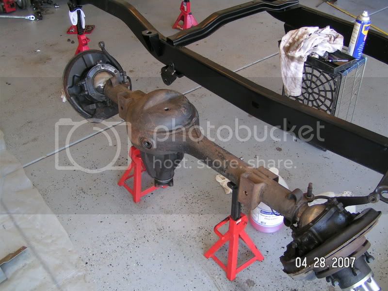

Did you rebuild the knuckles on the front end?
Affirmative with the brush. 2 hours.
Affirmative with the front end rebuild. Rear diff also resealed.
Dropped off the rest of the body pieces (doors, tailgate, etc..) to the sandblaster. I got a look at the blasted body. Damn cool. No real surprises. Rust holes where I thought they would be, some were not as bad as I figured. I will post up pics when I get some. Maybe drivetrain in this weekend.
