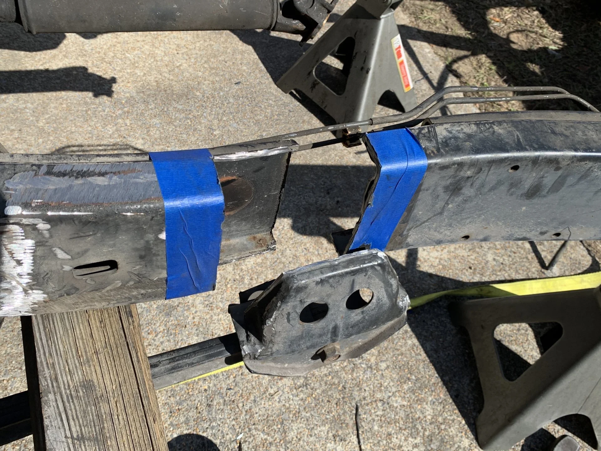

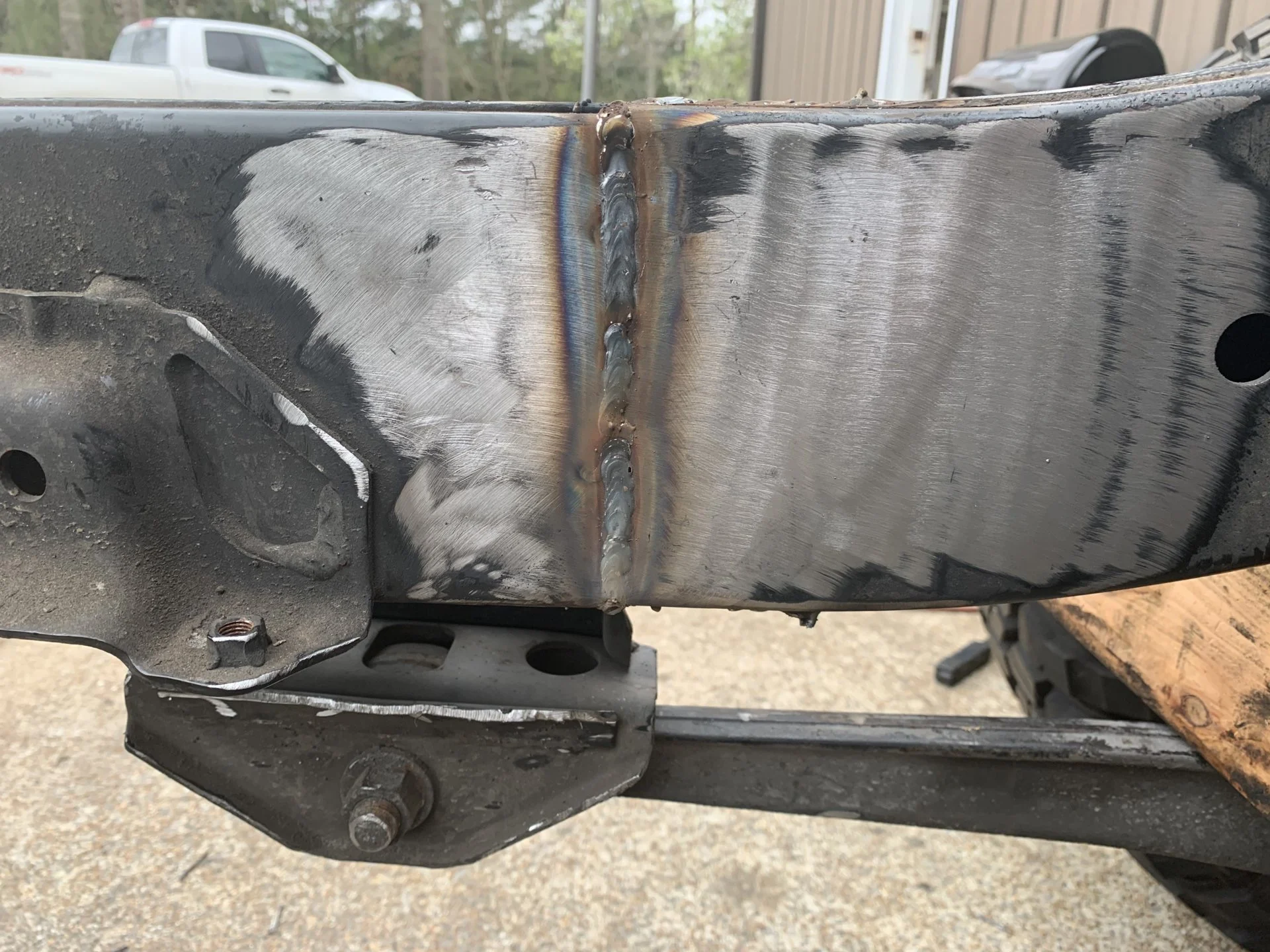

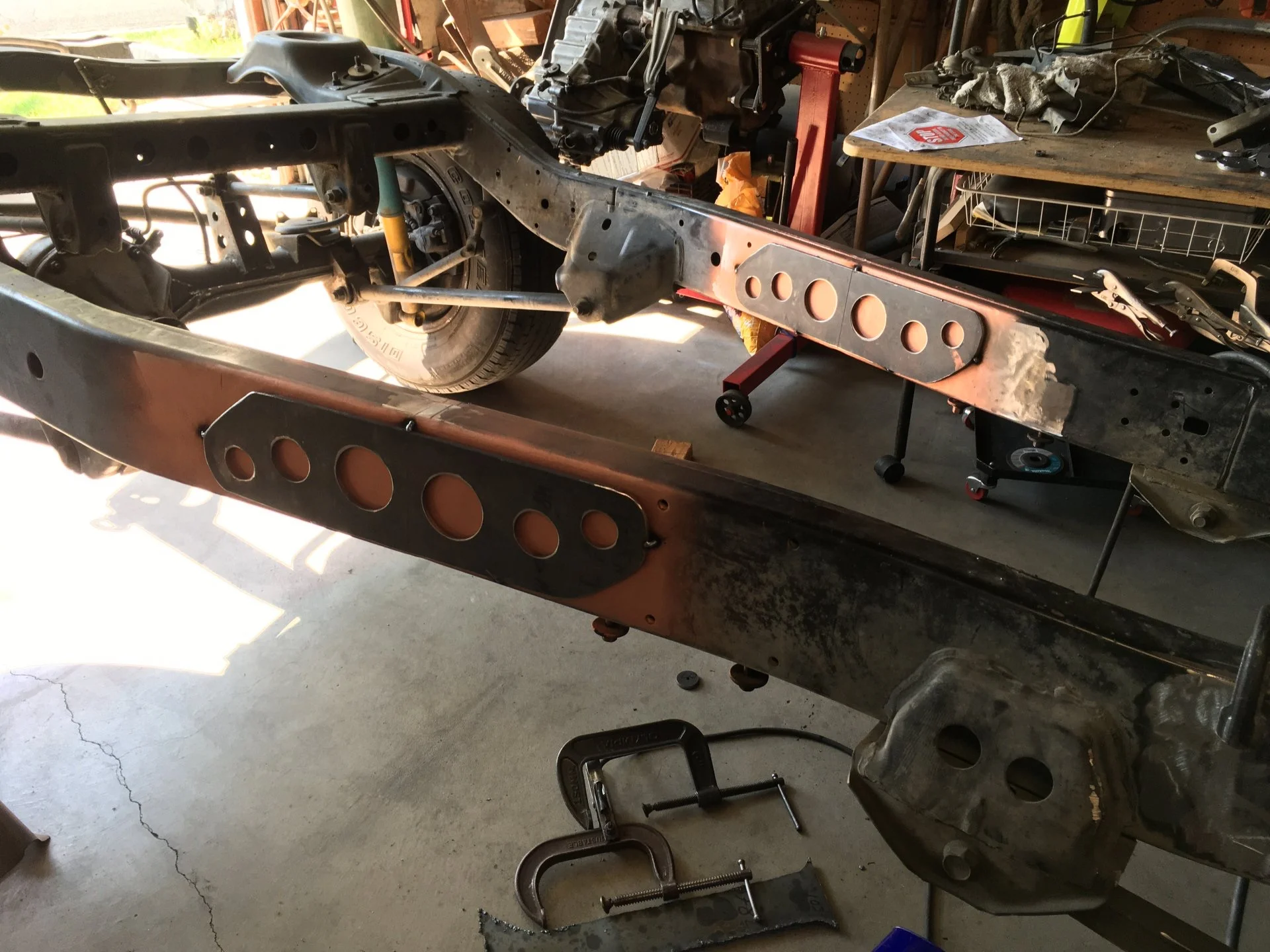

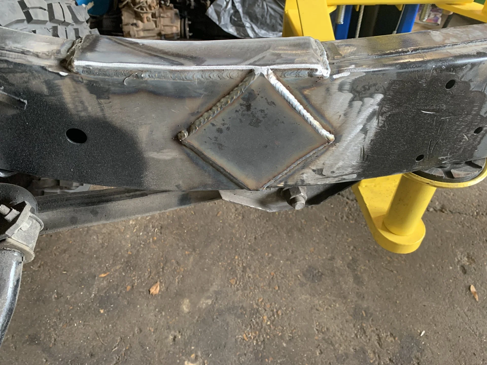

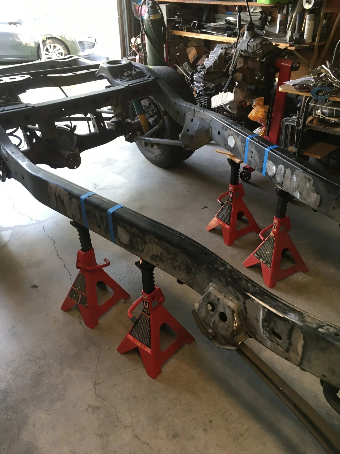

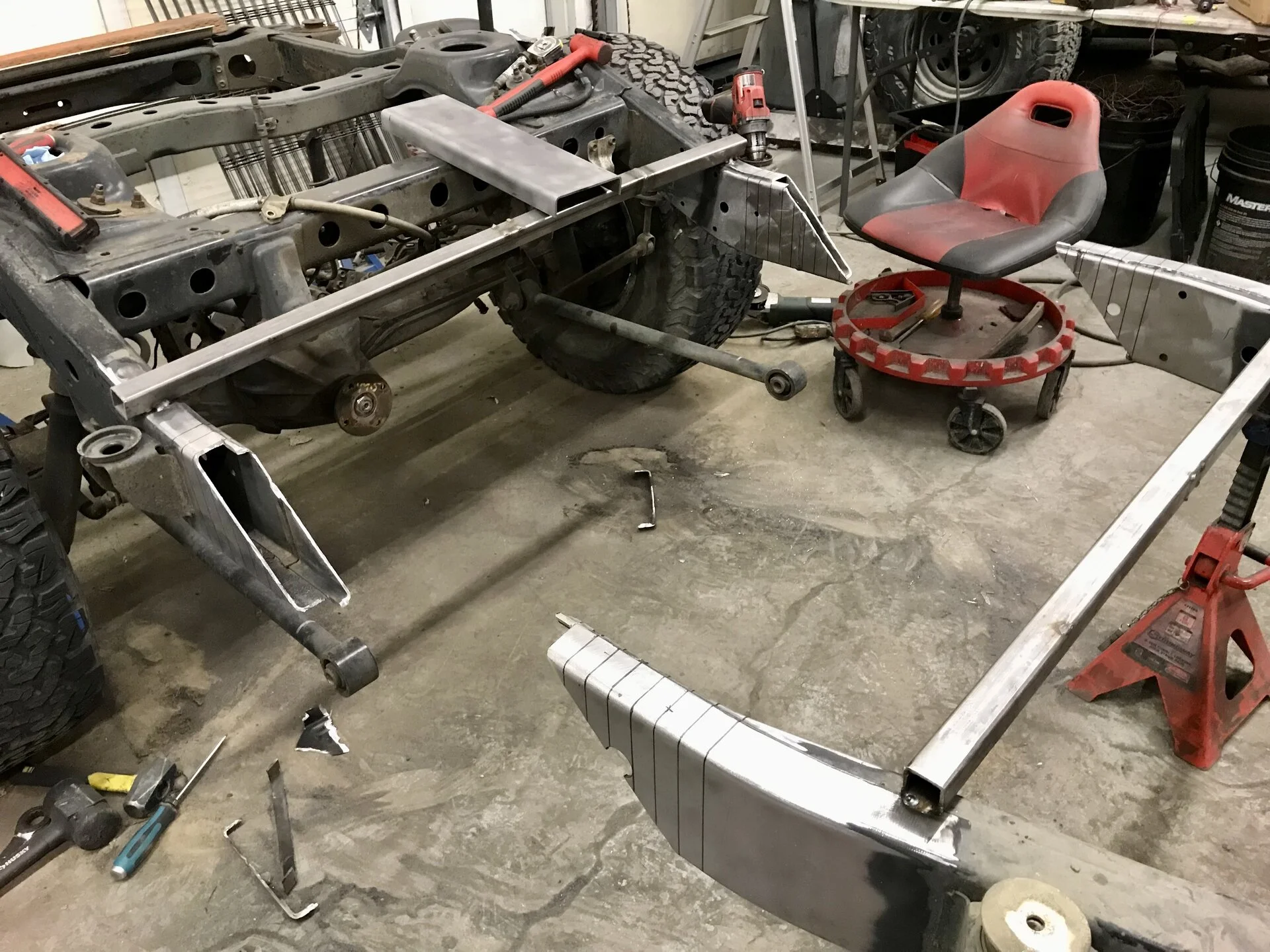

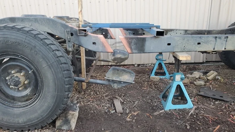

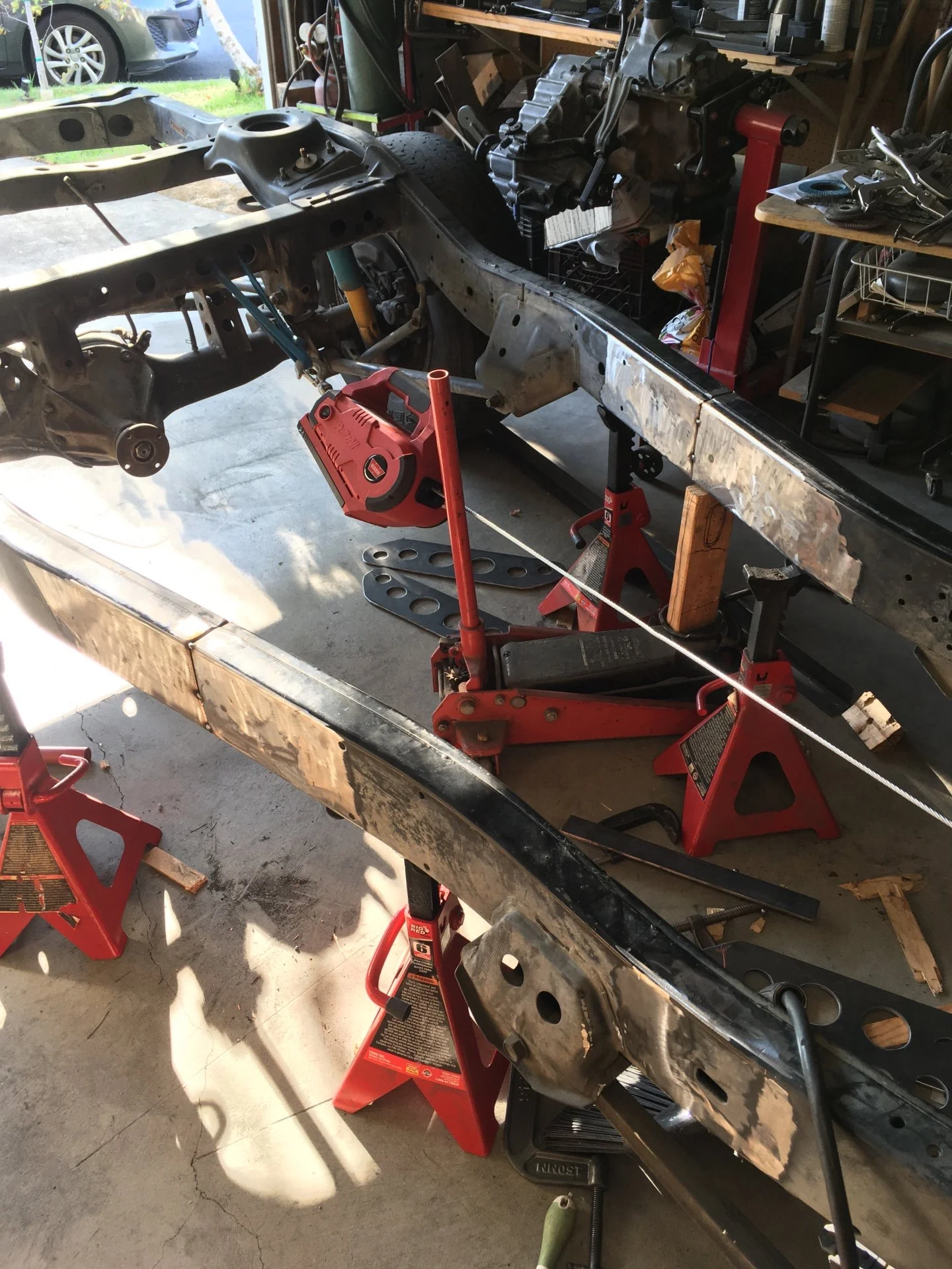

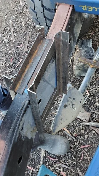

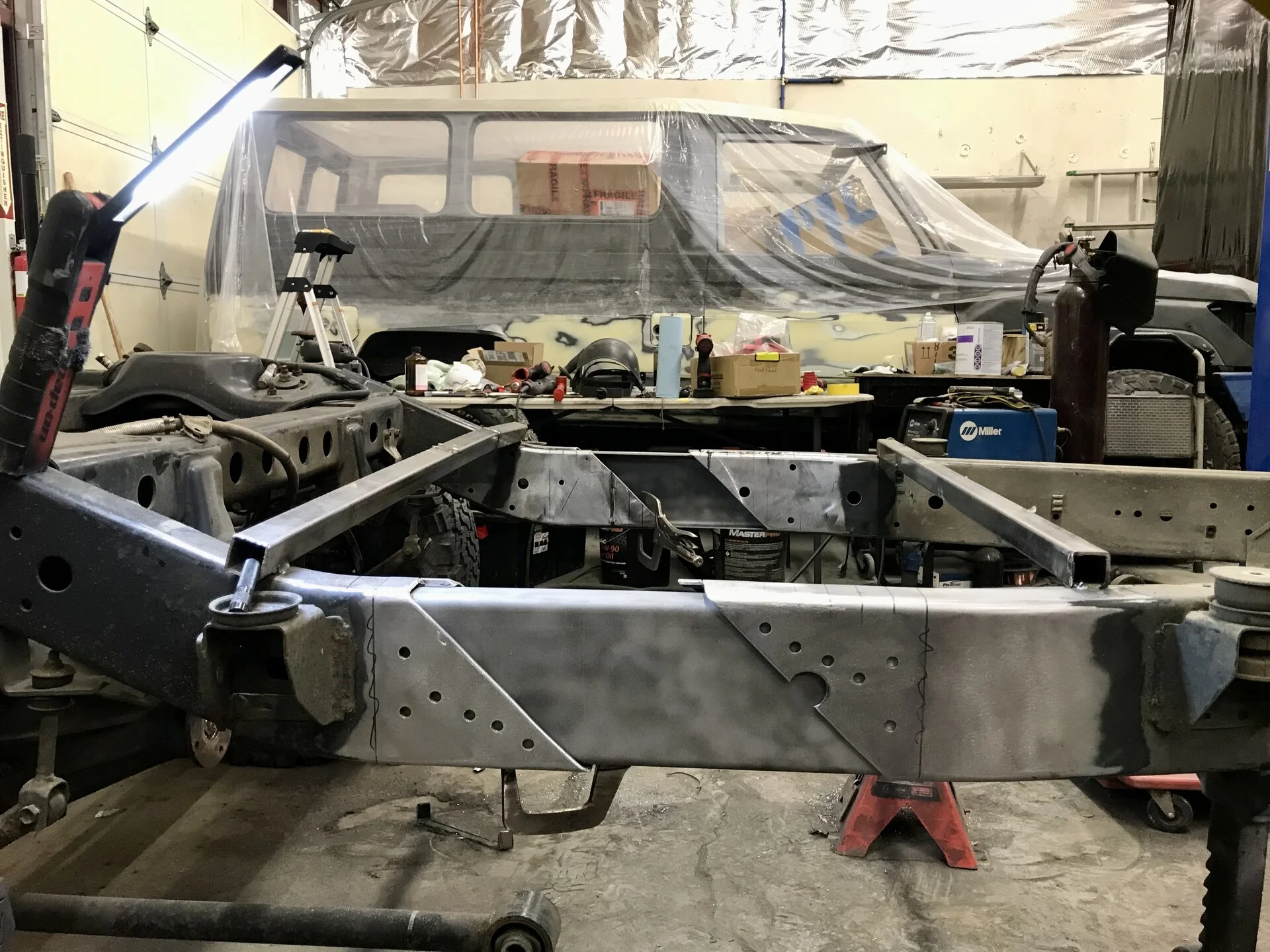

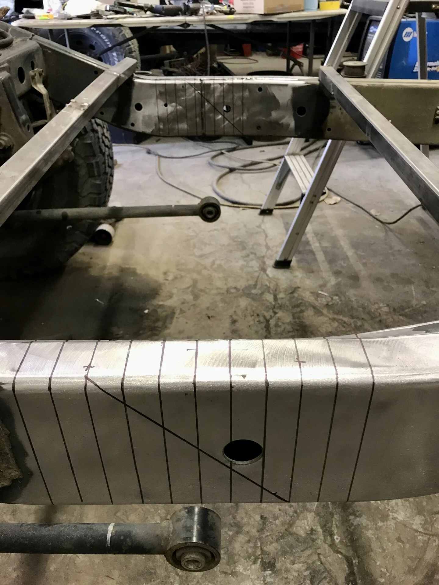

Here are also some pics of the frame shortening procedures done in a couple of the above mentioned threads
A few different ways to get the job done, eh?
By far the most popular method is to remove the link bar mount on the outside and cut the frame at the factory joint. There are other ways to do it, as some have shown, but there seem to be a few benefits doing it at the factory joint.
I have done about ten now. All but one have been extensions though. Doing one right now actually, my 80 Ute, which is an extension too. I always cut off the rear lower control arm mounts and cut the frame there because the frame is straight there. Only the first one did I plate the outside of the frame rails.
Cheers
