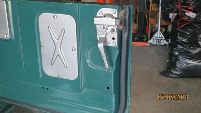

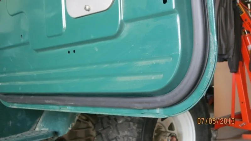

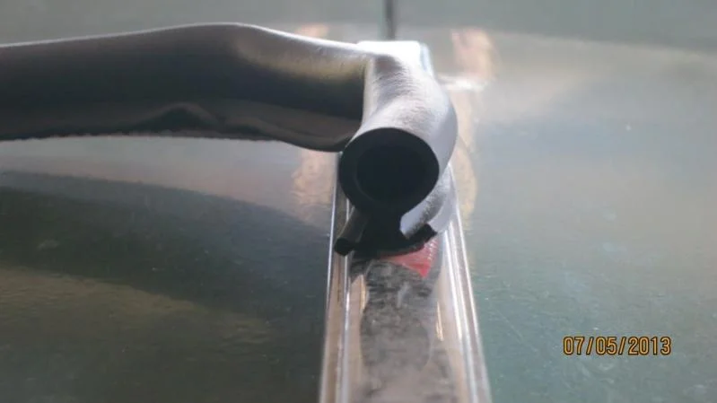

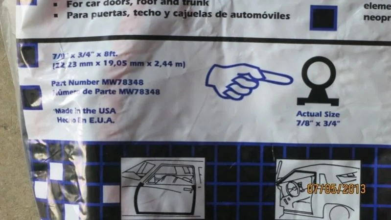

Generic Versions
Driver - Metro/Universal Bulb Seal / approx $20 for 8' (Need 2 kits per door) / MW-78348 / http://www.autozone.com/autozone/ac...mIdentifier=267100_0_0&CJPID=6148504&cmpid=cj OR
http://www.amazon.com/Metro-Moulded-...ersal+MW+78348
Passenger - same as above.
Note: This generic reportedly works on full doors and has been verified by two individuals to work on 1/2 doors here: Thread on Generic Door Weatherstrip
Photos of Metro/Universal MW-78348:
Packaging w Dimensions
Edge View
1/2 Door Installation
