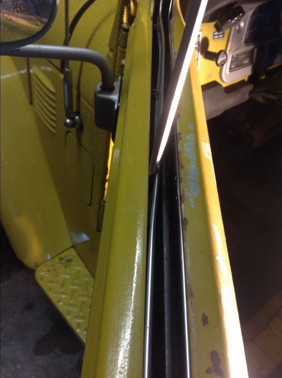

for the door weatherstripping, I used a set off a geo tracker from the junkyard. Its held in place on the tracker w plastic tabs, so it comes right off. Then I used weatherstrip adhesive to glue it to the FJ40 door. Its a thick square gasket that's hollow in the center so it fills a big void and compresses nice. It also has one right angle in it that fits the outer edge of the FJ40 door. The gasket is larger than you need, so I cut out the excess and left a seam at the bottom of the door. Works good so far. Only problem I had was in the winter I forced open a frozen door and ripped the weatherstrip off. It just needed to be glued back on.
Can we see some more pictures of how you made it work?

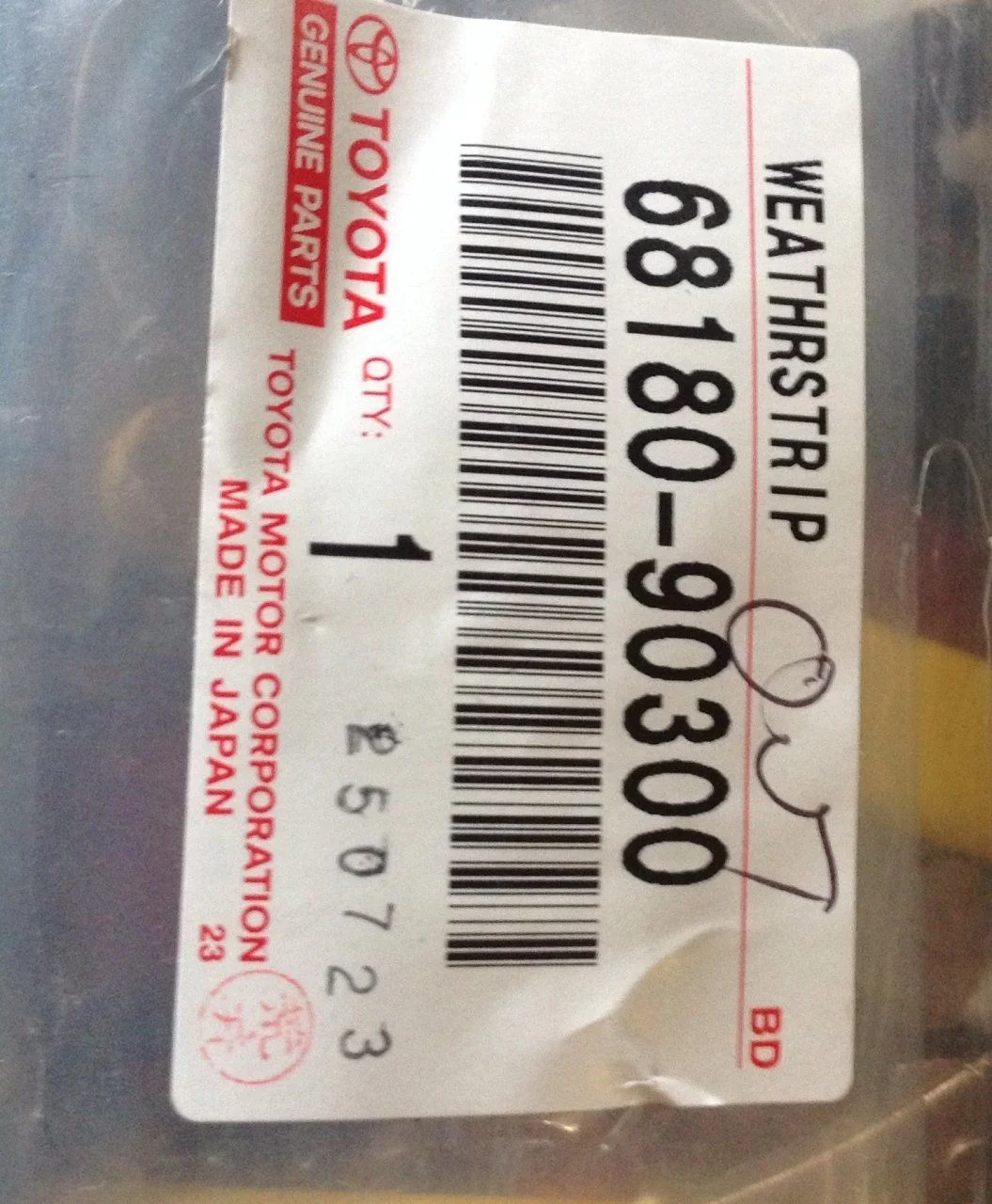

Photo of new Ambulance Door weatherstripping part numbers, courtesy of Gusb.
