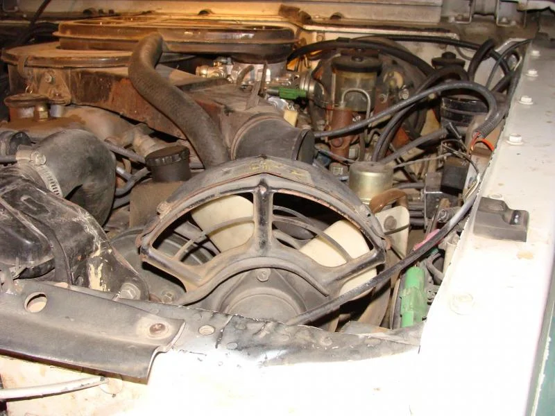

Mine is not like this. It's like yours, but with a different bracket. I'll go get my camera and upload the picture.
Here's the one I got at a swap meet. Maybe it's from a '76ish fj55?? SOR shows four different ones for fj40 and fj55, 1/76-8/76 and 8/76-9/77.
Here's a pic from Pirate that shows one in an FJ55. You can't see the bracket, but the horns would be in the way of the style you guys have.
attachment.php
Or maybe it bolts to the apron? Hmmm...
Edit: Ah HA! Surfpig's Pig:
attachment.php
that's aftermarket. probably because they couldn't get the original carb fan working. most have issues with the plugs, or the sensor, and i think folks just assume the fan is bad.
My 77 Cali emissions fan is just like the one above. Mounts in frount corner. I got mine working yesterday after reading this thread. Had to jumper thermistor. Runs and shuts downs as it should but now runs every time a start engine even if its just for a short time. Is new thermistor available or is there an aftermarket replacement?
Eddy...Looks like the one you have mounts to the radiator support...
Nope. It's from an fj55. Look at the pic of SurfPig's engine bay. It mounts to the radiator support on an fj55.
The arrow is pointing at the top mounting bolt.
Or to a custom bracket that I'm going to make so it will mount almost directly between the carb/manifolds and the hood vent. The bracket is going to mount to the two bolts where the VSV mounts to the fender.

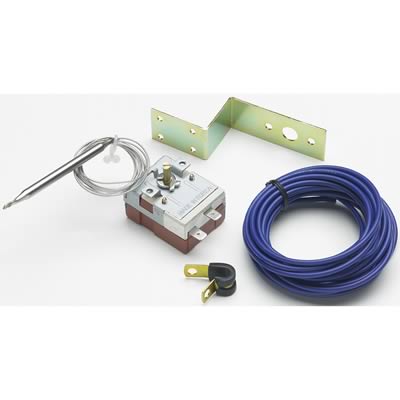

I'm kinda thinking about adding a secondary thermostat control so it can come on while the engine is running when it gets hot under there. They're cheap ($25) and simple.

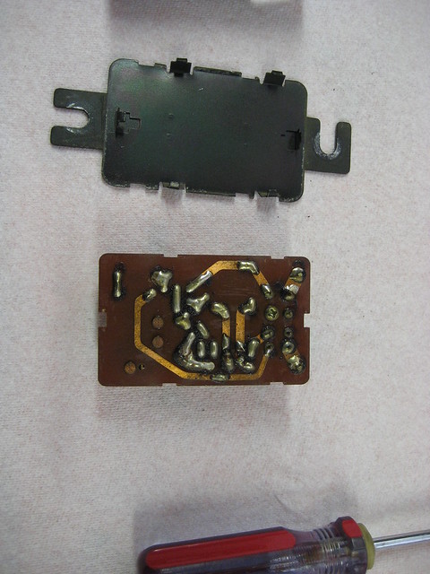

I working my way through the fan system, the white plug from the harness and the green plug on the fan are the same. Tested the Fan again direct from the battery and it works. Found the plug on the fire wall behind the air duct.

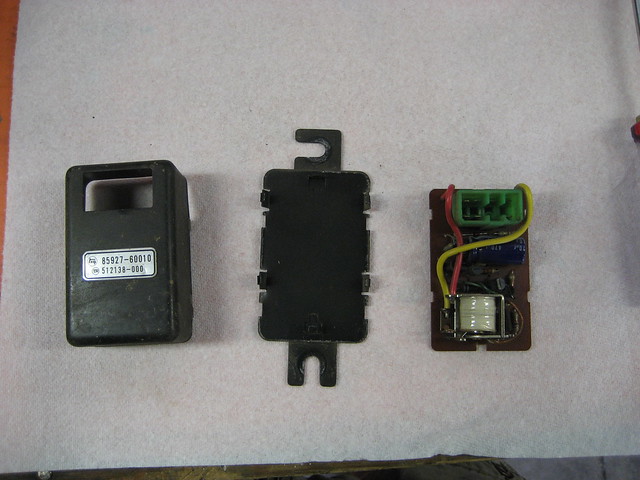

Unplugged it and opened it up by prying the little metal clamps open. This is what It looks like. Plugged it back in and manually closed the little relay? And fan goes on like its supposed to. So thinking its the relay. Now I guess ill read up on reflowing the soldering to see if I can get it to work properly.
The back side

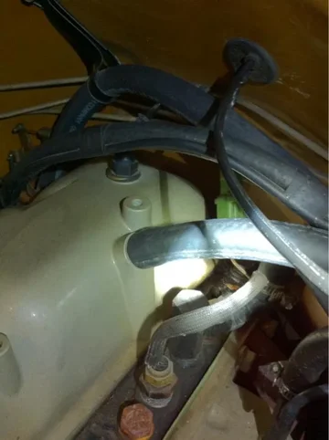

All good info. I called SOR tech line today and learned the thermistor probably was on the air rail like one picture. I think I am missing the thermistor- taken off when de-smogged. I have one sensor that connects to the manifold that goes through the firewall that I think is just the engine temp thermistor. One picture in the thread I believe mistakes this for the carb fan thermistor rather than what i think it is - the engine temp. Thermistor.
Take a look and tell me for sure
The photo I posted is for a 78 Fed Spec FJ40 (8/78). It is bolted to the intake manifold. Do you not have the two mounting points on your intake manifold? Your first photo shows the engine temperature sender.
Your top pic shows the engine temp sender (wire running to firewall). Your second pic looks to have the mini wire harness (blue wire) to the carb cooling fan manifold temp sender electrical taped to a pice of tubing. The manifold temp sender ("thermistor' as people are calling it) on a '78 model is located on a small metal bracket bolted to the driver's side of the intake manifold below and slightly aft of the carb with two bolts. Not as reliable when running headers. Without the big heat sink of a cast exhaust manifold the sender often doesn't get hot enough to function. Don't know if they're still available. Specter lists part 182-85B at $167.51. Ouch!
Thanks. That confirms it. Big help. Ouch is right. Will check one more time but looks like I have to get a new one if I want the cooler. Big help guys. Great thread.

An adjustable thermostat can be obtained for electric cooling fans easily. For a blower, for those of us that never had one stock, or can't find one, I wondered if a Bilge blower would work. They are weatherproof, cheap and would move enough air I bet, something like this:
Bilge Blowers - Wholesale Marine
Just some thoughts, I'd like the timed relay, then I would know the fan could not possibly run all night if the thermostat screwed up or something.
