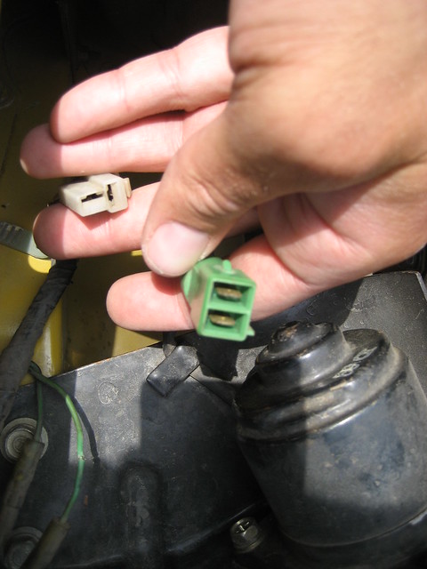

I have an 8/76 from california, W/ a carb cooling fan that is not hooked up. Everything looks complete and intact but no connection to the fan.
This is what I am looking at, green plug from Fan looks like it should just plug into the white plug on the fender but it dosent have the same connection.
Where should the wire to plug into the fan come from? under the dash? Does anyone have a pic of there opperational fan of the same vintage?

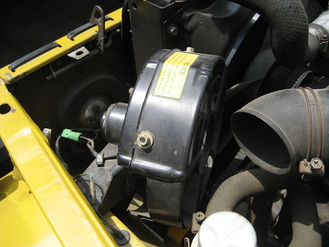

These are pictures from my 77. I have the same fan as you. The green connector attaches to another green connector with a blue/red wire, and a white/black wire.
If the sensor above is for the fan...Mine is mounted to the air rail, and the connector appears to attach to the same color wires as the fan. all wire go in to the firewall...
HTH
Thanks Kurtnkegger those pics help a lot. Since I have a webber and headers my sensor appears to have been moved by the PO, but your pics will be great because I've been collecting parts to go back to a stock carb.
Thanks Kurt, that helps me also. My white plug has the same wires going into it. I'll trace it back to the fuse and may just end up jumping the plugs as see if it works correctly when hot? I already made sure the fan works.
That fan is the same as Kurtnkegger's '77. The fan I got at a swap meet is different, at least how it mounts. If there was a 2-piece mount, I don' t have the fender piece. My fan mount ends right by the motor with a flat vertical metal bracket with two holes for horizontal bolts. It's very clearly OEM. No pic now, sorry. The fan, shroud and motor are very similar if not identical.
The fan I have has the white plug that matches the white plug coming out of your and my harness with two pins at 90 degrees, as opposed to the green plug with two parallel pins.
I think the fan I have is exclusive to the California spec emissions model. It seems the non-Cali fans run from the middle of the fender well area.

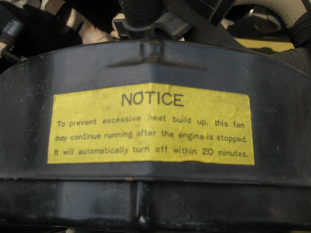

. Do most FJ drivers have a functioning carb cooling fan? I have a 78, but I'm not familar with the story behind the fan...it seems like a design flaw fix and I wonder if they later fixed it where a fan isn't needed.
the fan is on the emissioned engines, so not on non u.s. models. it was required because the emissions caused higher temps and that created the fuel issues.
