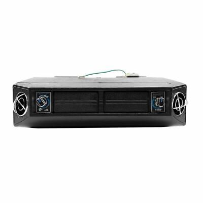

Heres a pic of the vapir3 installed...
The Vintage Air guy said that Icon does their own thing and utilizes VintageAir parts.
The vent assembly can be removed with screws, so I'm guessing they just order a manifold from vintage air that allows for installing air ducts instead in place of the front vent piece/bulk vent assembly. The Vintage Air chevy nova kit uses such a manifold instead of the bulk vent assembly the 40 kit has.

- Restomod Vapir III: 950 USD, uses up glove box and looks a bit bulky in the passenger footwell, seems to blow mainly on passenger, unless holes are drilled in dash with extra vents. Not clear if available RHD

For rear passengers in a troopy u could mount a second ac unit using a generic under dash kit under the front seat aiming rearward. They are cheap and small.

Think I found a evap/blower unit that could be used in the rear of a fj40 to keep rear occupants cool...
