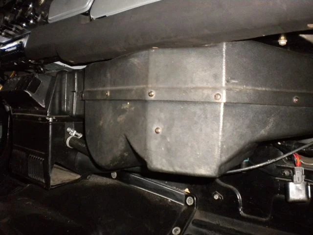

For the sake of furthering interesting AC ideas, I want to share what a friend did in his bj42:
Basically, he took his universal AC and had a faceplate done in 3d and moved the face to the center to better distribute the cold air.

someone should make this add on system. Works well and keeps original heater box. Works well to de-humidify in coastal Carolina and make the heat bearable in the summer.

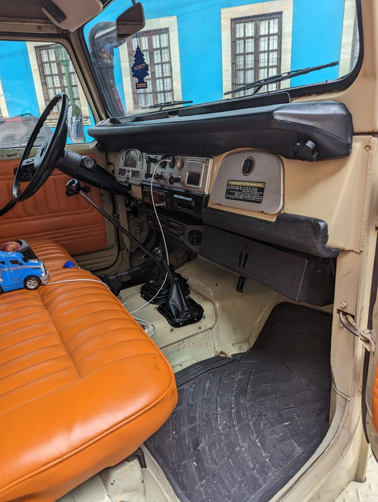

Hi to all, I´m wondering about AC options for my '77 BJ40. I know its been a while since this post, but I came a cross a similar unit....can someone confirm if this is an original option or some aftermarket kit? I would like to keep averything as original as possible.
I also don't understand the purpose of having a second fan in the air duct, maybe someone can give some info about it.
Thanks in advance for all the inputs.
Some markets had factory heaters, but factory AC was a very rare option.
Oh man. This is cool to see. My 40 had AC installed before I owned it and everything but the vents removed when I got it. I have never seen another 40 with the same vents until now. Always wondered what was installed. Now I have something to go off of.
I had a feeling the unit have been tucked way up high I see the dash because unfortunately the glovebox is removed. That plastic insert you have would be a lifesaver. Did it come with that AC kit or something else. Looks like you have an Aqualu body?
Hope you can update us on how it’s worked out.
