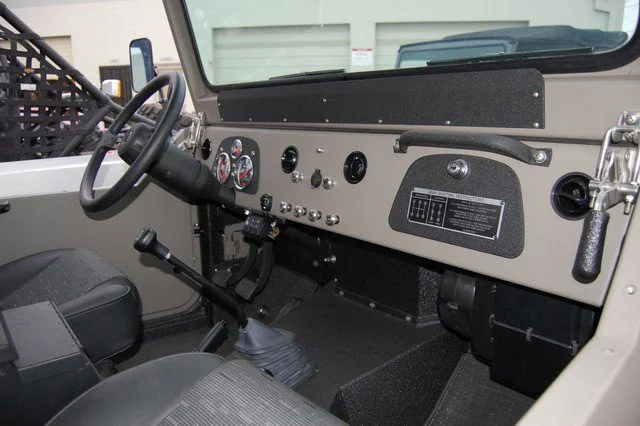

I think the ICON uses one of the surefit units from Vintage air. It's more of a custom application on the TLC trucks. The ducts go into the aftermarket dash vents, and the A/C unit is installed where the glove box is. You lose most of your glove box as well. I have some pictures, I'll post them up..

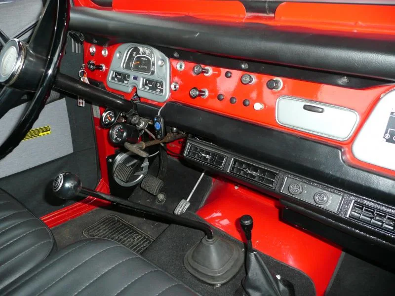

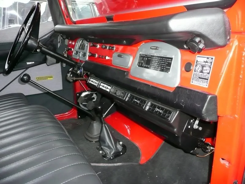

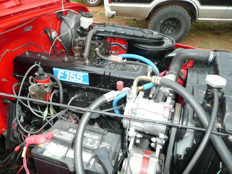

I dont have A/C on my 1976,but i have pictures from a friend in Puerto Rico, dont know the brand or where he got it,so just i will post photos..:meh:

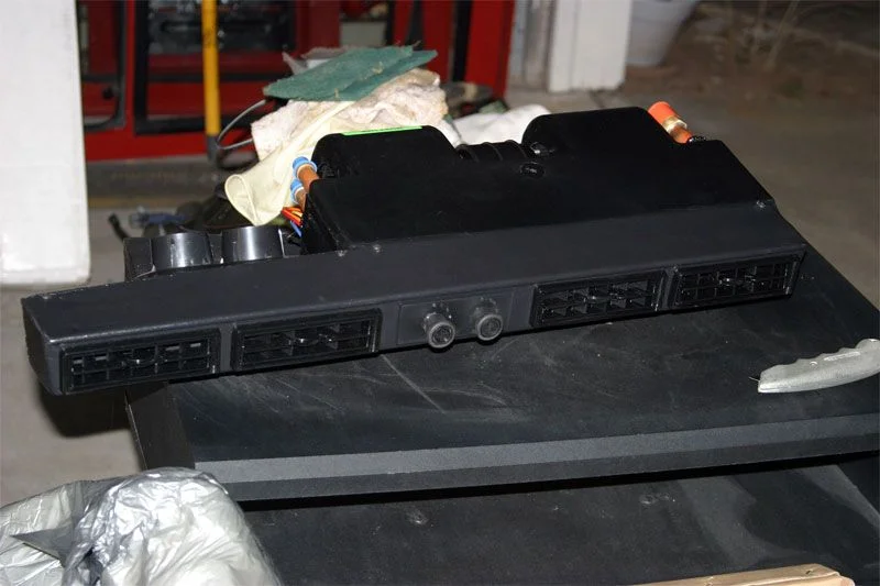

If you do order the Nostalgic Air kit, make sure you get everything. I also happen to be a Nostalgic Air Dealer, and it is not a complete kit. This kit is very generic, used for many applications. The A/C hoses are not crimped, and the defrost feature is not included. Nostalgic Air has never installed one in a cruiser, they just bought a FJ40 dash to make sure the unit would fit. So they are not going to be very much help with tech support. They are just a A/C parts house, then do not manufacture anything in house, or have a R&D or tech support department like some of the other aftermarket A/C manufacturers.
Here is a shot of the unit.
Here are the ICON pictures I had. Iam really not sure what unit it is that TLC is using.
That's the Hurricane Universal system from Old Air....very nice unit, but won't fit where the heater was unless you relocate the stereo...and you lose the glove box if it's off to the passenger side. The top has the outlets for defrost and go right into the glove box. Wish I could get it to fit in the heater spot, but it's too big. Talked to the guys yesterday for a while, really nice and helpful.
