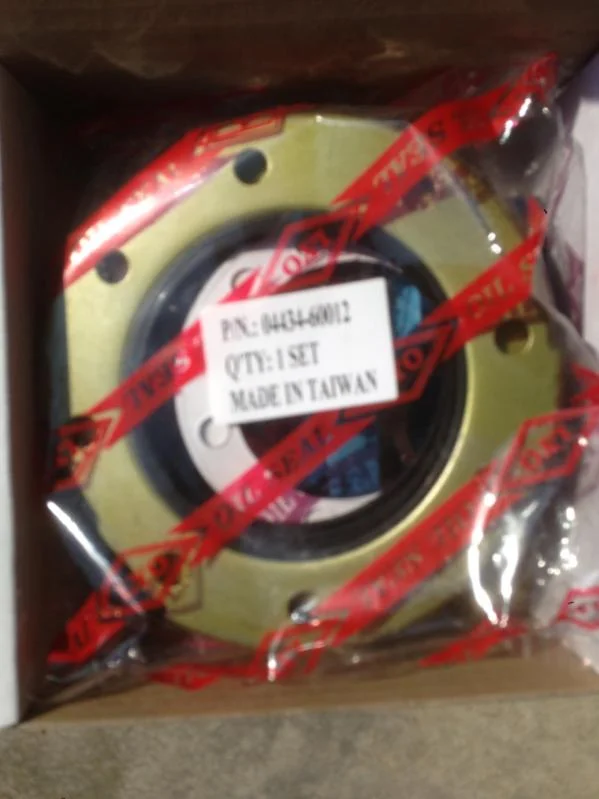

As far as I got unboxing tonight.
UPS had to modify one, but in the famous words of CDan "Cut to fit, bend to match." Haha.

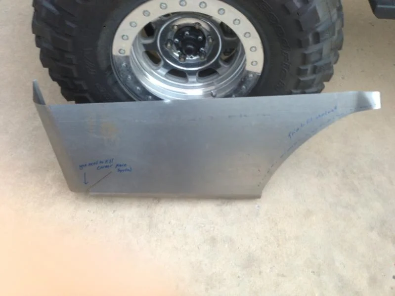

Body panels are coming together.
They look better than before but not as nice looking as brand spanking Aichi new!

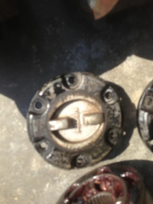

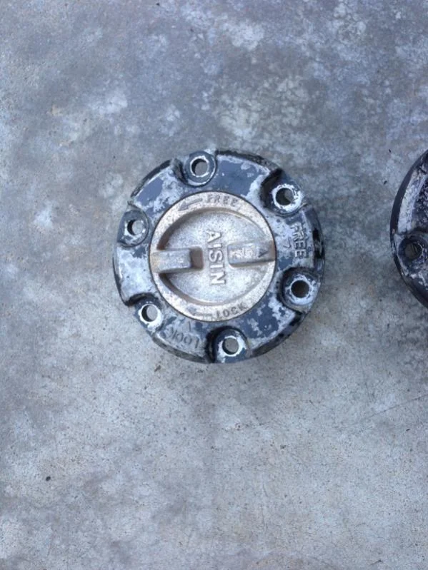

Hey, Pablo.
You still have extra balls?
You know, the little bitty balls that like to pop out when you least expect it?
Hahaha.
Need one, maybe two, depending on my patience level in 100 degree heat.

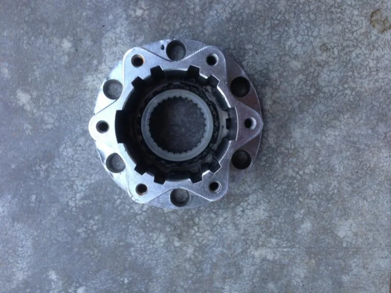

For the Aisin lock-out dials?
Your search skills are strong!
Been a while since I posted that...
Yes, I believe I still do. Just need to remember where!
PM me your address.
Yes, I thought you were going 60 series PS as well?
No, leaving.
I can deal without PS on this and keeping it clean and simple, like it came.
Be a good workout if nothing else even though forearms and hand grip strength has never been an area of concern.
Yes. In the millisecond after the first I remembered reading about losing balls.
I'm not sure the second even had.
Will forward address and still haven't seen yours, but can wait until you send other stuff, if preferred.
Would like to have all mechanical/drivetrain parts accumulated by mid-August, so plenty of time.

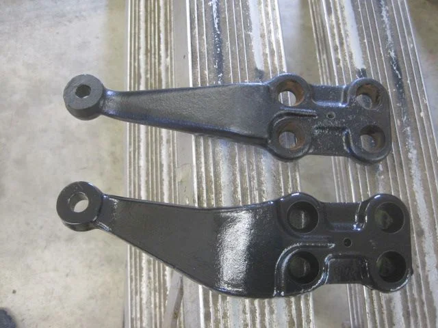

well, as discussed in the email, the cross link part number
45460A ROD ASSY, TIE
45460-69135 1 $412.69
has the ends included and will work from arm to arm.
the other part number i posted comes with the ends but is too long ... i think ... for your application. it is for the 60 PS box, now, IF you can give me a measurement of the existing arm to crosslink hole then i can go measure what i have in the garage ...
in the pic you can also see the difference in strength between the 70 series arms and the 40/55 series ...
this is a 42 series axle.
hopes this helps.
