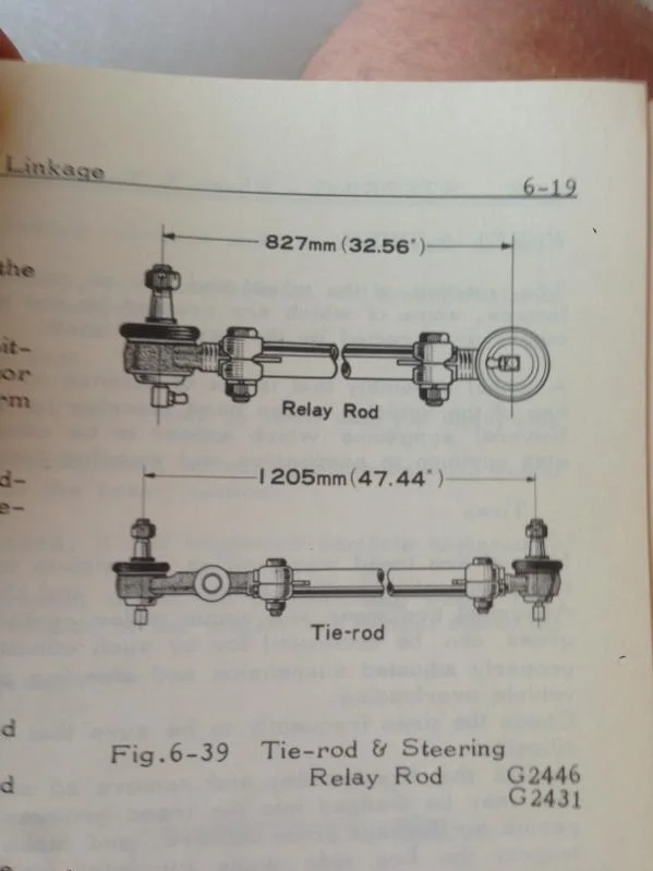

Would you mind measuring the steering rods so I can check against what Wayne has listed?
I get lost on the build threads, but I'm pretty sure you've one with 60 knuckles, right?
The one with 60 knuckles also has power steering and 4x4 Labs arms...
Might I ask a favor, at convenience?
twrecks has mini knuckles, which are essentially the same, but power steering and custom rods. the pickle has 60 series knuckles because it has a 60 series axle which is wider. 69, 76, and 78 are bone stock.
so i'm gathering what wayne is trying to find is the length of the relay rod for a stock late model pig and he will figure which rod has the correct length to match stock late model pig and correct taper for 60 series tie rod?
78 relay rod is about 30" on rod itself, about 34" outer edge end to end. sorry not approximate,, but measuring off bosshogs rig which is a bit greasy

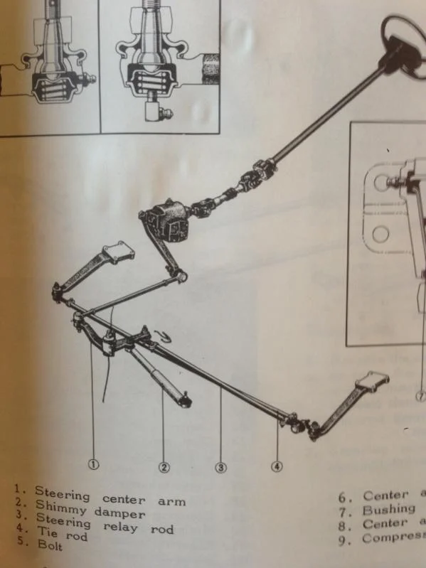

Per FSM (imagine that)
Relay Rod 32.56" (827mm)
Tie Rod 47.44" (1205mm)
Oddly enough, the FSM is backwards. Haha.
What I can't find is anything with nomenclature regarding the rod from pitman arm to center arm, nor any indications of a length.
That'd be correct.
Goal being OE rods with 60 ends.
Thank you, Ige.
now, is that 32.56 from center of tie to tie or just the threaded tube?
okay
part number 45460-69135 tube is 42" with center of end at 48" with +/- 1" play
part number 45450-69085 tube is 30 1/4"" with center of end at 38" with +/- 1" play
so unless you go with 60 PS box, this relay rod won't work in your application.

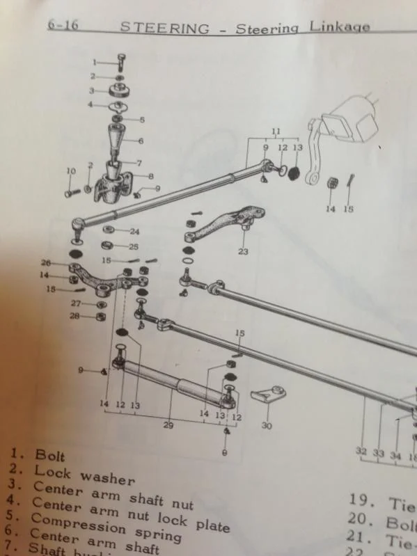

With the 60 box, the drag link here is eliminated, correct?
Almost sounds easier to do PS than not.
For terminology, I've always assumed there a drag link from box to knuckle and a tie rod from knuckle to knuckle.
This states the drag link is from pitman arm to center arm, relay rod from center arm to knuckle, and tie rod from knuckle to knuckle.
That's a lot of stuff going on, and would have to source rod ends for this versions drag link to center arm, too. Defeats the "all 60" TRE goal.
Don't know what to do, honestly.
I may be missing the forest for the trees, just don't want a bunch of cobbled up chit, if I can possible avoid.
Guess I could always have all three rods built to FSM spec, ream the center arm and pitman arm to accept 60 TREs, and call that good?
oddly enough, most countries, including japan have everything backwards ;)
the drag link most likely isn't referenced since it is static. there aren't replaceable ends, it's all welded.
