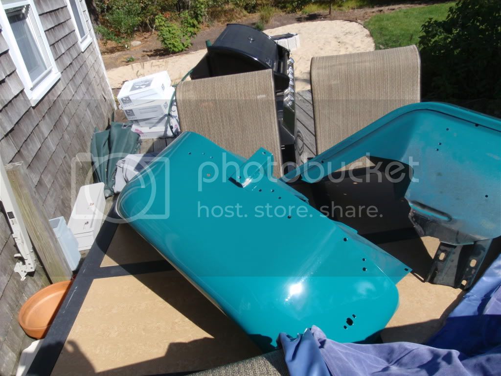

ANNND some pics of the new paint from this week.

Johnny I am thinking about light Grey or tan, this is going to be a beach truck and I dont want to sit inside a black tub baking in the hot sun! THe underside will be black though. I think ill go with the U-pol raptor liner.

I think I am going to color match the liner inside the truck to the outside color.

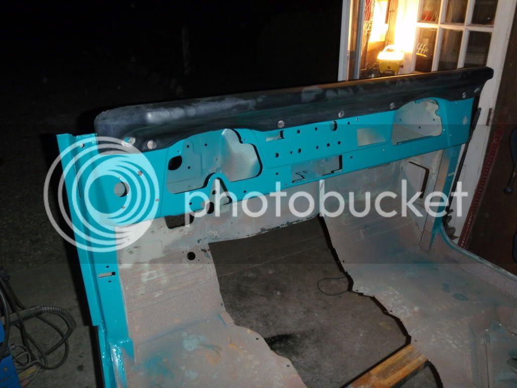

I sprayed some bed liner last night. I used 2 bottles of black UPOL Raptor Liner. I find that 70-75psi is a good rule of thumb, good light coverage, even texture, and dosnt burn through the liner as quick.
My plan is to use the black color like undercoat, and then tint the stuff inside the tub blue to color match it. SO I am trying to use the black sparingly, so I dont run out. There is a TON of real estate to cover on the underside of the tub.

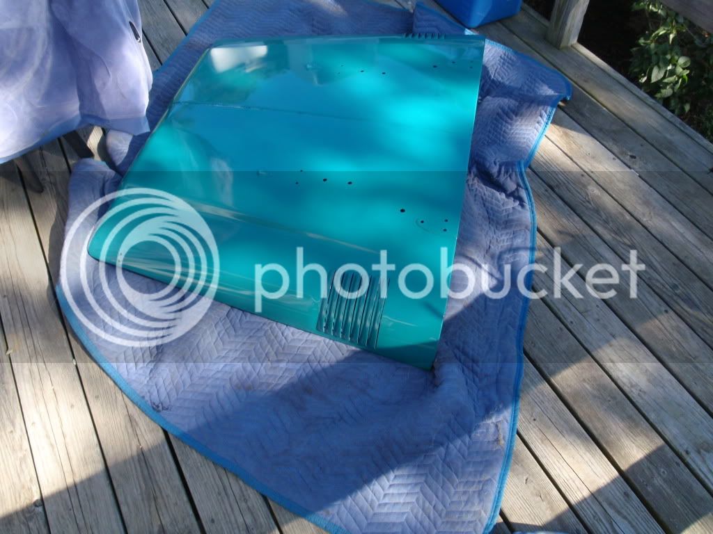

Hood:
I am going to try to spray the whole truck with the power tank. Its clean, DRY CO2 and it costs me a whopping 25$ to fill it! Another bonus is I dont have to listen to the compressor the whole time I am spraying!

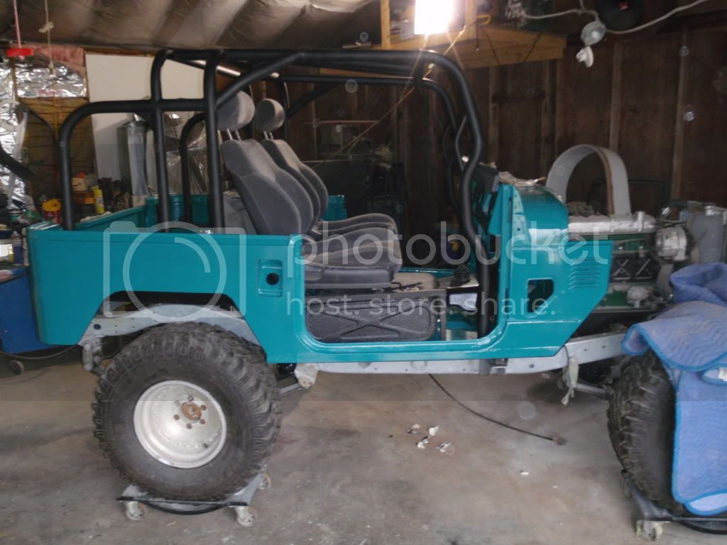

With some major help from Jay and Jimmy, we made some huge progress yestreday.
Started with getting the body back on the frame. Then got the cage bolted down, and the rear seat. The seats/bracket re-mocked up and had to modify the seat bracket a little bit for the gas filler neck. I also got the rest of the panels back from the painter, and they need to be shot with the bedliner before they get bolted on.
I assembled the body. Still working on getting it all lined up. Now its the part of the project where I gota paint little pieces, wait for them to dry then bolt them on. The end is coming soon!
