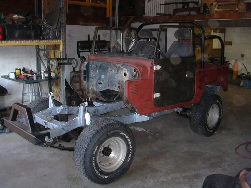

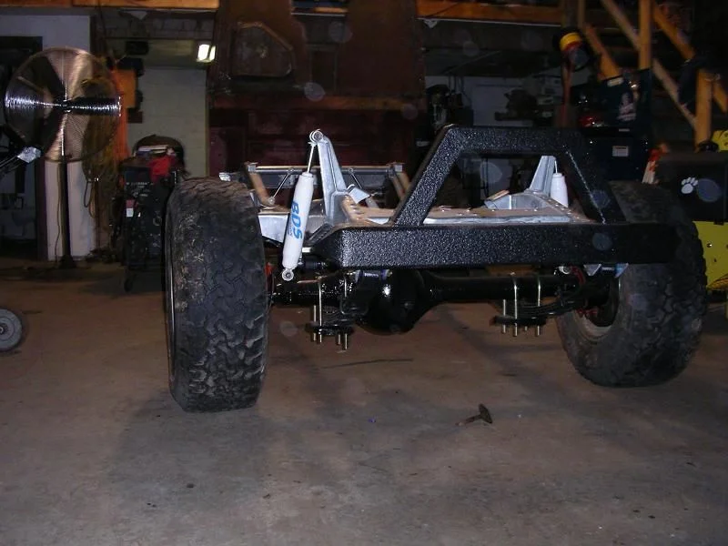

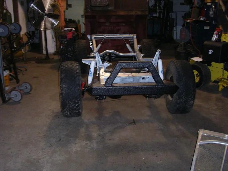

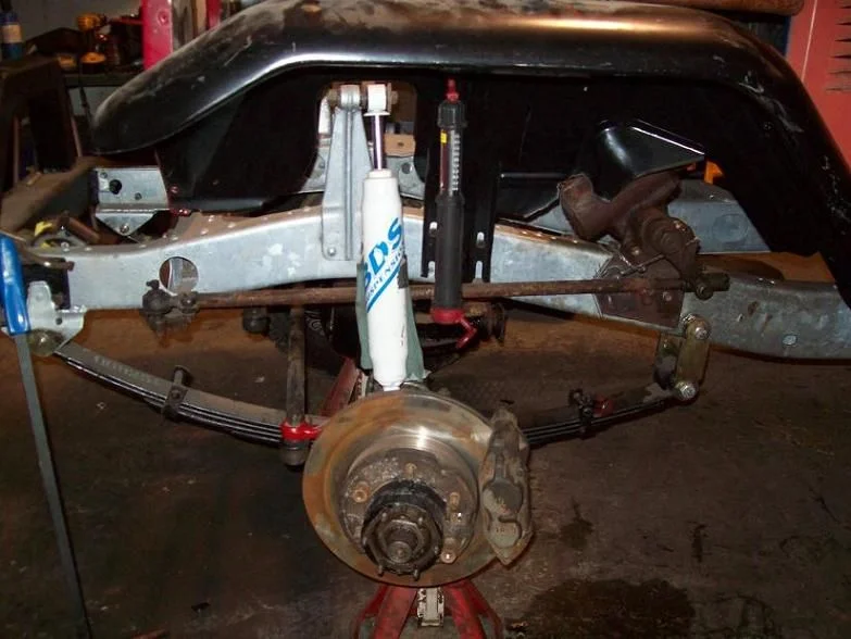

Finaly got a rolling chassis built. I am about a week~ish behind where I want to be, but what ever I am having fun and the girlfriend (its her truck) is happy.
Quick specs:
2.5in BDS
Galvinized frame
mini truck nuckels 27stock birfs
Vented rotors, IFS mini calipers
9.5 in wide rims, Big flat Centerline's :cool:
Vortex'ed midevil looking bumper.
I am starting the steering mockup/build once I get the tub floor welded and set on the frame.
thats the tub behind it, standing on the tailgate section The tins and Tub will go to Garnett blasting hopefuly next week, while they are gone Ill swap in motor/trany/tcase. Fmotor/4sp/3spd case :D

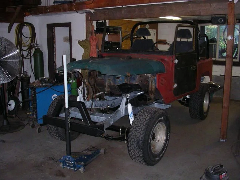

Droped the body back on last night to mock up stearing and stuff. Its going to be a while before those springs settle! :eek: I am 6ft and the bottom of the window opening is just under my arm! :lol:
Need to weld a few things up and it will be ready to go to sandblast. :cool:
Are you planning on going thru a wall instead of climbing it with that bumper? Damn! I like it.:cool:
Trees man, trees. (and people from Jersy) You should see how much dammage is on my other rig from the combonation of both :)

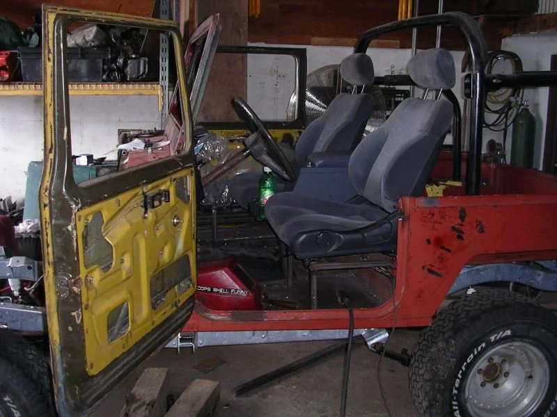

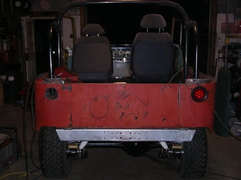

Quick update. All the little stuff is killing me. little more welding here and there... I keep finding stuff to fix. Got the seats all in, along with the tuffy, also got the tail lights in there too.

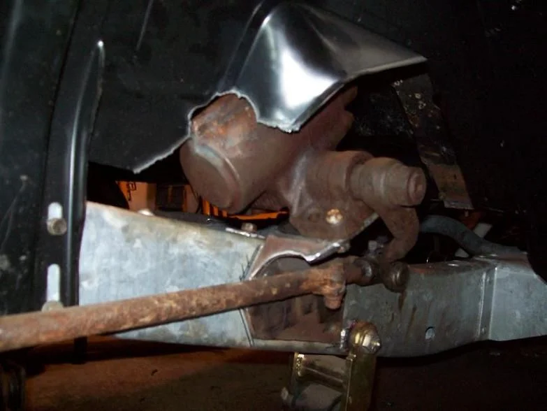

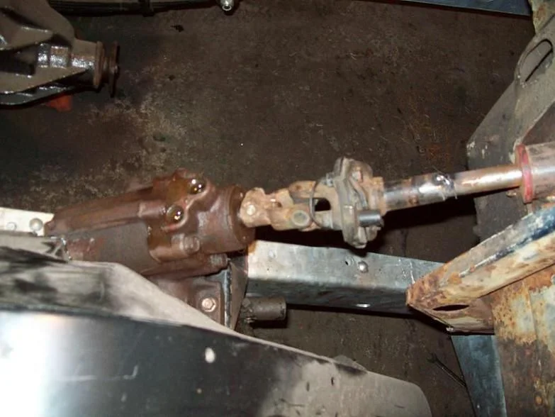

Mini truck powerstearing box is installed and colum is hooked up. All done except for paint.

A BIG thanks goes out to 82crusier for the stearing stuff that I need to mock up the stearing system. :cheers:

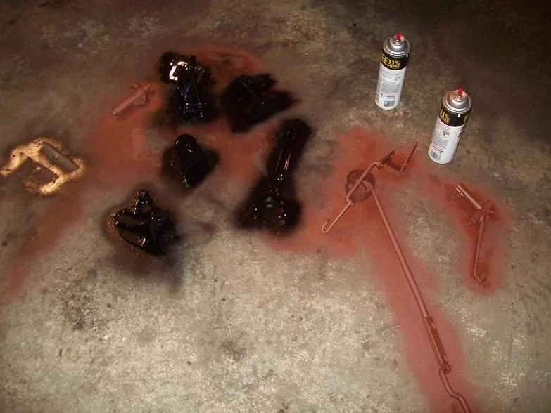

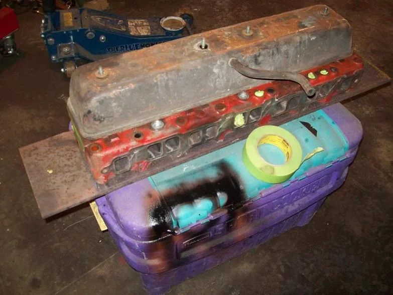

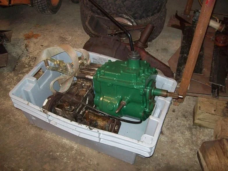

Been in the cleaning parts and painting stage. Waiting for a bunch of parts to come in and need to go pickup a bunch too. Flywheel, throwout bearing,etc the last couple things before I can slam it all together and drop it in there! The 4speed/3speed case setup is done, just wanted to get the case water tight before I wash it down one last time, most of the junk on there is soapy crud.
Head swap will happen after the powertrain is in the truck, much more torque accurate that way. But while it was clean I figured it needed some paint!
