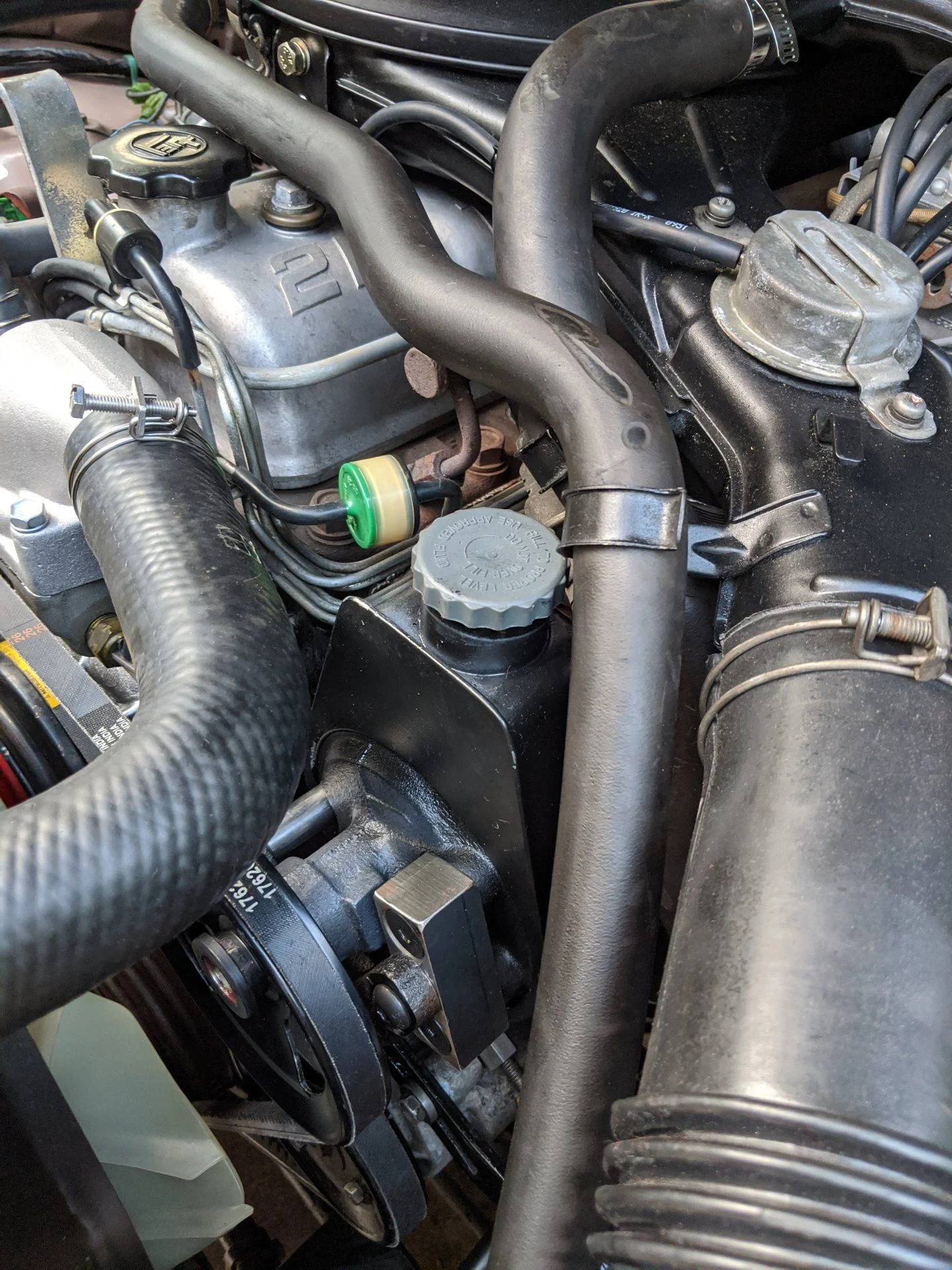

Long time lurker - finally an owner as of April. Had issues with OME power steering pump and found this thread. Reached out to Georg who super helpful. Got the kit and installed during my overhaul:
Long time lurker - finally an owner as of April. Had issues with OME power steering pump and found this thread. Reached out to Georg who super helpful. Got the kit and installed during my overhaul:View attachment 2368319
Thanks for the order and kind words! Please let us know if you need anything else for your cruiser.
Happy to help!

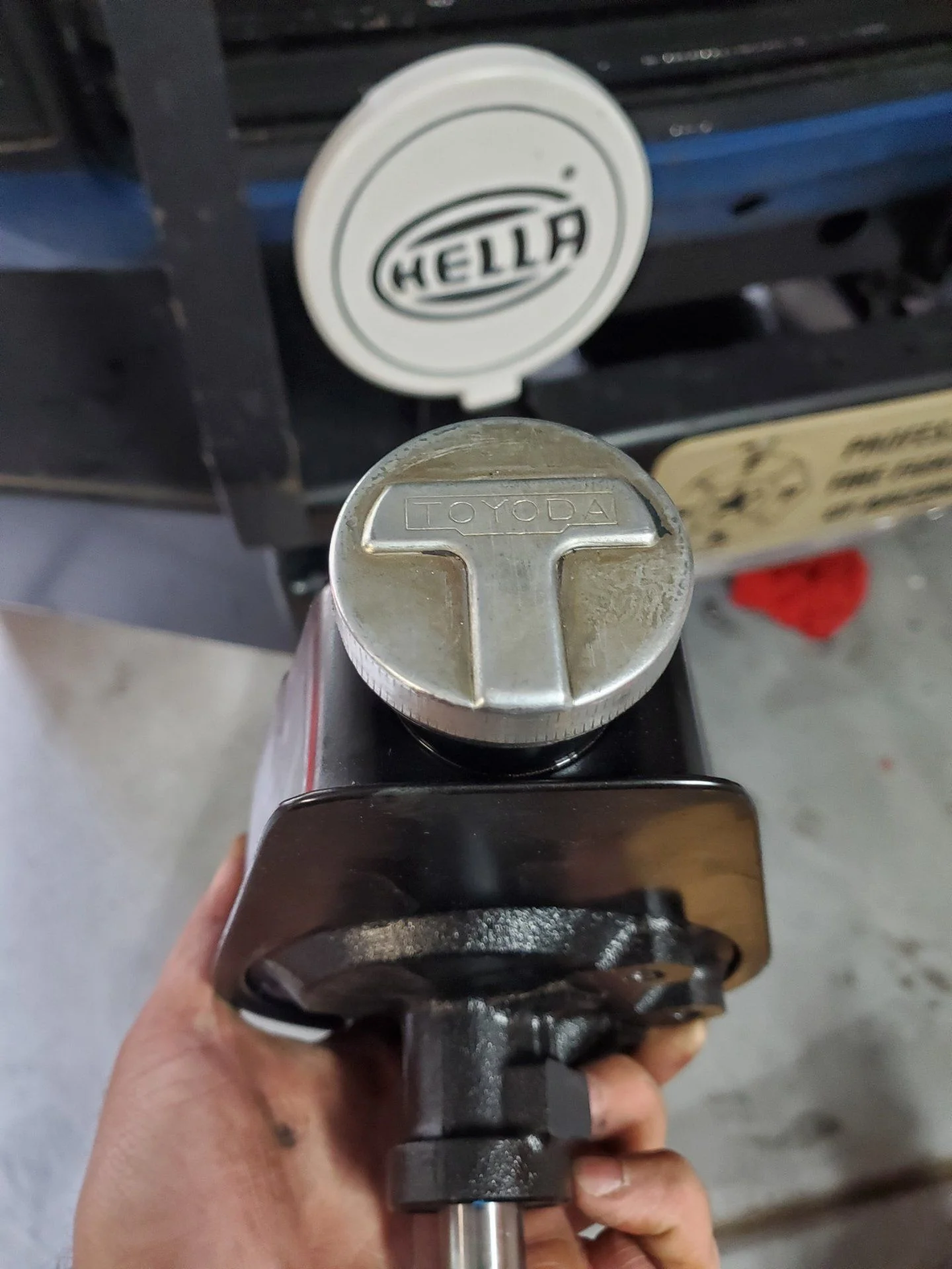

Oh, also, I popped the cap off my Toyota PS reservoir, and glued the 3D printed piece that I received from 4wheelfever into it with some two part epoxy, then glued that piece onto my new Saginaw reservoir cap! Super stoked for that little pice of the project! I really like that the Toyota cap will still be there. Will make it a bit more original appearing.
Anyway, I'm super excited to get this swap done! Thanks!

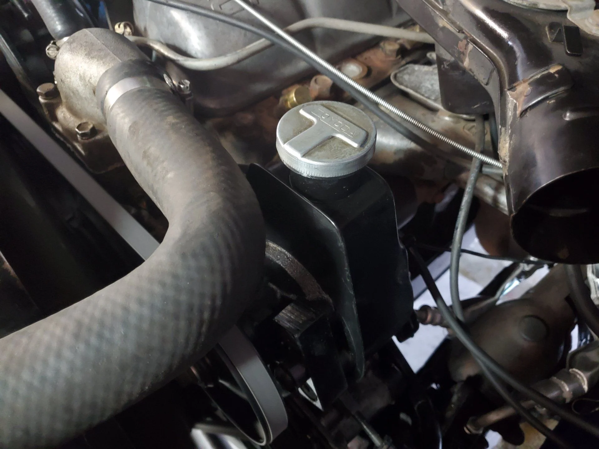

All done with my install! Thanks, Georg! And 4wheelfever, for making it so that my factory "Toyoda" cap fit on the Saginaw cap! Super excited!
Nik
