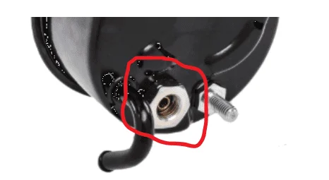

i did this conversion a while ago and enjoyed the better steering. I had a helluva time getting the fitting right, as my #7023 pump from Oreilly's came with 5/8-18 fitting instead of metric like OEM. Eventually I got the right fitting, cut the power steering hard line, put on new fitting and reflared. Got it to work without leaking.

FWIW, we now supply the SAE fitting for the factory HP line with the kit at no extra cost. We also offer an already modified HP line for $79.

or the fitting to go within the Saginaw Pump that then attaches to OEM HP Line. that would be even better
Thanks. It would be cool if you offered as part of your kit the fitting that goes INSIDE the Saginaw SAE equipped pumps that would allow people to use the OEM HP line with no alterations whatsoever. Seems like you should be able to remove that, and replace it with a correct for Toyota fitting.

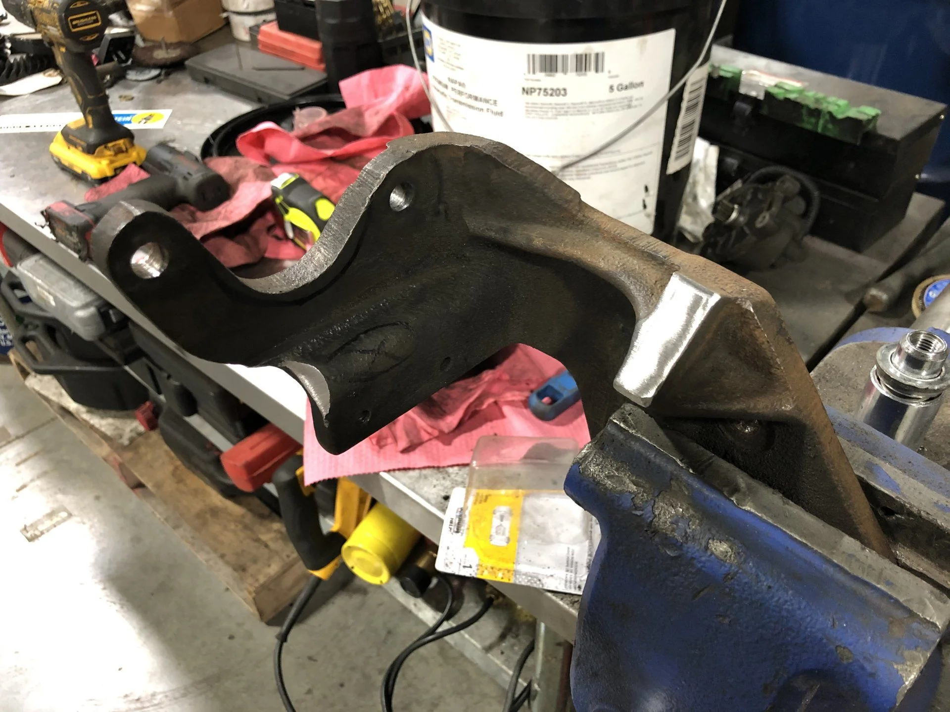

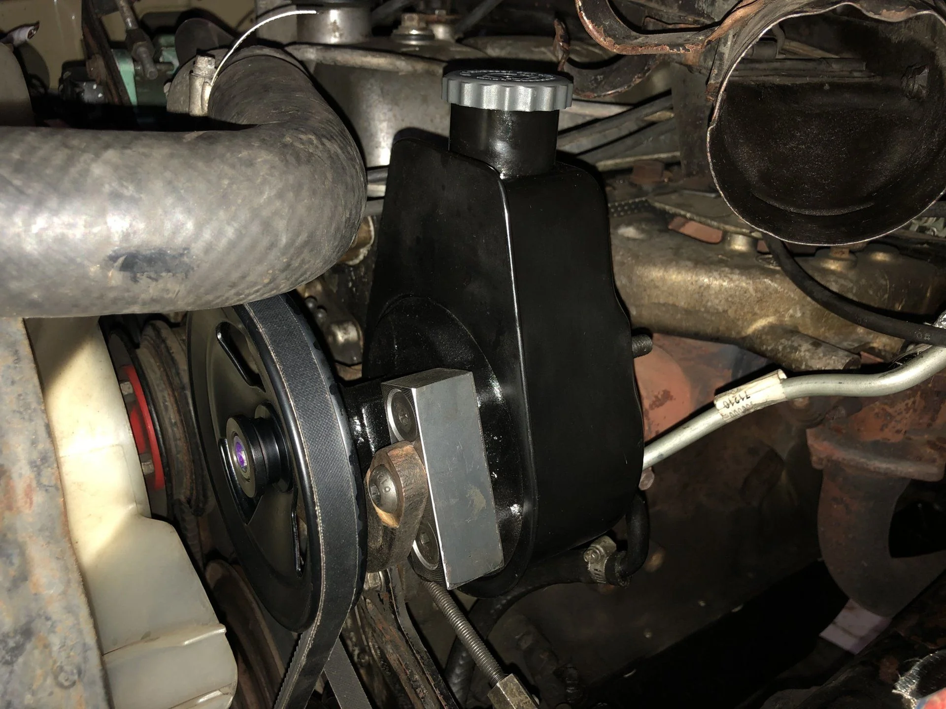

Just installed one for a customer. Nice kit. Used 732-2137 from RockAuto, and also Dorman 82581 cap. Got a new high pressure line, cut the fitting off. Installed supplied fitting and re-flared. Had minimal trimming to do on the stock bracket. You can see I mimicked a picture here for areas to trim, but didn’t have to. I’ll let the pics do the talking.

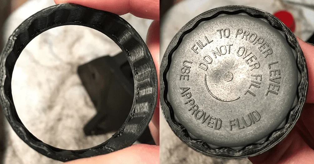

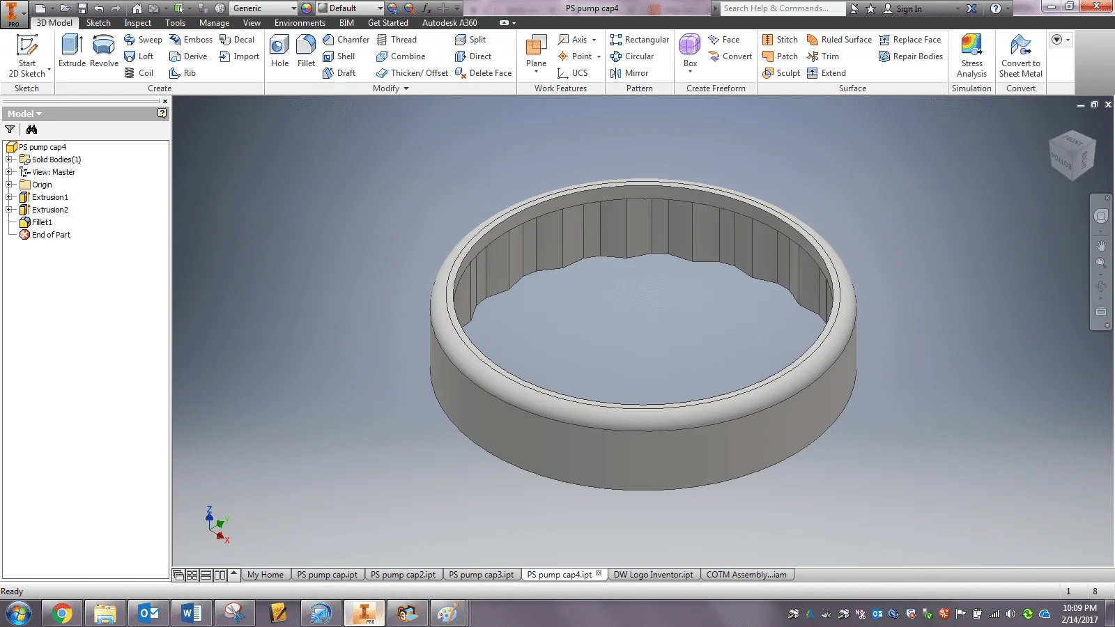

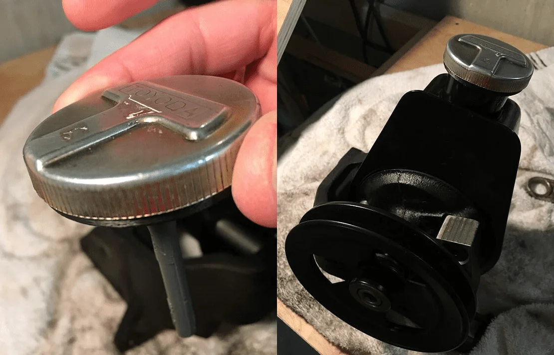

I've been drawing and printing an adapter for the new PS cap to the one I pried off the TOYODA pump cap. On the 4th try I think I got it right, printed out of ABS I think it will hold up. It fits snug enough hand pressed to stay but I think I will add a little RTV silicone.
4wheelfever, I PayPal'd you money yesterday for a cap! Thanks for extending that offer to everyone here! Definitely helps complete this swap!
