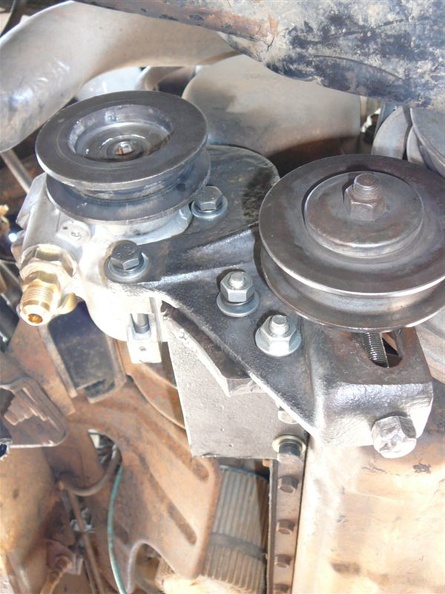

We've built a few prototypes and they've been up and running for a while. Came up with is final design after collaborating with another fellow mudder Brad and then modifying that design slightly a couple of times we've finally come up with a kit we're happy with!!!!
The factory 2F ps bracket is retained and slightly modified to work as a cradle for the sag pump.

For better install pics, see page 6 and 7 in this thread.

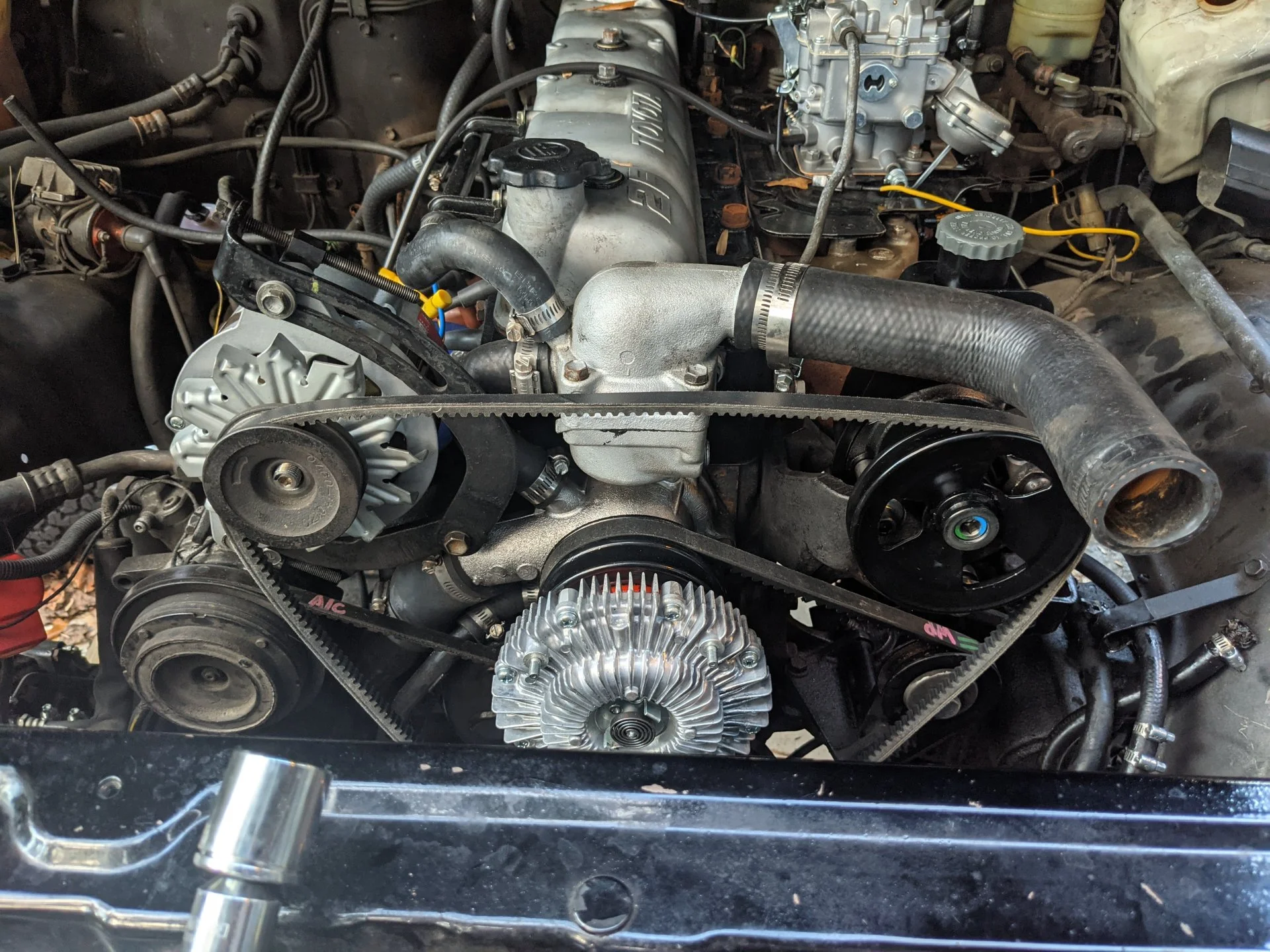

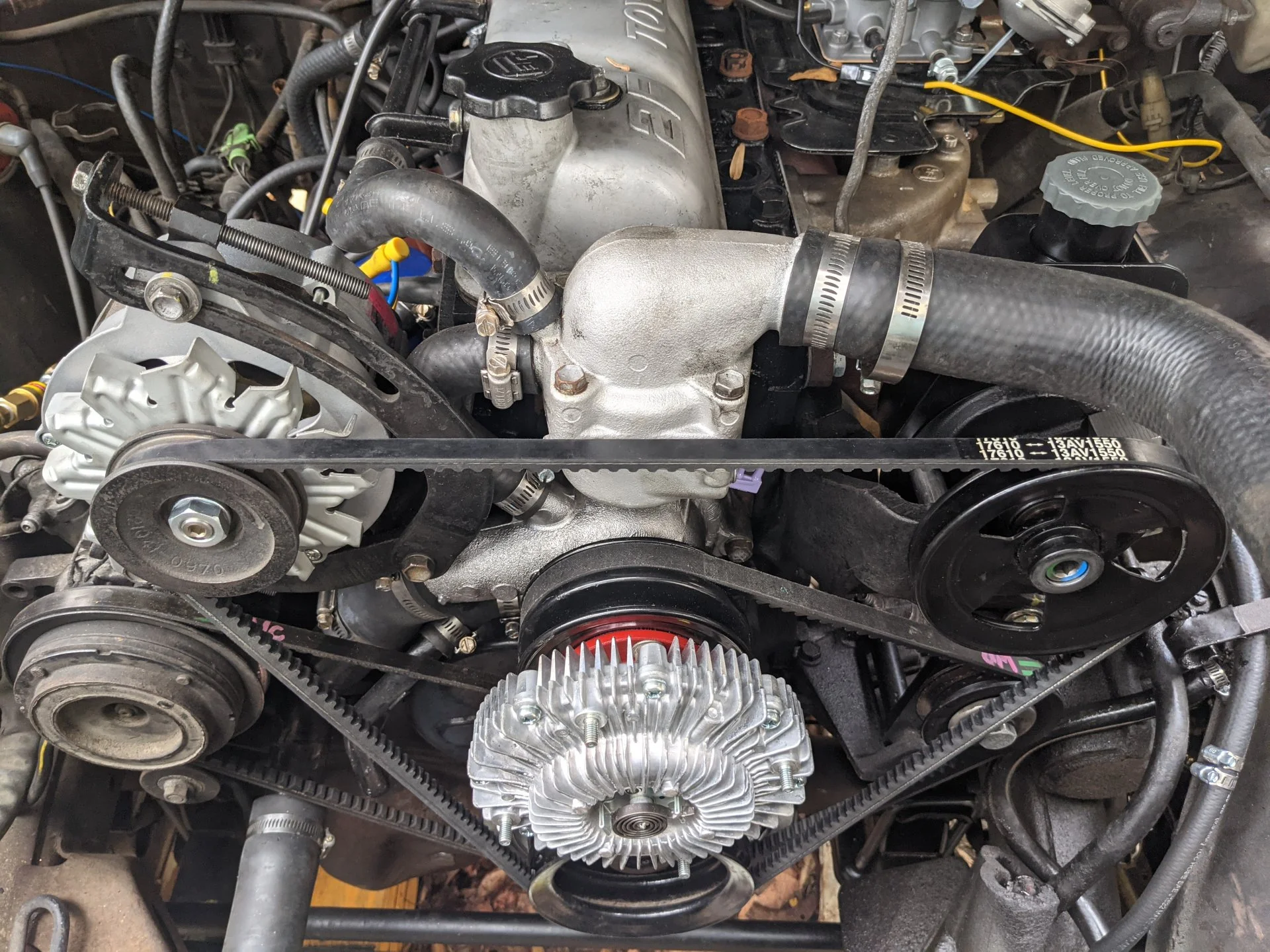

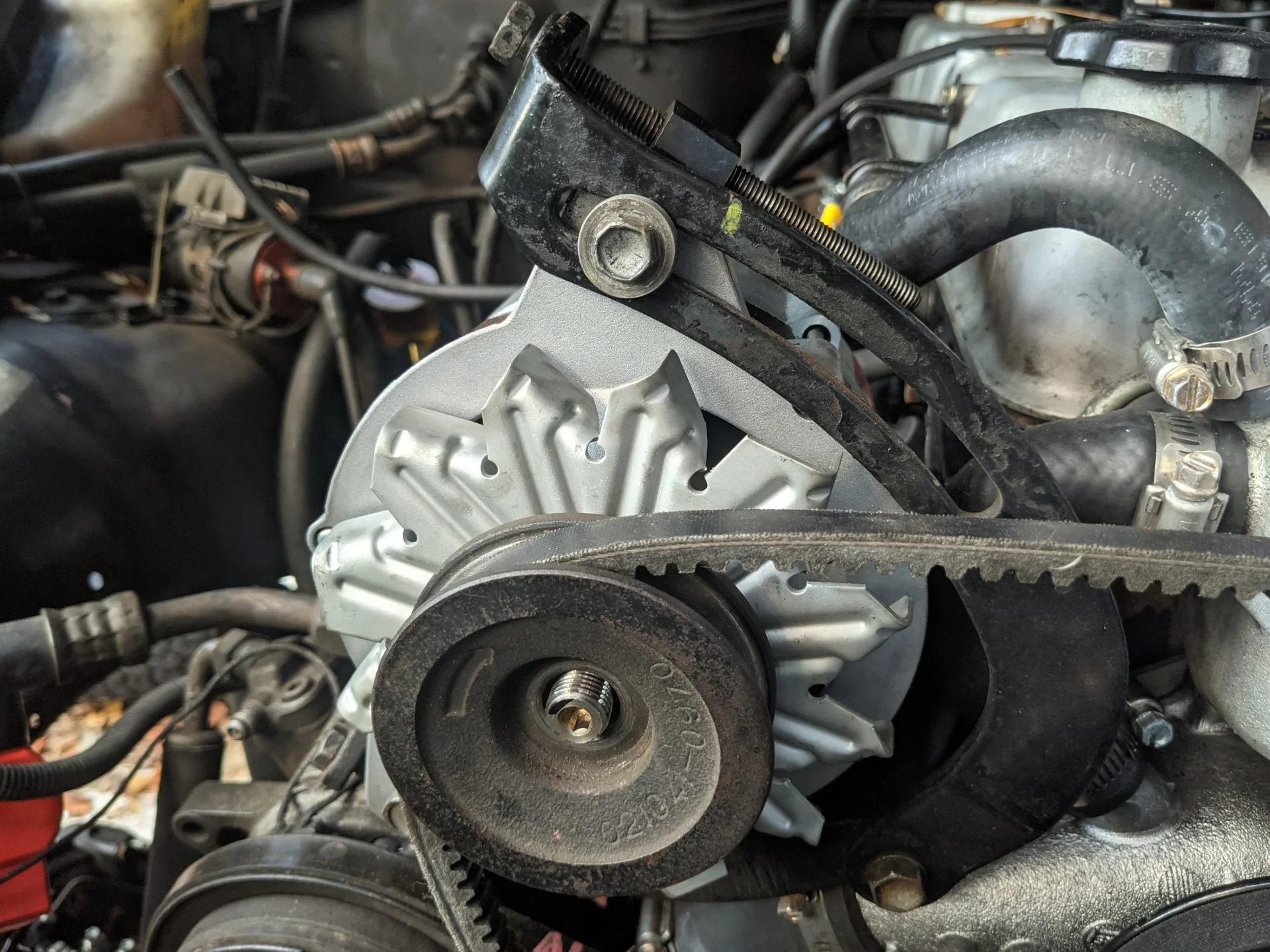

Is there a slightly shorter belt that works? The belt from the kit I received is a little long for my application, I am putting in an alternator from an 80 series at the same time.
The kit worked wonderfully however.

Thanks for the help. It isn't tight with either the pulley the alternator came with, or the pulley on my original alternator. I just have very little adjustment room to work with due to the fit of the new alternator.

Did you get a chance to look for a belt?
Sorry about thread spam, for those who also have this length issue the last 3 duralast part numbers represent length, so I bought a few smaller belts and 17610 worked well. 17615 also works but I didn't get as much adjustment as I was comfortable with.
