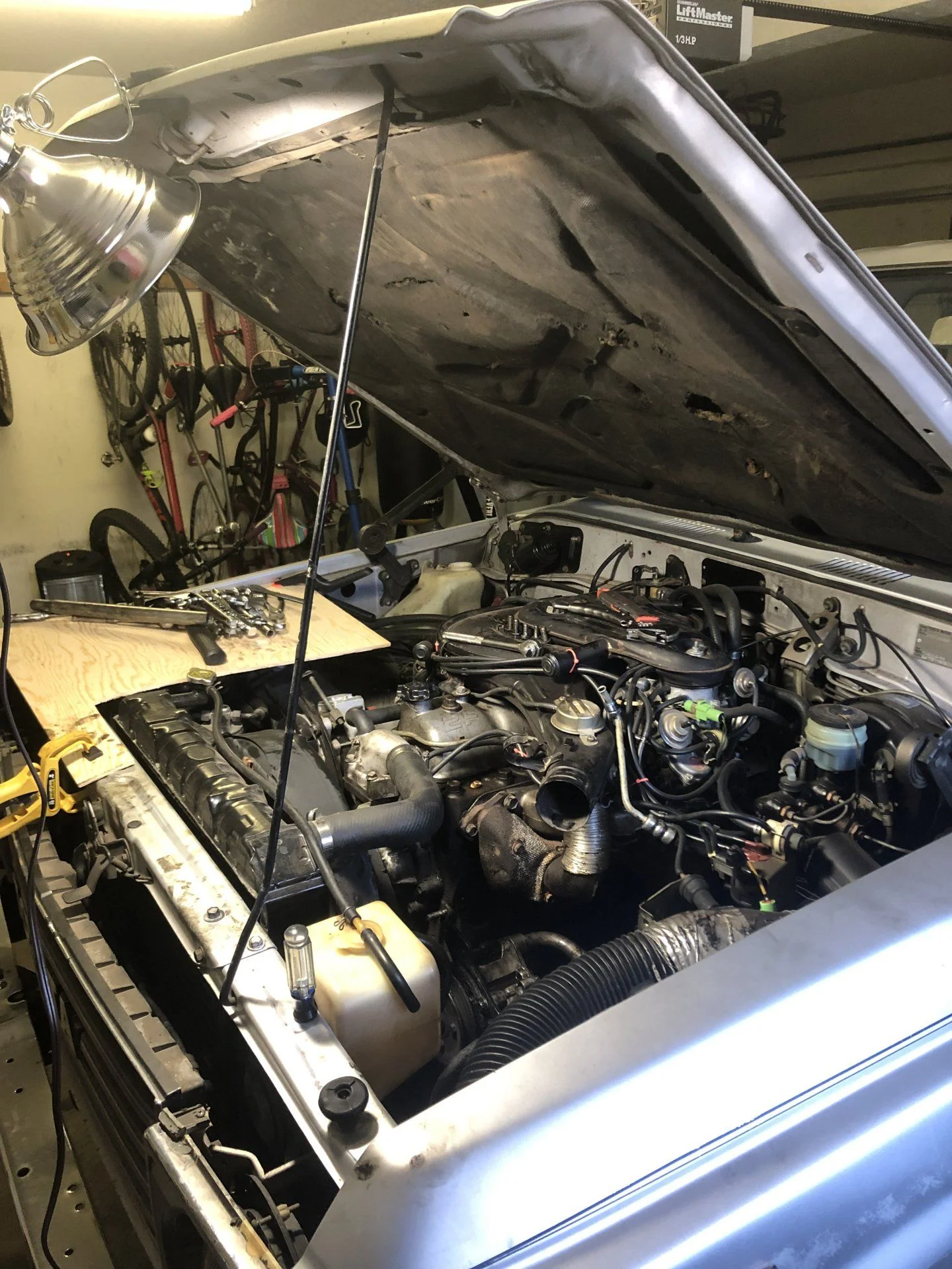

Got the kit from Georg and everything went in smoothly. This was a fun and satisfying project. Steers like a dream now!

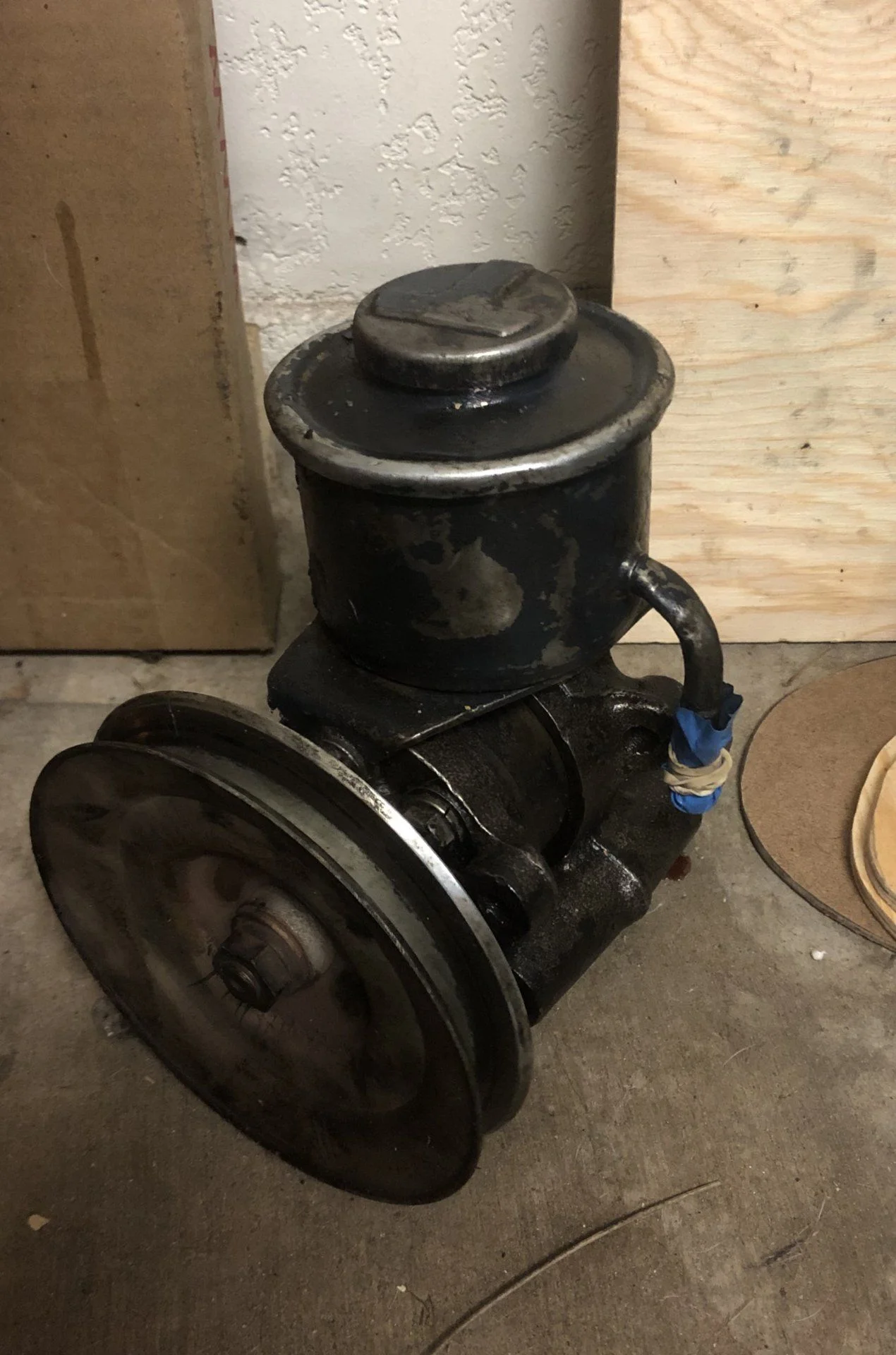

The only way to not have to worry about a possible leak issue is to buy a new pump from Toyota but they're over $400.
Georg @ Valley Hybrids
If anyone wants to stay OEM City Racer generally has new PS pumps for 210, they seem to be out of stock currently but I bought and put one in last month. Power Steering Pump for US Land Cruiser FJ40 FJ60

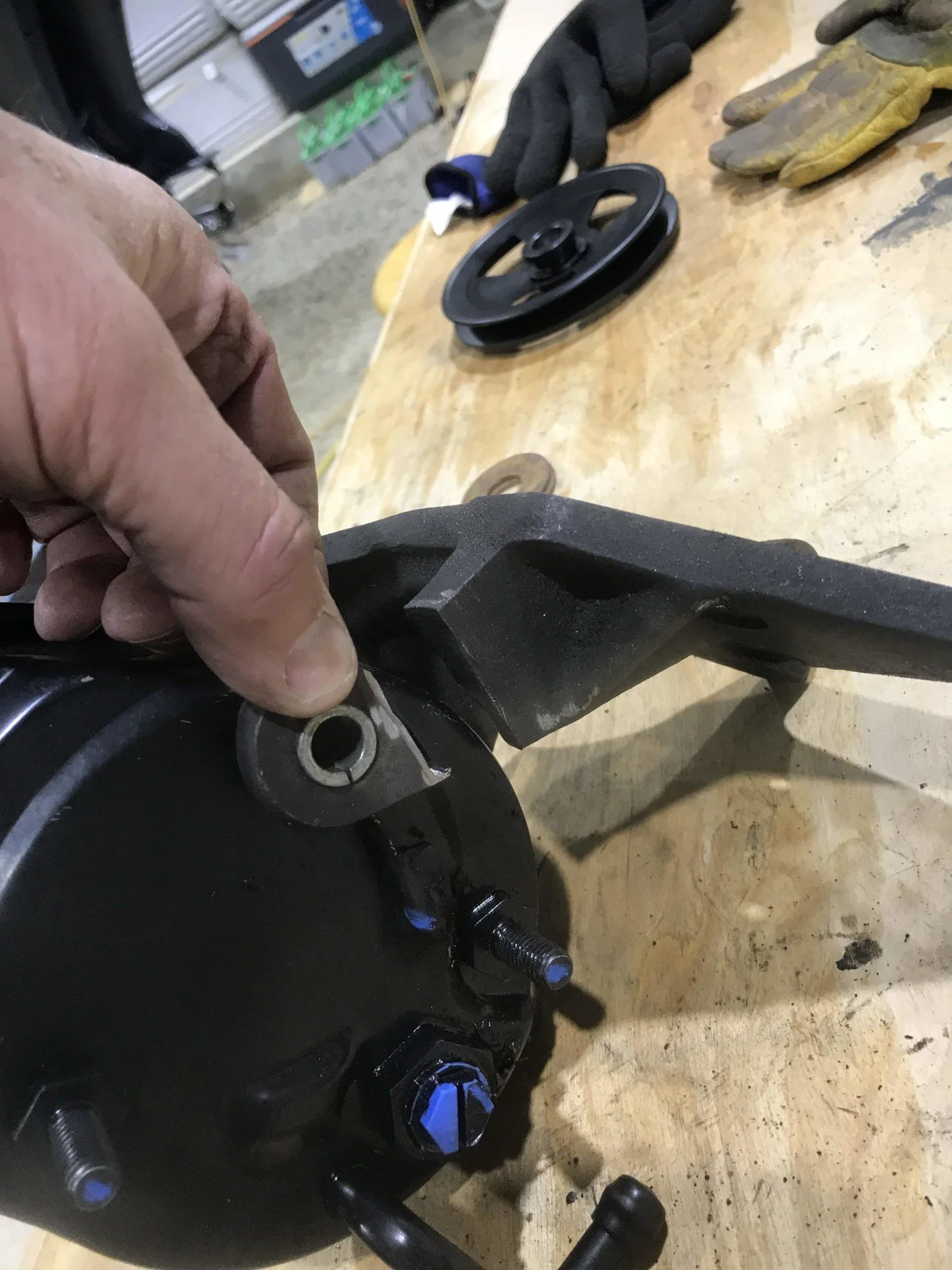

I got my Sag conversion and Jim's Air Pump idler installed. Honestly if I can do it any fool can. I am dangerous with a tool in my hand ;) I did want to include a picture I think will help if anyone needs to know which part to grind/cut off on the OEM bracket. I know I had quite a bit of trepidation when I cut off the mounting hole.

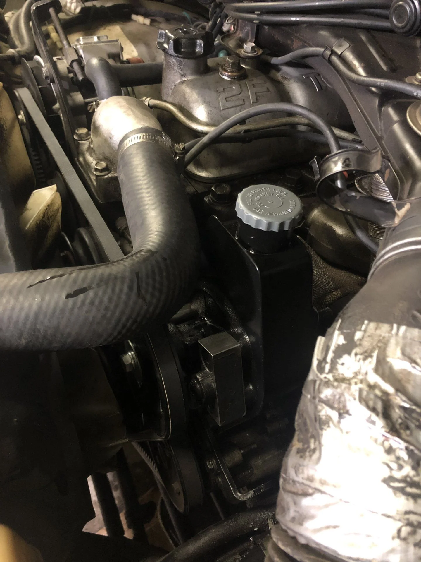

Got my kit a while ago thanks Georg!
Did the cutting with a Sawzall and a 14 tpi blade, cut through like butter.......the grinding with my Hitachi angle grinder
Used 4wheelfever's visual instructions, the pump bolted right up and cleared with no measuring!
O'reilly's pump 732-2137, rented their pulley installer kit, putting the pulley on with that was the easiest part
Sorry about the giant images
Hey, I bought that same pump from Oreillys, fit was great! Do you have a part number for the cap you used? Thanks for any help
MTM 82581 got it at O'Reilly's at the same time
