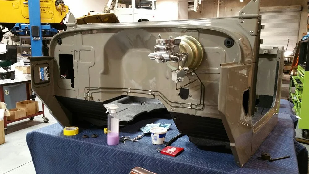

The body tub is painted and starting to re-assemble with brake booster/master and hard-formed brake lines across the firewall.
Engine compartment completed. It’s a very clean firewall as all unnecessary holes have been filled. Battery is setup at the firewall and exposed wiring kept to a minimum.

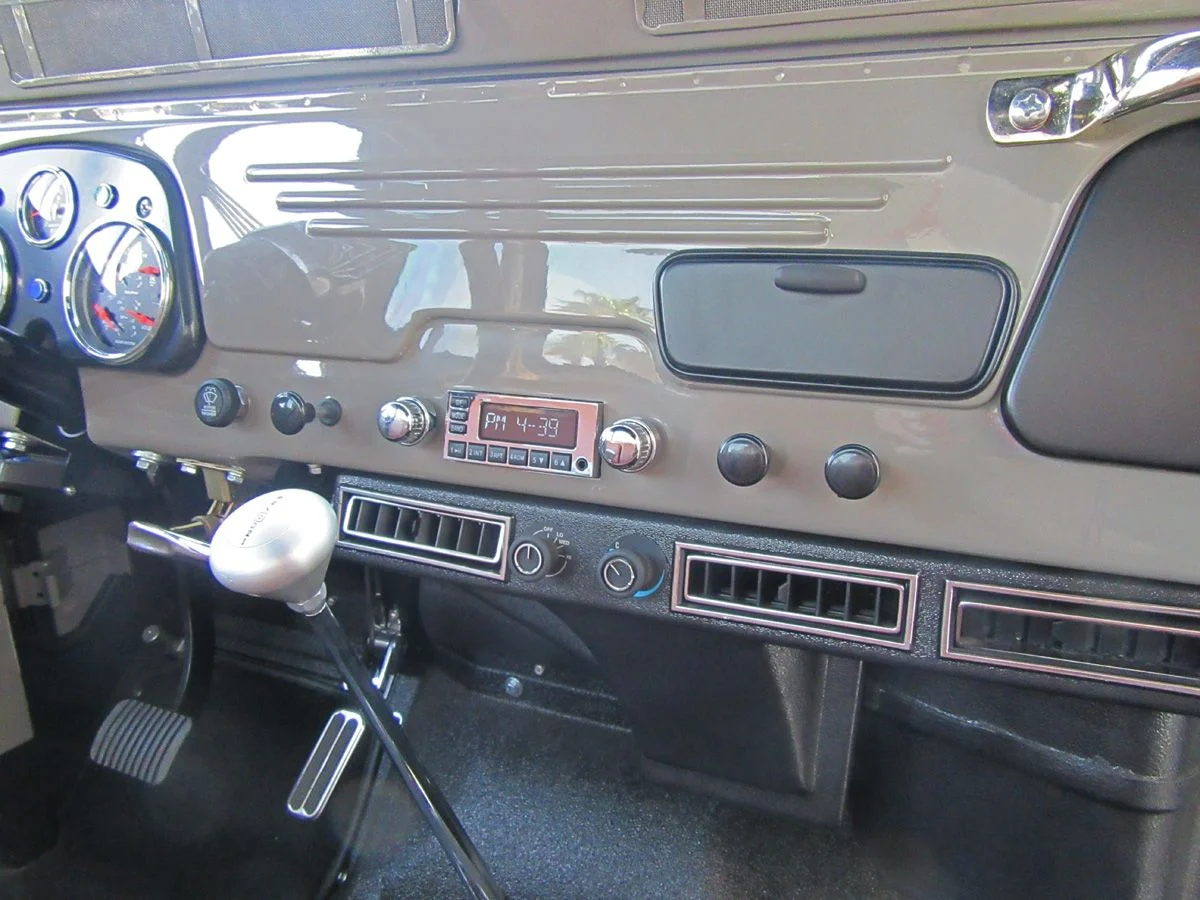

Interior is kept simple. Seats installed and excess dash holes filled and metal finished. A new BTB dash assembly with Auto-Meter gauges has been installed.
A Vintage Air air conditioning unit has been installed with a Retro Sound radio in the dash. Line-X coating has been applied to both inside floor and under cab areas. It was also added to both sides of the truck bed.

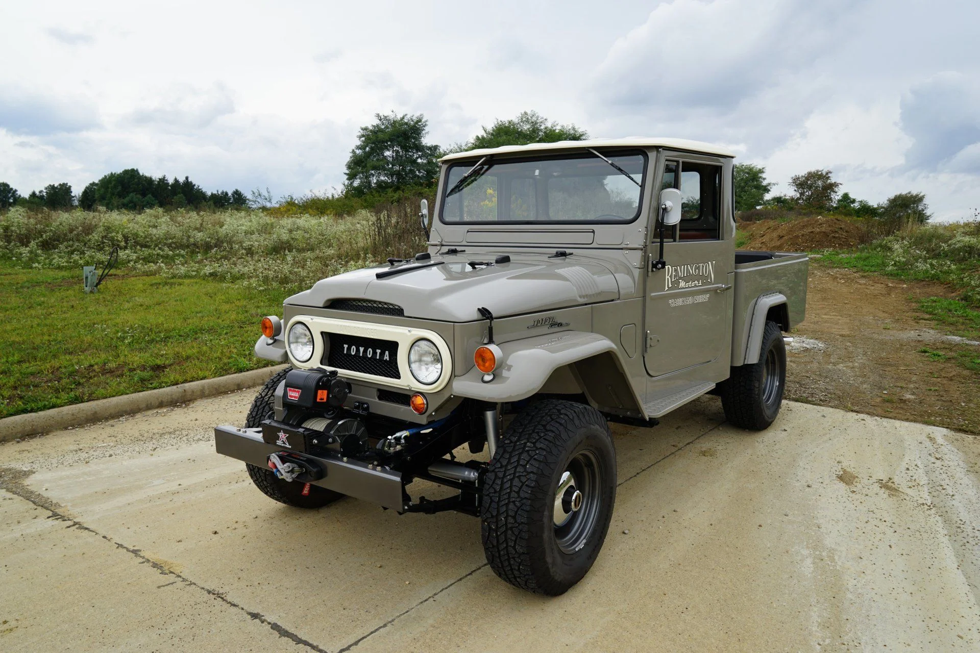

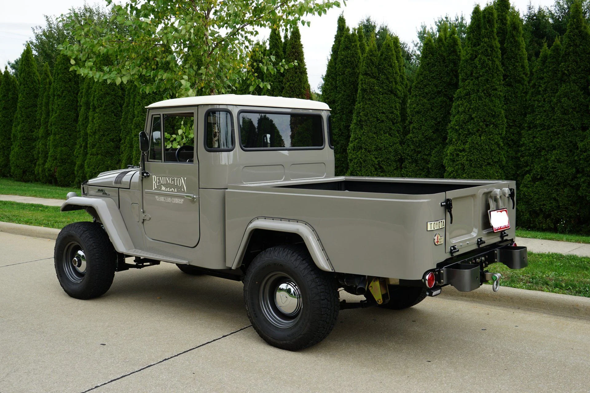

The end result! The owner lives in Ohio. He had some graphics made for the doors with his name associated with the truck. This is the fourth Land Cruiser BTB has built for him.

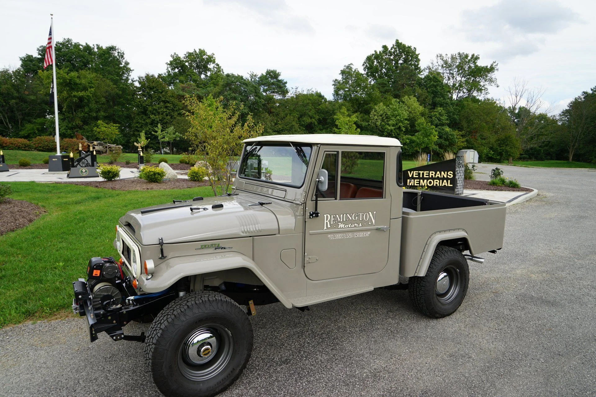

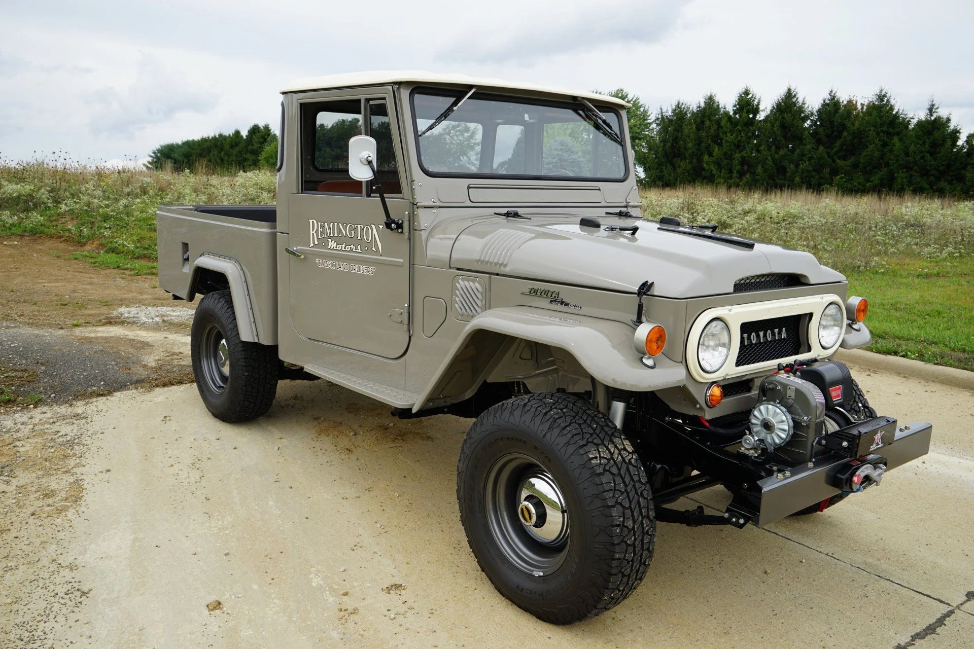

Some more views.
Port side view.
