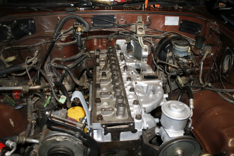

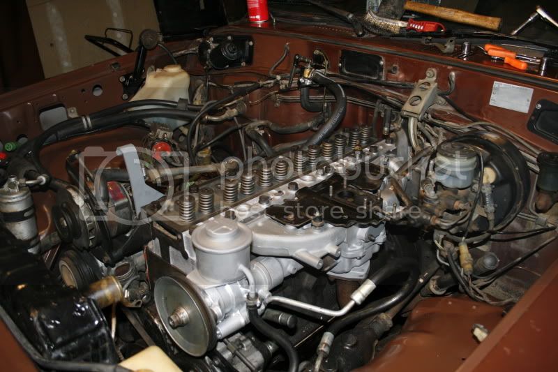

Does anyone have advice on how to get the intake/exhaust manifold back on? I messed with it for over 2 hours today and couldn't get the bolt holes lined up on the head. The two head studs were fairly easy as were the three on the exhaust pipe, but I'm having serious issues with the rest of them.
Thanks!
Sadly, I will not have this thing running before I go home for a week. I am still waiting on my rebuilt carb and distributor (was only supposed to be 4-5 weeks!), a water pump gasket, and silicone tubing from McMaster's. Regardless, when it arrives I should be ready to plumb all the new vacuum hoses and bolt up the shiny parts.
After almost stripping the rear most hole on the rear of the head (near the firewall), I got it back in usable condition and was able to bolt my intake/exhaust manifold back up. This is a real PITA on this truck, I literally have to stand on it and bounce it around to get the holes to line up right. Hopefully, I won't have to pull it off anytime soon.

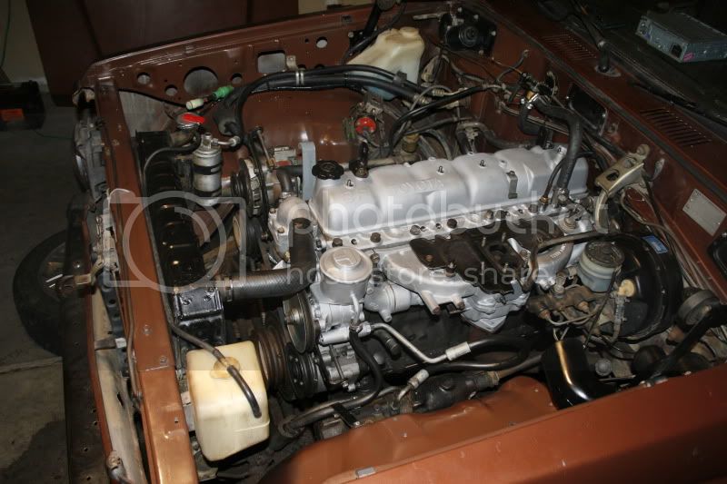

Got a little more done. Water pump, tstat housing, new spark plugs, and still trying to clean things up. It pales in comparison to Prowler's rig, but it's looking A LOT better than it did.

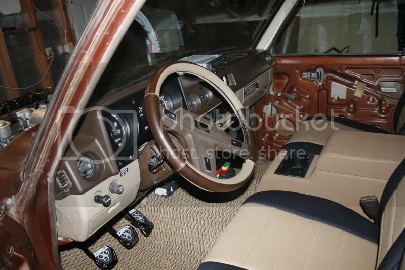

And I found this steering wheel cover at the auto parts store. Matches my interior pretty well!
And yes, door panels are in the works!
I've got some swatches from the tan color on my seats so I'm going to buy some material to stitch together. It won't be too fancy but will look a little more 21st century than the striped brown and tan look that came stock.

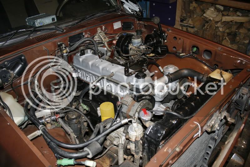

Carb and distributor are here FINALLY. Now I'm trying to figure out how to plumb it without all of the smog junk. Startup time is so close I can taste it!
Scroll back to page 3 to see before pics of the carb. It was FURRY!

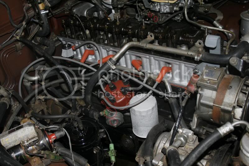

I've gotten some of the hoses run. Currently trying to make sense out of the Toyota schematics and isometric.
Distributor is looking nice too.

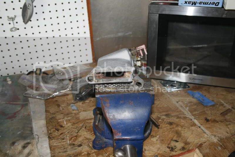

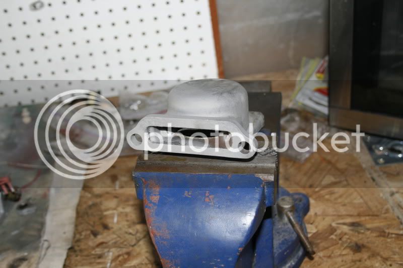

I busted my thermostat housing so I upgraded to a new one. The new one doesn't have any BSVS plugs so I think it makes it a little cleaner.
Old and busted.
New and slimline.
