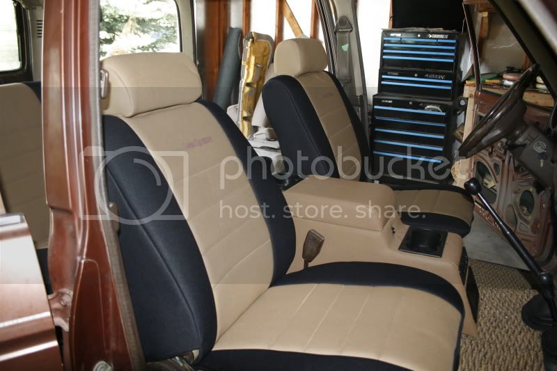

Got the seats installed.
I'm happy with the color match to my lower dash and new center console.

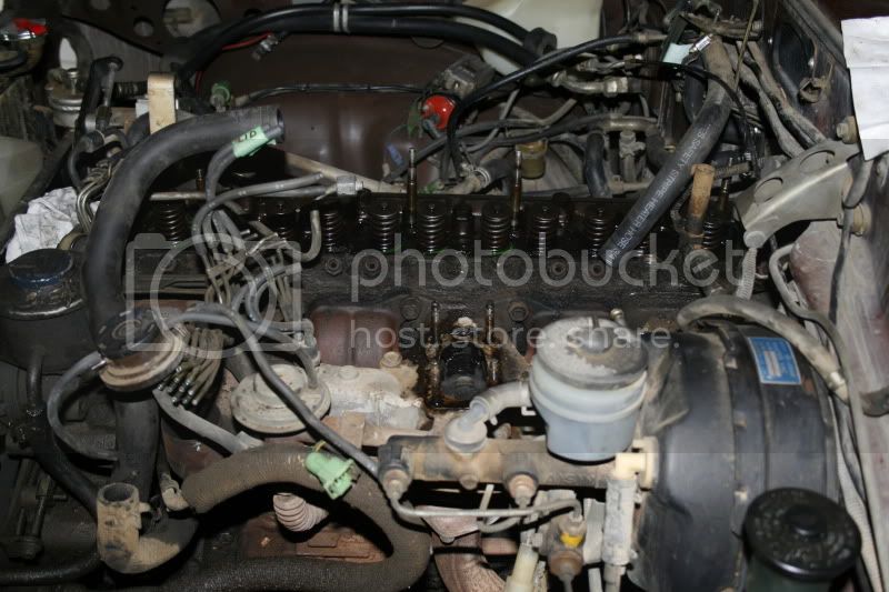

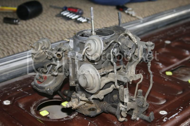

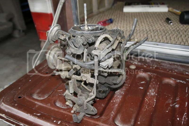

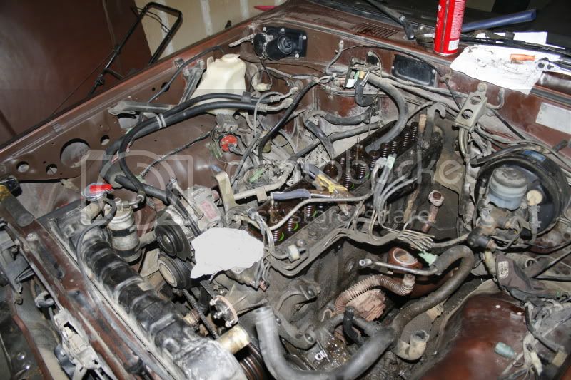

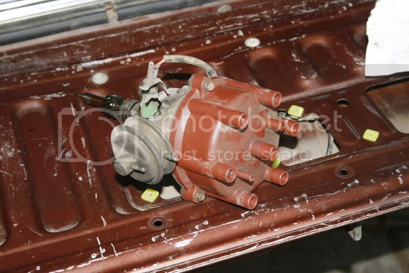

So, I get back to my rig now. I pulled the valve cover, carb, and distributor. I am sending the carb off to be rebuilt and tuned as well as the distributor to get re-curved to my specs. I've never rebuilt a carb so I will gladly pay someone for me to save my sanity.
This car is in need of some serious TLC. I can't wait to get it back all shined up.
Dizzy was in pretty good shape but I might as well have it cleaned up along with everything else.
I can barely fit my hands anywhere on my Audi but the 60 is a totally different story. Having a big engine bay is nice. :D
This is where I am currently.
I hope to have the head pulled this week. After that, I'm going to start working on the bottom end. If I can have my motor running by July I will be ecstatic!Thanks for reading!
Oh man, those seat cover look great!
Make my SOR duck covers look like crap :flipoff2:
Wish I had seen those first...
Great improvement on the seats, i can't take the "Herb Tarlek" looking stock brown interior.

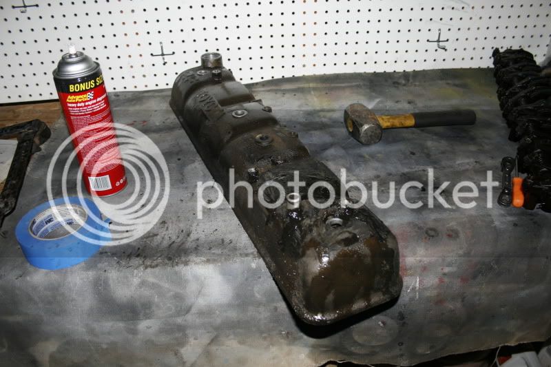

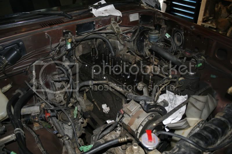

Been putting in 30 mins here, and hour there, slowly getting my motor torn apart and ready for a rebuild. I had to hack my air rail to get it off but with the desmog already commenced that shouldn't matter. The air rail, air pump, and various hoses and check valves are being chucked to free up real estate. I think I am just going to devane the smog pump instead of spending the extra $ for a pulley. This may change though.
Lots of parts to clean up and make shiny.

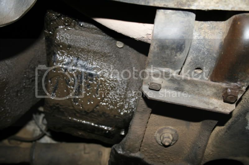

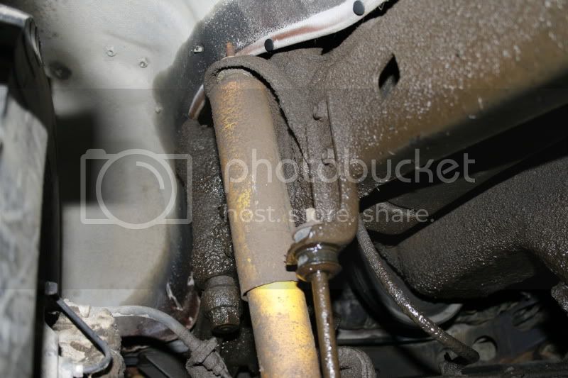

Here is an idea of all the leaks this thing has going on. The entire front end is caked in oil and PS fluid. I guess its a decent rust preventative.

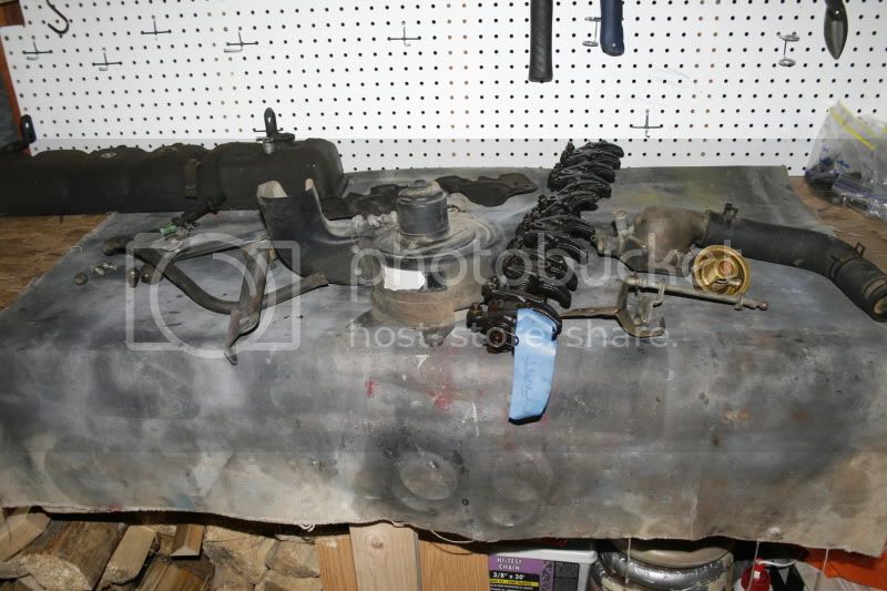

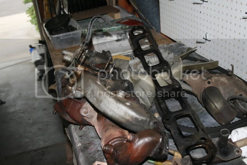

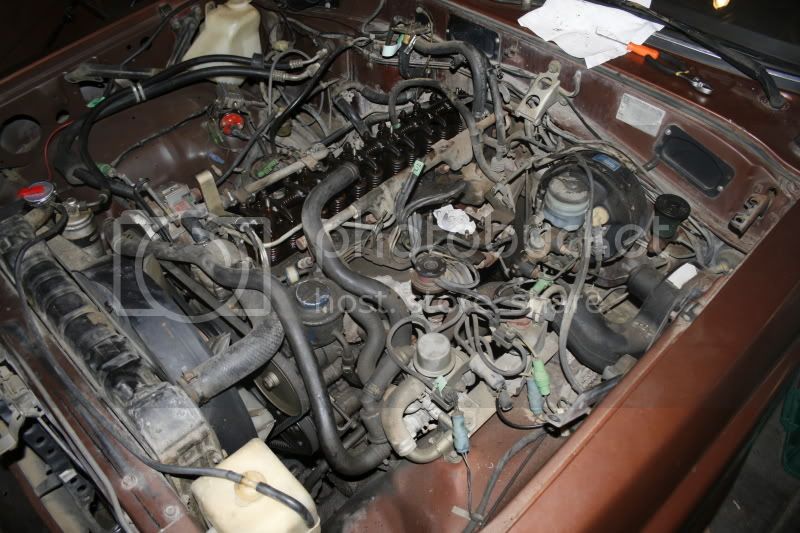

I got the intake and exhaust manifold off. I also got the power steering pump off and will be rebuilding it. Fortunately, the main shafts bushing is intact so I can just replace the internal o-rings without having to buy a new/reman'd PS pump. I am also still pulling a lot of the smog junk and modifying it to be a smogless truck. It's quite a pain.
A pile of dirty parts that will soon be bling-a-fied!
Here's an idea of how grimey EVERYTHING on this truck is. I have already gone through a box of 100 latex gloves and a carton of shop towels. PS fluid, motor oil, and 28 years of dirt and junk.

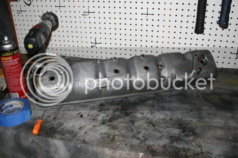

Of course, degreaser and a wire wheel makes short work of it.
Installing everything after being completely cleaned and a coat of high temp paint. This is crucial for spotting new leaks.

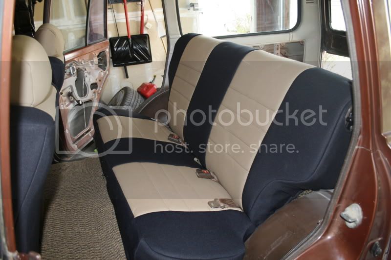

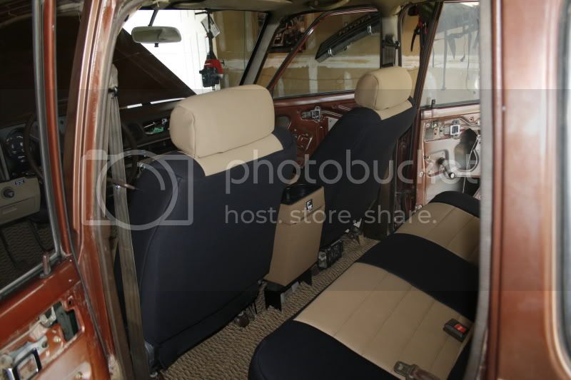

Seat Covers
New bling. Front and rear Wet Okole covers with sewn in logo. I got a decent stock passenger seat and restuffed the drivers seat. They are both pretty comfortable and will be styling with the new covers. I'll probably install them this weekend.
Would be interested to know if you have any experience with these seat covers in a hot climate. I realize you're still building the 60, but wondered if you used these on one of your other rides. I'm in AZ, 1/2" from the blazing sun, so wondering if these get crotch and thigh incineratingly hot during the summer. Otherwise, righteous build bro, keep it goin!
Glenn in Tucson
A friend of mine had them in his Tacoma and they were nice. But they're still seat covers, ya know, how nice can seat covers really be?
Anything is better than black leather though. Imagine how hot these babies get in the summer, especially with 1/2 doors!

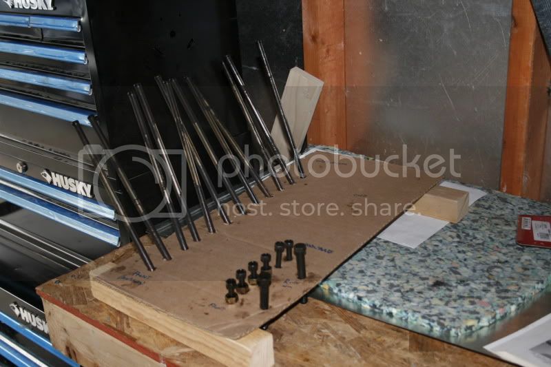

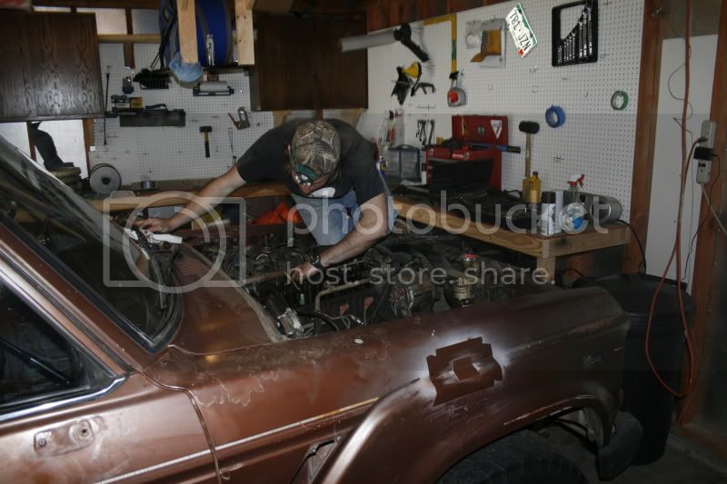

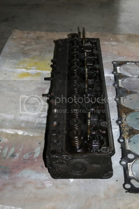

Head is off and going to the machine shop tomorrow. By the time I get back from Moab, everything should be about ready to reinstall.
The head is getting
-hot tanked (read: shiny and clean!)
-complete valve job
-oil gallery plug drilled and tapped
-OEM gasket
-OEM valve guides
All of this at Gunn Automotive here in Denver. I have heard great reviews about them, apparently they are the best in the business.

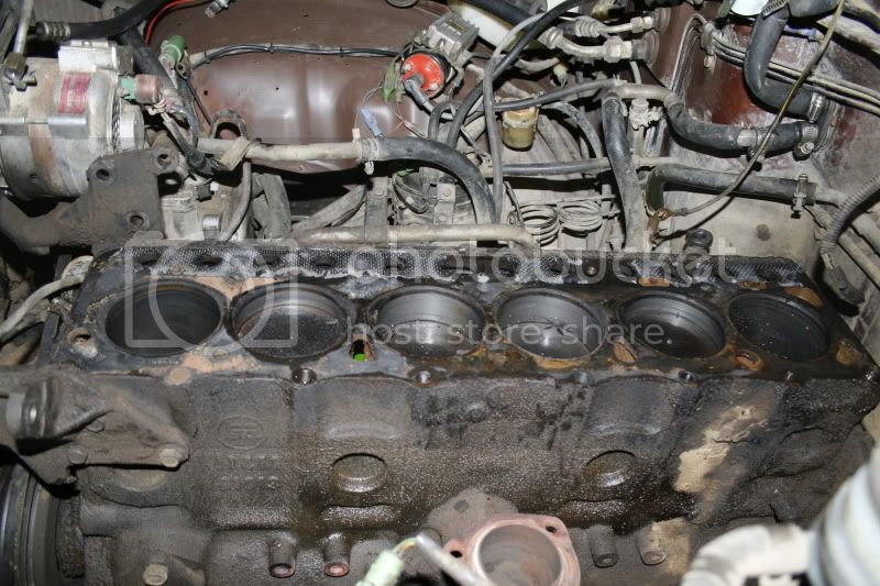

The grimey head next to the old gasket

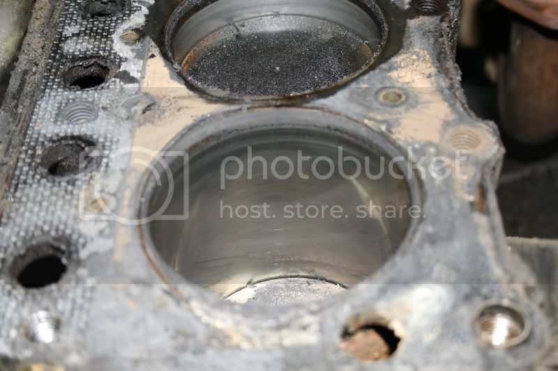

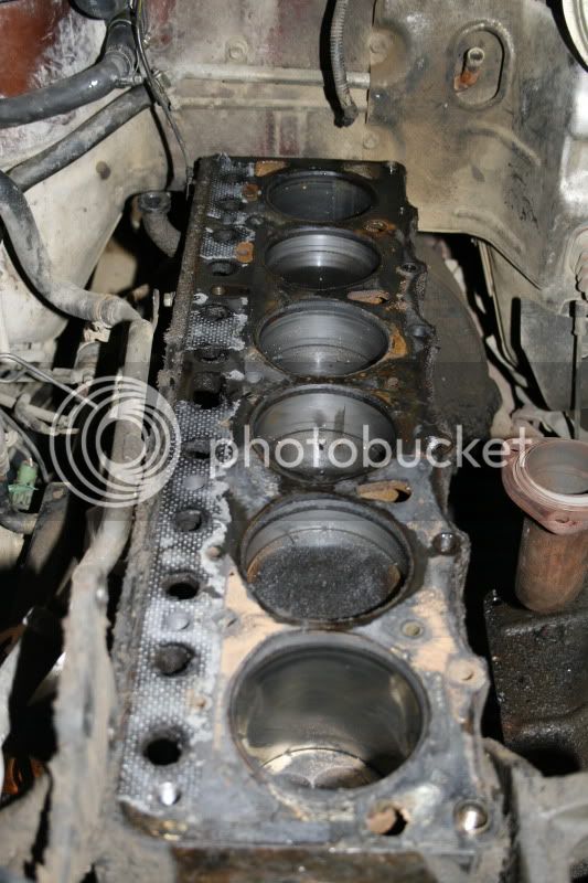

Top of the block (lots of cleaning to do)
Driver's side
And I don't know what kind of cylinder crosshatch I'm supposed to be seeing here on a motor with 200K miles on it, or how that really works but this is what I see. The cylinder wall seems fairly uniform on all 6 cylinders. I guess this is a good sign for my piston rings.
The top of #2 looks a little off as does the top of the head around #2. It'll be good to shave a little off the head and get the valves sorted.

I have also been told that the only way to guarantee a good carb reseal is to by a new heatshield plate that goes in between the carb and intake.
I'll be sending my carb and dizzy to Jim C when I can have them off for a while.
