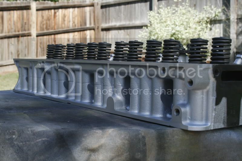

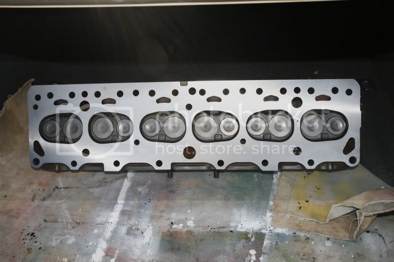

So I haven't touched this thing since I've been back from Moab but I did pick up the head from the machine shop. It got a complete valve job, new valve guides and seals, got the oil galley plug drilled and tapped (I don't have a good enough tap and die set to do it myself), mounting surface decked, and magnafluxed. Now it's all purty.

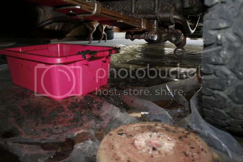

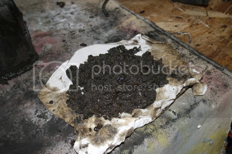

And then I started cleaning up the motor itself. Basically for 10+ years it had grime from a leaking PS pump, oil pan, pushrod inspection cover, valve cover, and pretty much everything else you can imagine. It will probably take another week to get it completely cleaned up before I put the head back on and start the reassembly process.
After a can of degreaser and some love from a wire brush the garage floor could use some cleaning now.
But it's starting to look alot better.

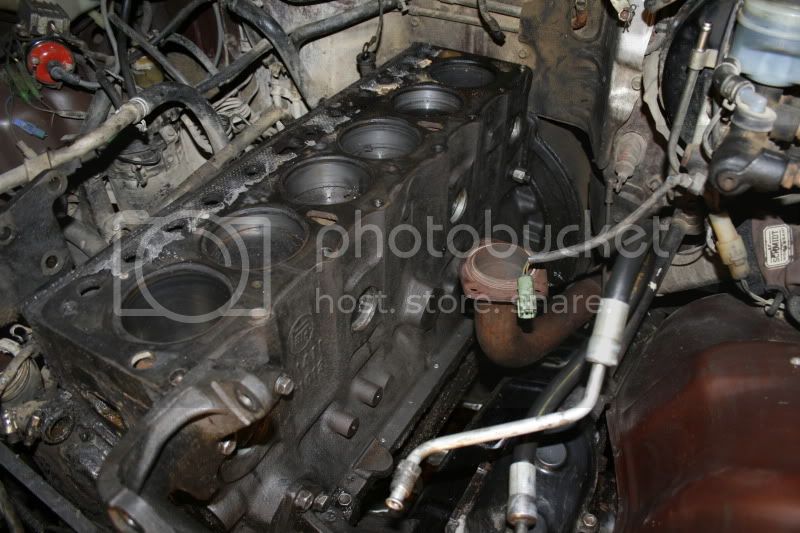

So everything is done, rebuilt, cleaned up, etc. All that's left is to put it all together.

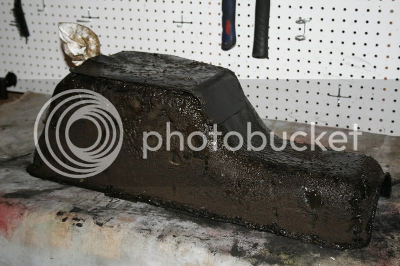

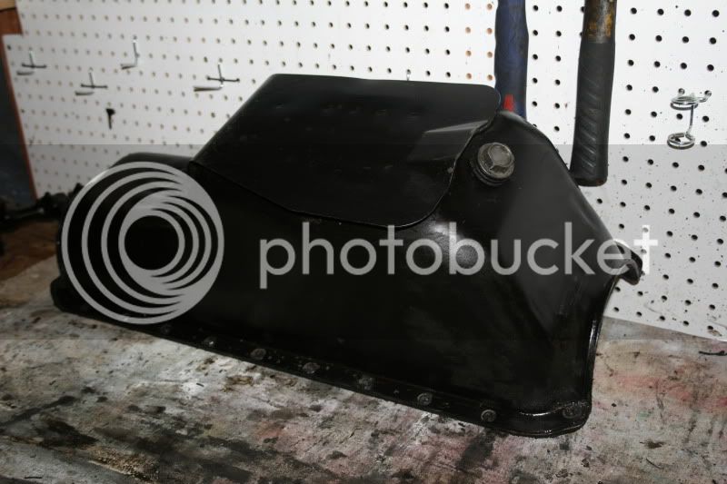

I had a couple hours tonight to pop off the oil pan, clean it up, and prep it for a new gasket. The bolts on the oil pan were not even finger tight, no wonder it was leaking. This is how it looked when I pulled it off.
And spent a little time with the plastic razor attachment on the gasket scraper to get off most of the junk.
Then cleaned it up with some degreaser. At least I didn't have to worry about it rusting.

And how much did the work on the head run you? If you don't mind me asking cause I paid $234 for Block cleaning, honing, valve job, decked, and resurfaced my flywheel but they did shoddy work. The holes in the head for the pushrods were not even circular like yours.

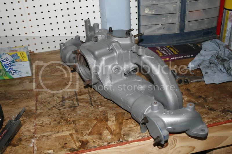

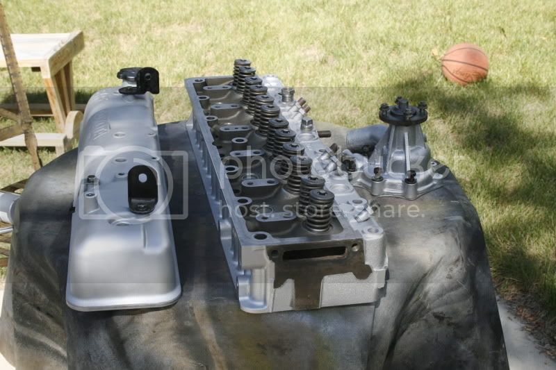

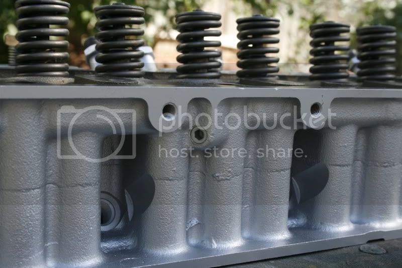

Today I started out by painting a few things. I was told the head would get surface rust after being hot tanked (I don't really know about that) but for good measure I put a couple coats of high temp paint on it.... along with my water pump, exhaust/intake manifold, and valve cover.
Here you can see the drilled and tapped oil gallery NPT plug.

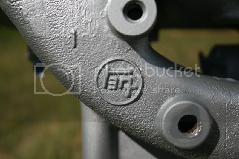

Here's a good picture of the finish (corner of the intake manifold)

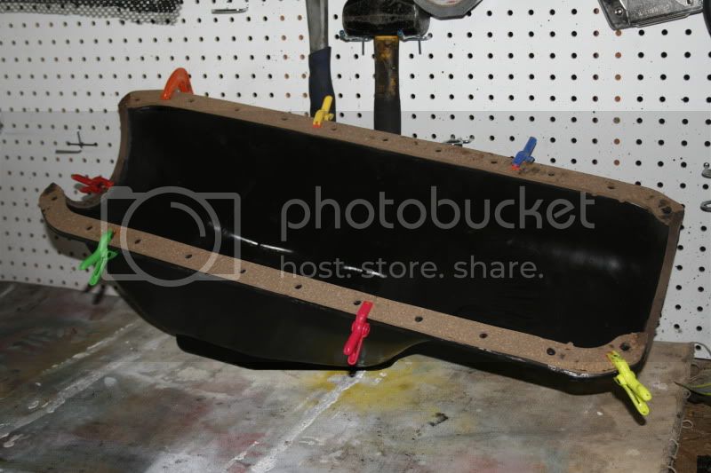

I got my oil pan all RTV'ed and gasketed up and mounted that back on the block. Hopefully that doesn't leak again because there are 24 bolts on the pan and 5 on the bellhousing dust cover... not fun to mess with all of those bolts.

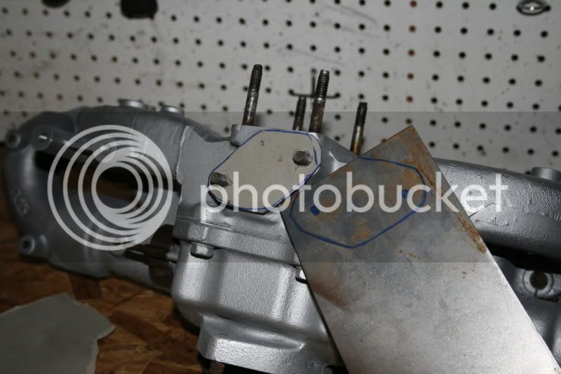

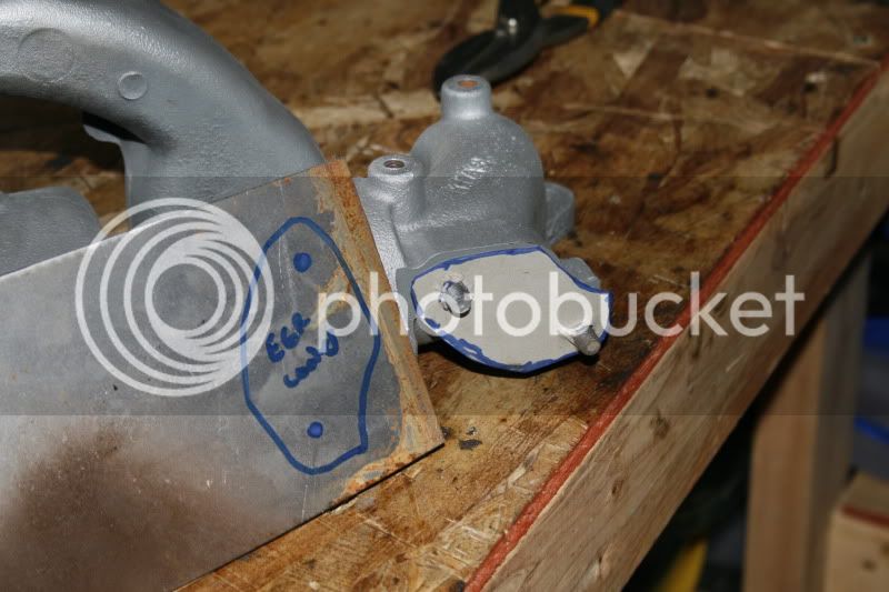

I also made a couple of plates for my EGR cooler blockoff and the PCV blockoff. I know blocking off the PCV isn't the best idea as it will cause acidity in the crankcase but it will still be vented. I still need to find gaskets for both of these; I thought they would've been included with the head gasket kit as you have to take BOTH of those things off to remove the head but I guess not.

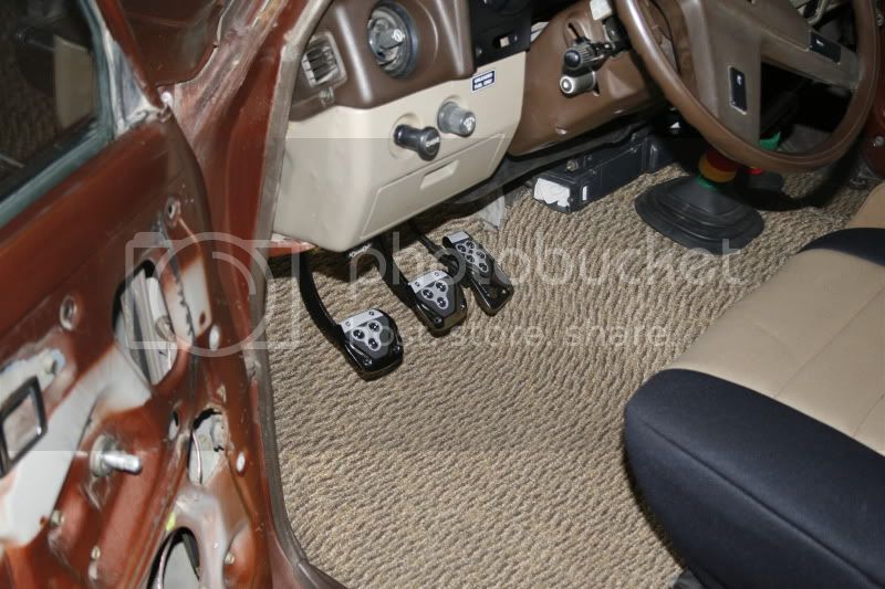

Here is probably the BEST mod of the day... maybe even the century. Every so often an automotive invention comes along that changes the way we look at modification, driveability, babies, Luxembourg and other things that are also somewhat important. I present to you.... THE 7 DOLLAR SUPER TECHNICAL GYMKHANA APPROVED, AUTOBAHN TESTED, HARBOR FREIGHT PEDAL SET!!! I don't know how many more horses this gave me (thinking somewhere in the 70-80 range) but it cannot be fooled with.

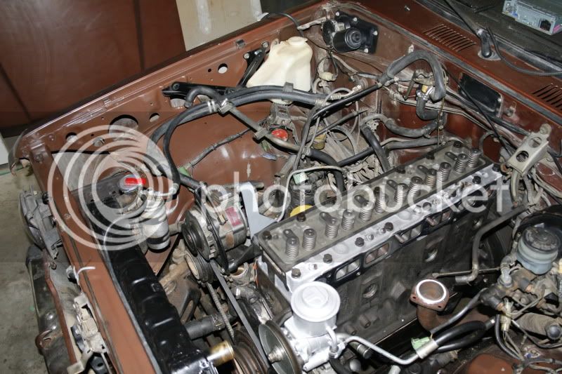

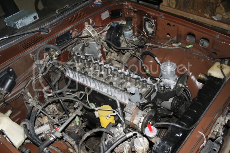

Starting to put everything back together but still waiting on a couple of parts to arrive. Mostly gaskets, intake fittings, and other miscellaneous pieces. I've never done this vast of an engine overhaul so I am excited to see how it turns out. At the same time, I'm scared that there will be numerous leaks, maladjusted belts, electrical gremlins (having fought with the PO's previous wiring rat's nest), or catastrophic failure. Keep your fingers crossed for me!

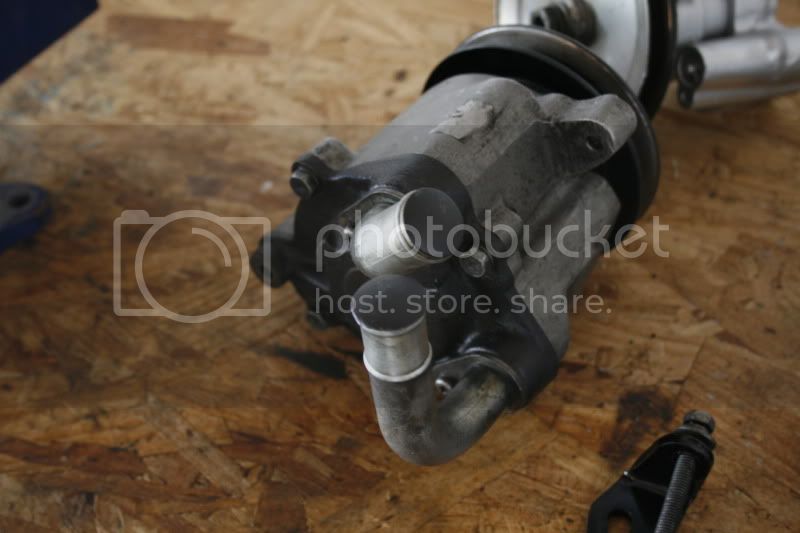

Got my smog pump devaned and the air rail holes plugged up. It's essentially going to act as a pulley.

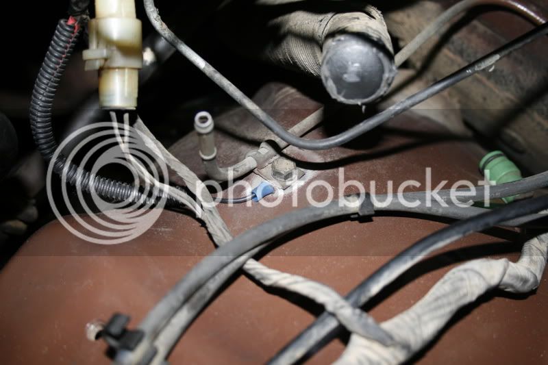

Grounded my EGR wire. It is connected to the PCV/EGR assembly that comes off the side of the intake manifold. It's also plugged up now. I know this isn't ideal as moisture and acidity can build up in the crankcase without proper ventilation, but we'll see how it works out.
I don't ave electricity in my garage right now (wiring in this house is SKETCHY!) so I had to run a LONG extension cord to finally get cutting on my blockoff plates. One is for the EGR/PCV hole and the other is for the EGR cooler hole. This is the best I could do with an angle grinder.
And both of the plates installed.

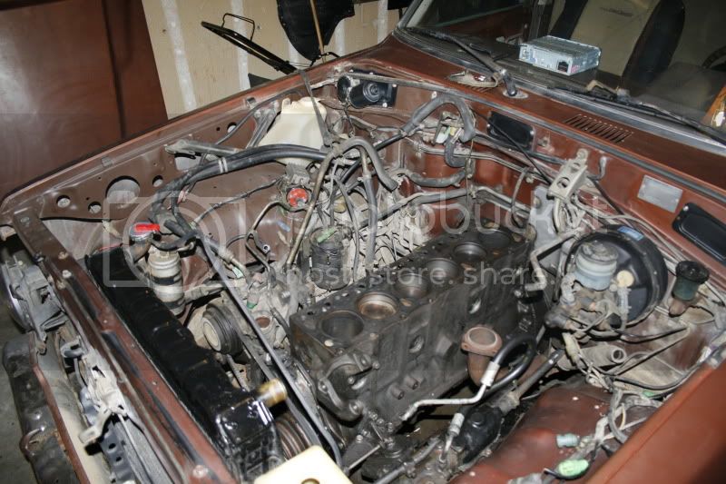

And here's where I am now. A lot further along but still a long way to go. Plumbing the carb for all of the newly desmogged items is not something I'm looking forward to. I'm still shooting for July 15th startup day... we'll see how that goes!
