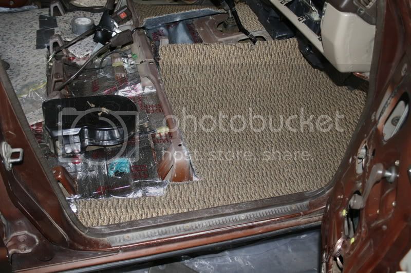

got any pics of that stuff on the roll ... whats on the back side ... is it a home depot deal ???
trucks lookin good BTW
It's All-Purpose Window Flashing. Comes in many different sizes and is self-adhesive and molds to all kinds of contours. Under the reflective side is a black rubber membrane, probably 2mm thick. Works great for the price!

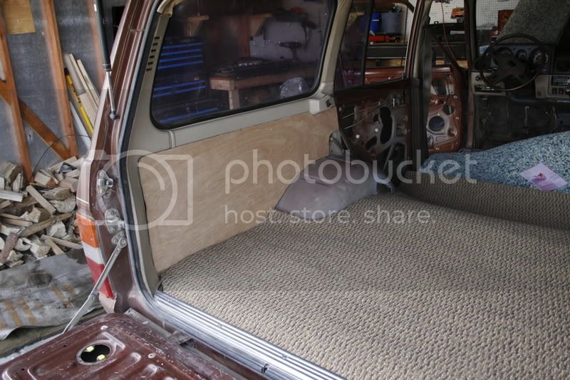

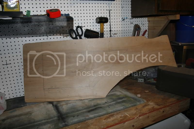

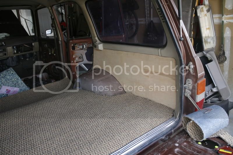

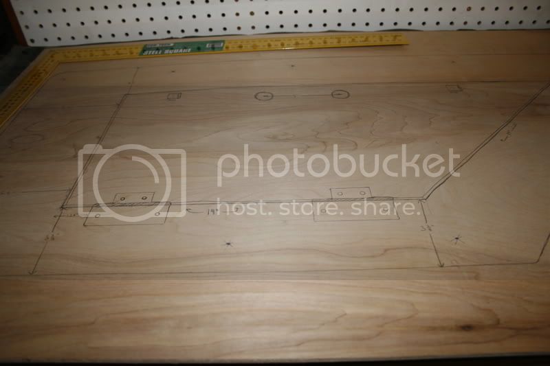

I got a few hours today to work on the rig. The rear interior panels had gotten wet (from the rusted out hole in the rear quarter panel) and were completely trashed. So I made some new ones out of 1/4" oak. I am going to cover them with something, or maybe just paint them, I don't know yet.
I am going to cut little doors out in them (already got the hinges and latches) so that I can store stuff behind the panels. There is actually a good amount of room behind them.

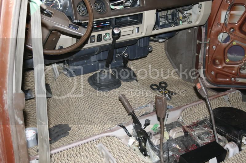

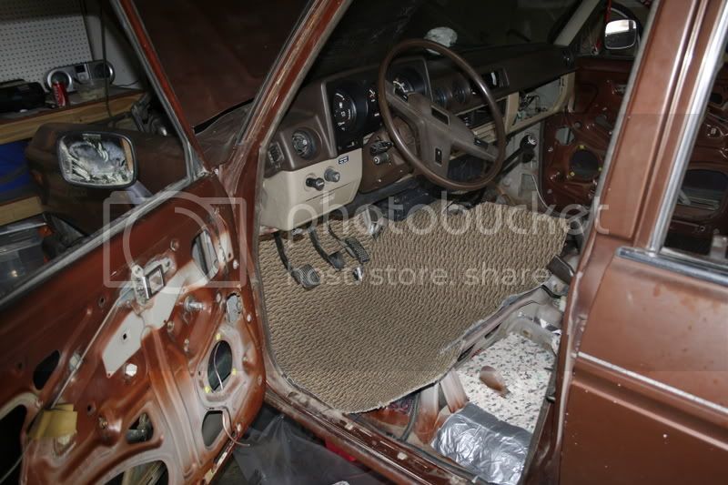

I also started laying some of the new carpet. I got this stuff for FREE because it was left over from where our IT office was recarpeting. So this stuff is brand new, and way stiff. I know office carpet was not meant for automobiles but I really didn't want to spend $700 on a new carpet kit.
It has different shades of tan and brown, which go perfectly with the rest of the truck.
Took some massaging to make it fit. My hands are wicked sore.
And with the panels in place...
I know I've got some work to do on the tranny tunnel. I ran out of carpet so I need to get another 6' section or so. It will be relatively seamless over the tranny tunnel. Especially when I get the center console and shifter boots back on it.

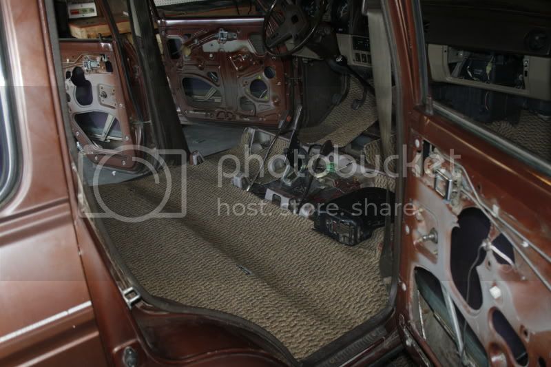

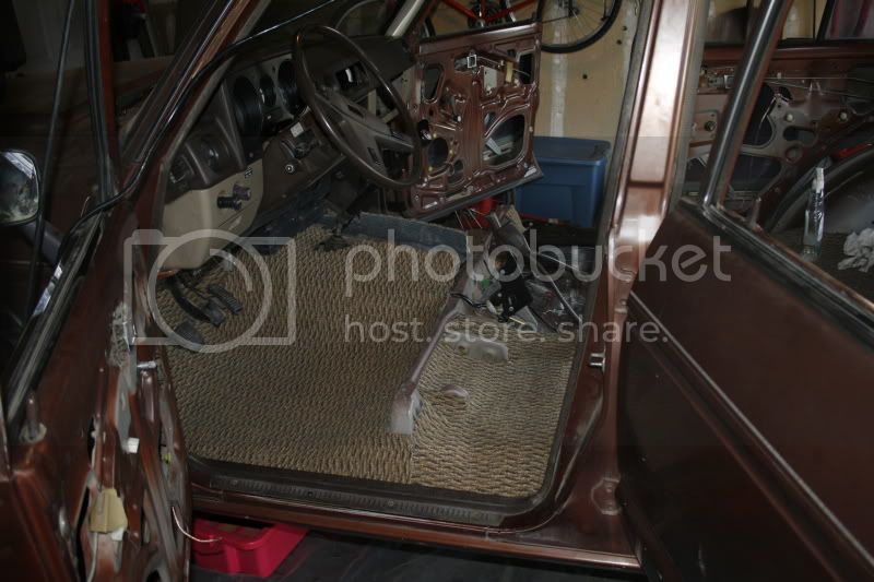

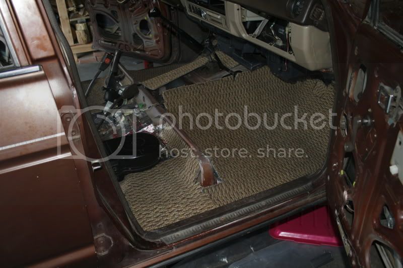

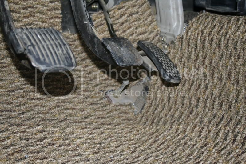

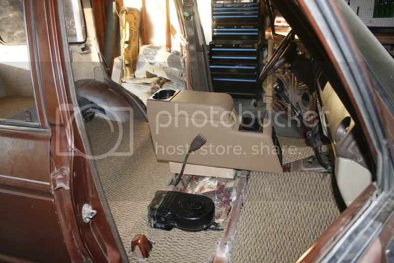

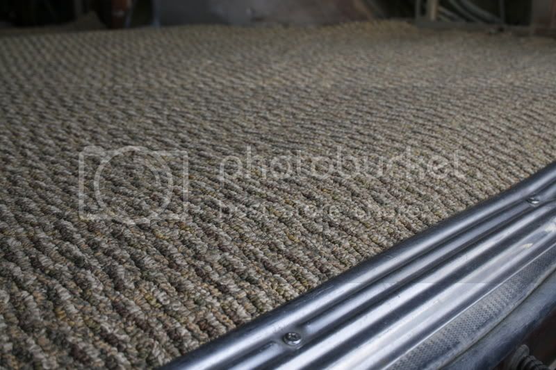

Anyway, I got a couple hours today to finish up the majority of the carpet. This stuff was never meant to go in an automobile but I think it came out surprisingly well, and it was a free upgrade. I used the heat gun to shape the rigid bottom around the contours. I just have to finish up the trans tunnel now.
I also got the center console mocked up and will start working on that next time. Its got 4 cup holders, a lock with 2 keys, a tray for sunglasses and it was only $60! I think it matches decently well.

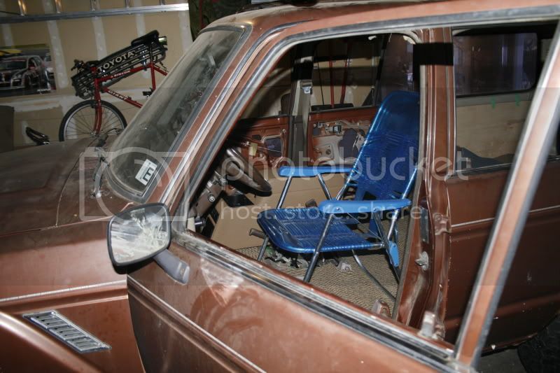

Maybe this will solve all my seat problems...
The lawn chair is pretty sweet, I must admit.

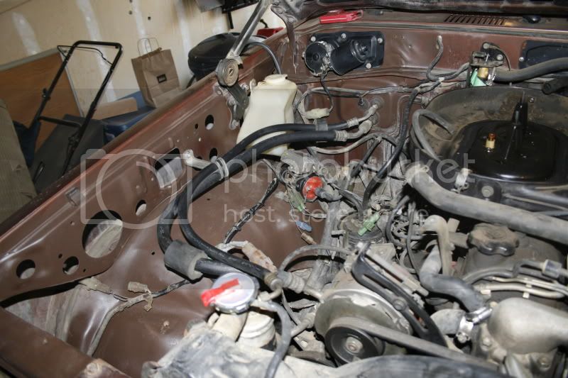

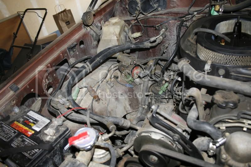

I needed a break from the interior, even though its almost done. I've started breaking the motor down. The plans are to adjust the valves, rebuild carb, general tuneup, fix power steering leak, new water pump, replace lots of seals, fix the oil galley plug and completely clean EVERYTHING.
Today I got a 1/3 of the engine bay done. Looks alot better than before.
Before:
After:
Wow
You too fast for me, however please drop by to help me: would cut a year or two off my build rate. Seriously good looking work and very speedy. Keep up the pic's we love it. :cheers:

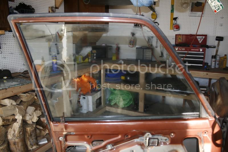

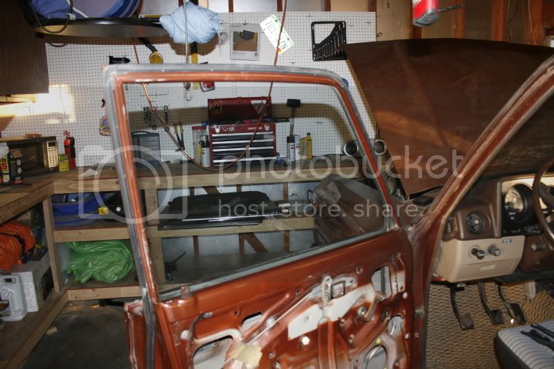

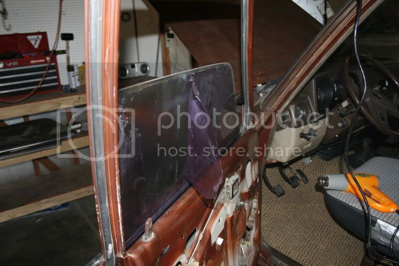

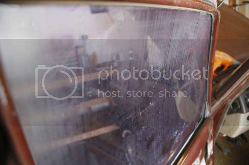

I spent a few hours tonight removing the crappy tint job. This was a real pain but it looks 100x better now with all that cheesy purple film from obstructing my view.
As you can see, I could barely see through this junk.

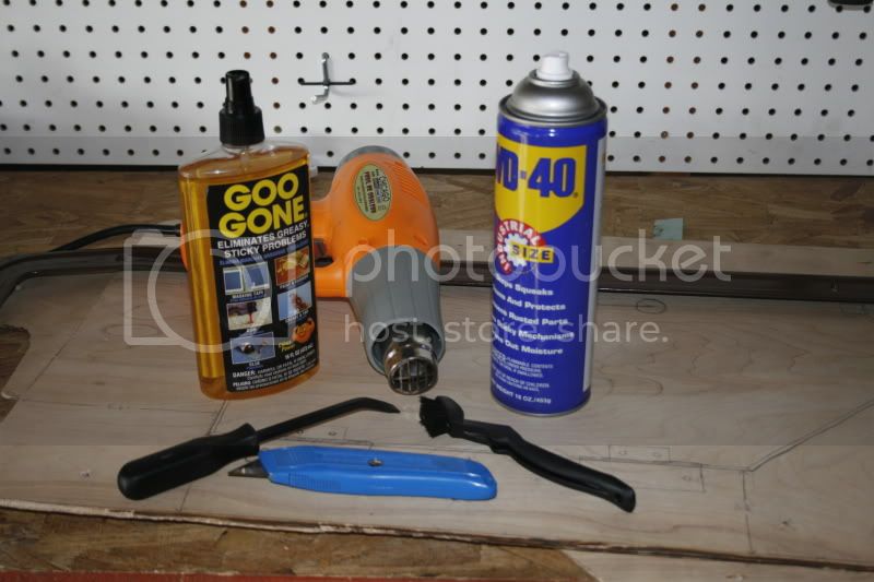

I used a heat gun to soften up this ancient film and adhesive. It worked fairly well. Then I sprayed some "Goo Gone" on it and let it set for 5 minutes or so. After that I shot it with some WD-40 over the Goo-Gone (which helped tremendously) and started scrubbing the adhesive with the nylon brush. The box cutter and prybar were just used for scraping and/or starting a new peeling edge.
How it started to peel up.
Goo-Gone and WD40 sprayed on and scrubbed down.
Crystal clear!

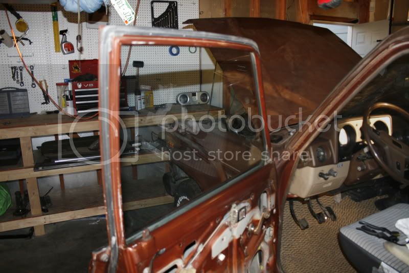

I got all of the 4 passenger windows done. I still have to do the tailgate and rear cargo areas. Takes about an hour a window so it's a little time intensive but no one likes bubbly, trashy, purple window tint!

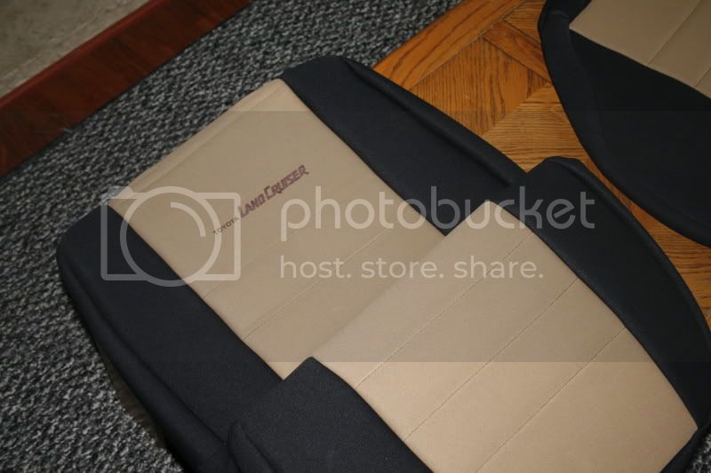

New bling. Front and rear Wet Okole covers with sewn in logo. I got a decent stock passenger seat and restuffed the drivers seat. They are both pretty comfortable and will be styling with the new covers. I'll probably install them this weekend.
